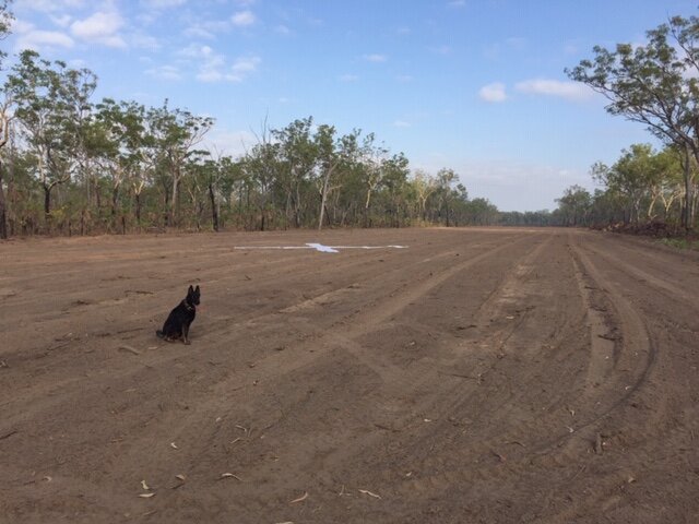

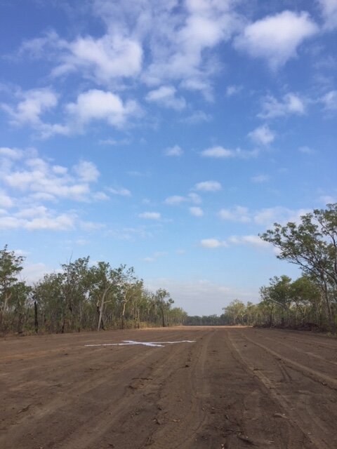

NT5224 Posted July 9, 2019 Author Share Posted July 9, 2019 looks inviting, just hope nobody tries to land there before it is safe, Well pointed out @Yenn! My wife and I are about to go overseas for two weeks leaving the as-yet-unfinished strip unserviceable. You'd have to be a complete idiot to attempt to land, because there are huge piles of earth and deep holes easily visible to even a cursory fly-over. But for additional peace of mind, I went out yesterday arvo and pegged down two big white crosses at touch down points at each end of the strip. Now you'd have to be a complete idiot and bloody-minded to attempt to land.... Alan 3 1 Link to comment Share on other sites More sharing options...

onetrack Posted October 6, 2019 Share Posted October 6, 2019 Is that the airport perimeter Alsatian guard dog on duty, ready to bite anyone who appears on the strip, without an ASIC card? Link to comment Share on other sites More sharing options...
NT5224 Posted October 6, 2019 Author Share Posted October 6, 2019 Is that the airport perimeter Alsatian guard dog on duty, ready to bite anyone who appears on the strip, without an ASIC card? Exactly. Airstrip security. Kangeroos without valid ASIC cards beware! 2 1 Link to comment Share on other sites More sharing options...

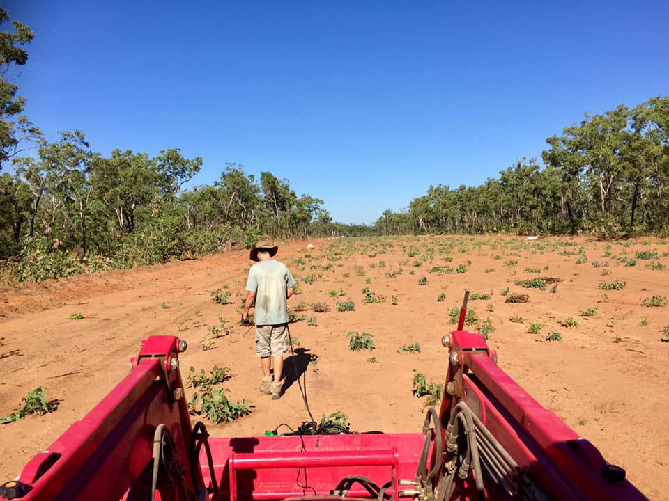

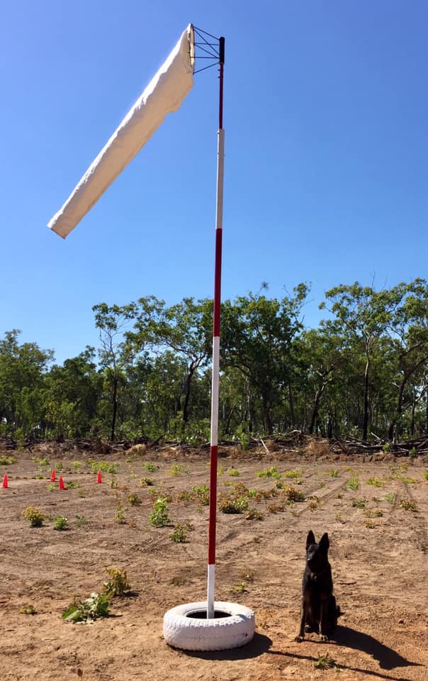

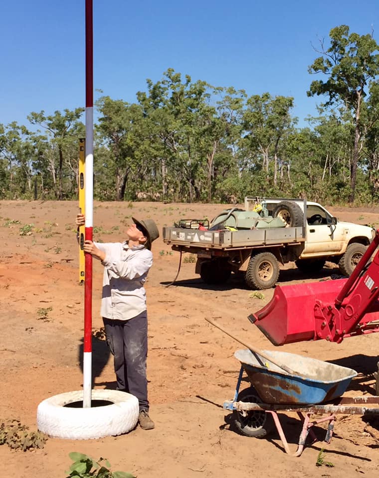

NT5224 Posted June 15, 2020 Author Share Posted June 15, 2020 Further progress on the airstrip. Has had final rolling and surface preparation. All good for landing. My wife and I spent a couple of hot weekends spot spraying to suppress little suckers which are starting to poke up. We'll switch to boom spraying when we've finished the first pass. Oh, and the windsocks up. I had a thread on here a few months ago asking about windsocks... Its all coming along nicely and Im expecting to land in the next couple of weeks 3 Link to comment Share on other sites More sharing options...
facthunter Posted June 15, 2020 Share Posted June 15, 2020 Great effort. I'd stick to spot spraying for a while. If you spray the lot you'll still have to come back for the more persistent ones, and you'll eventually get resistance.. Glyphosate is NOT harmless. Nev Link to comment Share on other sites More sharing options...
NT5224 Posted June 15, 2020 Author Share Posted June 15, 2020 (edited) Great effort. I'd stick to spot spraying for a while. If you spray the lot you'll still have to come back for the more persistent ones, and you'll eventually get resistance.. Glyphosate is NOT harmless. Nev Thanks Nev. Actually its Triclopyr for the suckers, not Glysophate. We're trying to get the roots and plants below ground or they'll just keep throwing up new suckers. Main reason I don't boom spray is its just too expensive with Triclopyr! But Im also a closet greenie and dont want to harm the environment and my woodlands more than i need to. But spot spraying is hard going. Its five hectares and each hectare takes 2-3 hours, two people. Hot sun too. As well as my aversion to broad scale use of herbicides, we want grasses and forbs to grow back to help bind the surface, so selective spraying is the best (although very labour intensive!) way to go. Triclopyr is selective for broad leafs. Alan Edited June 15, 2020 by NT5224 3 Link to comment Share on other sites More sharing options...

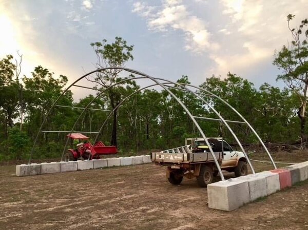

NT5224 Posted November 14, 2020 Author Share Posted November 14, 2020 Just a little update on this. As I mentioned a while back in a discussion about hangars, we are throwing up an arched shade structure for ours. In addition to the basic fabric roof cover we will put up a steel rear wall and a lockable gate on the front. In case anybody’s wondering, putting up one of these with just two people and a dog beyond the black stump and in blistering temperatures is a bit of a struggle. Next project will be a little avgas depot with hand pump. Alan 6 Link to comment Share on other sites More sharing options...
Blueadventures Posted November 14, 2020 Share Posted November 14, 2020 Looks nice. Re pump I made up a 12 volt one using the red 'AreoFlow' 97 GPH pump works a treat off either the aircraft battery or my hangar spare on a trolley. Cheers Link to comment Share on other sites More sharing options...
Old Koreelah Posted November 14, 2020 Share Posted November 14, 2020 2 hours ago, NT5224 said: As I mentioned a while back in a discussion about hangars, we are throwing up an arched shade structure for ours. Alan Alan you have some serious hold-downs there! Link to comment Share on other sites More sharing options...
