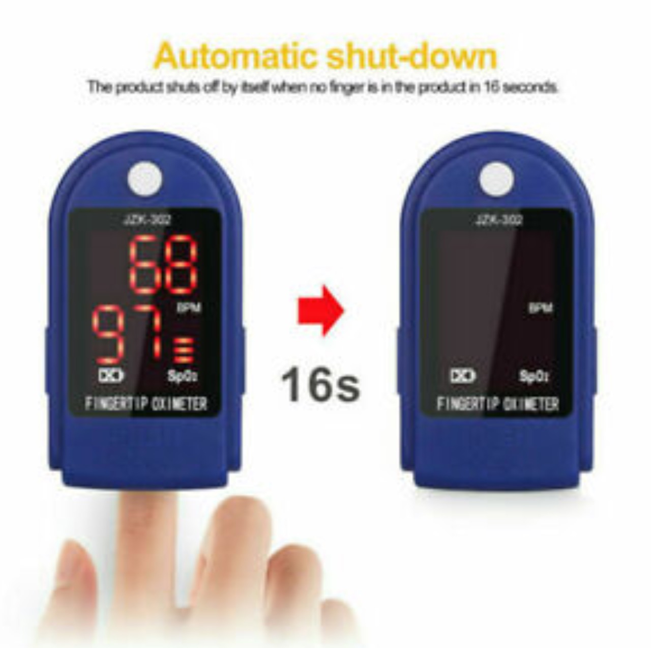

Flightrite Posted July 18, 2020 Share Posted July 18, 2020 I think Nev has the right idea. Audible alarm and a flashing light. Shouldn't be too hard for an electronics whiz to build one, should it? My machine is fitted with an audible alarm and red light warning C0 detector, best thing ever!? Also I keep in the cockpit an O2 concentration and pulse rate finger monitor. I use it on longer flights. Surprised at how one's O2 drops at 10K ft. 1 2 Link to comment Share on other sites More sharing options...

Flightrite Posted July 19, 2020 Share Posted July 19, 2020 I highly recommend getting one like this, $25 bucks. 1 1 Link to comment Share on other sites More sharing options...
