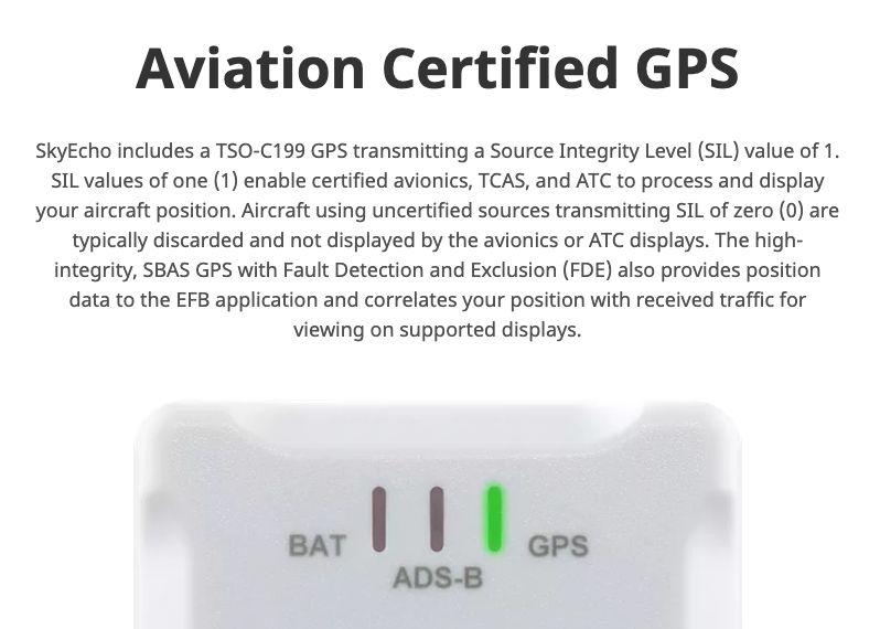

jackc Posted January 31, 2022 Share Posted January 31, 2022 Well, the Skyecho2 broadcasts its position, other aircraft receive it although I don’t think airspeed and altitude is sent, correct me if I am wrong. I phoned our local ATC and they did not know what an ECD was 🙂. I mentioned Skyecho and still drew a blank!! Link to comment Share on other sites More sharing options...
Roundsounds Posted January 31, 2022 Share Posted January 31, 2022 2 minutes ago, jackc said: Well, the Skyecho2 broadcasts its position, other aircraft receive it although I don’t think airspeed and altitude is sent, correct me if I am wrong. I phoned our local ATC and they did not know what an ECD was 🙂. I mentioned Skyecho and still drew a blank!! ATC can only “see” certified ADSB equipment output. Sky echo etc are simply toys from the regulators perspective. 1 Link to comment Share on other sites More sharing options...
jackc Posted January 31, 2022 Share Posted January 31, 2022 Well, the ‘regulators’ better pull their head out of their……… and realise anything that can help with safety is a bonus. CASA needs to get with the program 🙂 and include ECDs into part of the ATC alerting system. Link to comment Share on other sites More sharing options...
Garfly Posted January 31, 2022 Author Share Posted January 31, 2022 (edited) 2 hours ago, Roundsounds said: ATC can only “see” certified ADSB equipment output. Sky echo etc are simply toys from the regulators perspective. 1 hour ago, jackc said: Well, the ‘regulators’ better pull their head out of their……… and realise anything that can help with safety is a bonus. CASA needs to get with the program 🙂 and include ECDs into part of the ATC alerting system. What the 'regulators' actually say: CASA advisory-circular-91-23 2.1.7 ..... Logically, ADS-B OUT is the ideal way for VFR aircraft to signal their presence directly to other aircraft. In effect, ADS-B turns the ‘see and avoid’ concept into ‘see, BE SEEN, and avoid.’ 2.1.8 The technical standards for ADS-B OUT now include a range of equipment options primarily aimed at VFR aircraft. These include transponder-based systems and self-contained systems called Electronic Conspicuity (EC) devices and integrated Traffic Awareness Beacon System (TABS). 2.1.9 The standards also allow technically capable, but non-TSO4 ADS-B OUT equipment to be installed in a range of sport aviation, experimental and certain other aircraft. 2.1.10 In summary, we want to improve the ability of airspace users to see you. https://www.casa.gov.au/sites/default/files/2021-08/advisory-circular-91-23-ads-b-enhancing-situational-awareness.pdf 29/09/2021 VFR and visible | Flight Safety Australia Can ATC ‘see’ my SkyEcho2? The prime objective of SkyEcho2 is air-to-air traffic awareness – the device is not certified to the performance standards needed for ATC separation services. Nevertheless, CASA envisages the device being used for situational awareness by ATC. By early this year, the Airservices Australia ATC system had not been modified to display SkyEcho2; however, it is expected that with a new ATC system on the way, SkyEcho2 transmissions will be displayed to controllers, for situational awareness only, using distinctive symbology which will prevent the application of surveillance separation standards to those aircraft. uAvionix website: CLICK IMAGE FOR FULL REZ: Edited January 31, 2022 by Garfly 1 Link to comment Share on other sites More sharing options...
Garfly Posted January 31, 2022 Author Share Posted January 31, 2022 2 hours ago, jackc said: Well, the Skyecho2 broadcasts its position, other aircraft receive it although I don’t think airspeed and altitude is sent, correct me if I am wrong. Jack, the SE2 transmits (pressure) altitude data from its built-in barometric altimeter. Most ADSB-IN devices display the target level in hundreds of feet above or below (and if climbing or descending). Meanwhile, the GPS sends out ground-speed info. 1 Link to comment Share on other sites More sharing options...
RFguy Posted January 31, 2022 Share Posted January 31, 2022 ATC can see my Skyecho. They call me direct on centre by my aircraft registration if there is a potential conflict . 2 Link to comment Share on other sites More sharing options...
