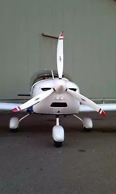

RossK Posted July 6, 2022 Share Posted July 6, 2022 Agree with Nev, you don't have to reinvent the wheel. Pic is the front view of a Sportstar with the 912ULS. Top openings - air cooling for the cylinders middle - radiator lower - oil cooler. None are that large and we've never had cooling issues. Link to comment Share on other sites More sharing options...

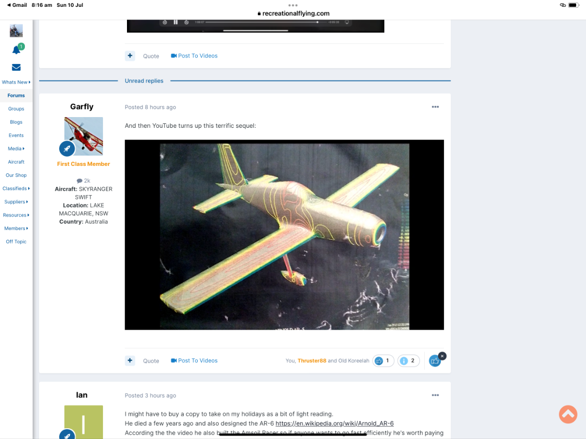

Garfly Posted July 10, 2022 Share Posted July 10, 2022 And then YouTube turns up this terrific sequel: 1 2 Link to comment Share on other sites More sharing options...

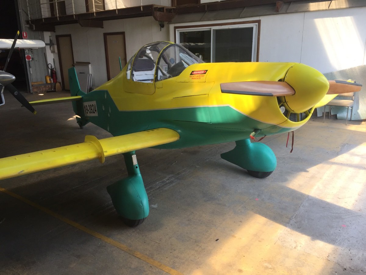

Ian Posted July 10, 2022 Share Posted July 10, 2022 I might have to buy a copy to take on my holidays as a bit of light reading. He died a few years ago and also designed the AR-6 https://en.wikipedia.org/wiki/Arnold_AR-6 According the the video he also built the Amsoil Racer so if anyone wants to go fast efficiently he's worth paying attention to. 1 Link to comment Share on other sites More sharing options...
Old Koreelah Posted July 10, 2022 Share Posted July 10, 2022 Sad to see Mike Arnold passed away. He sure influenced a lot of builders. Reading about how fast he went with 50hp must have made an impression: after several phases of modifying my Jodel Babe it started looking a little like his amazing AR-5…if you squint your eyes and ignore the ruff-as-gutz finish. 2 1 Link to comment Share on other sites More sharing options...

Ian Posted July 10, 2022 Share Posted July 10, 2022 9 hours ago, Old Koreelah said: after several phases of modifying my Jodel Babe it started looking a little like his amazing AR-5 After watching his video on wheel pants I'm noting the flush sides on your wheel pants and the design of the engine cooling 1 Link to comment Share on other sites More sharing options...
