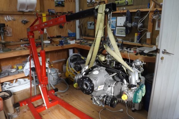

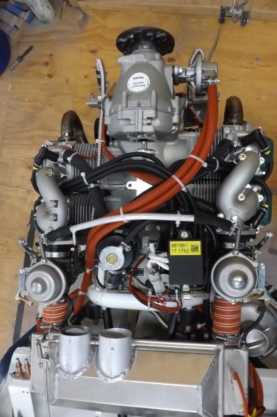

IBob Posted July 8, 2022 Share Posted July 8, 2022 (edited) There are a couple of threaded holes in the top of the engine, approx 150mm back from the gearbox. A fellow builder lent me bolts with the bracket he made to go on there. The lift here is on that bracket on the shackles you can see. The strop is on there just in case, and under no load. You can see one of the holes in the second pic. Edited July 8, 2022 by IBob 4 1 Link to comment Share on other sites More sharing options...

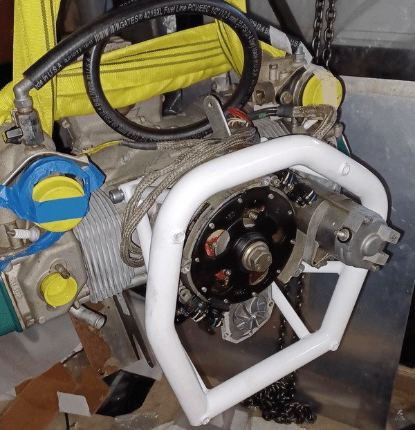

RFguy Posted July 9, 2022 Author Share Posted July 9, 2022 (edited) Thanks Bob. I will do that, that's an easy one. and thanks everyone for their input. Engine is now hung, currently front and rear. I have a ring mount, seems there are many variations of ring mounts... mine isnt 'original rotax' but something else, but well made. So what's the story with getting the lower left (from the rear) around the water bits at the bottom. ? I have read that juggling is required, and it depends on how the mount was welded up- is adjusting/removing the water outlets required in some cases, or should I persist ? glen Edited July 9, 2022 by RFguy Link to comment Share on other sites More sharing options...
IBob Posted July 9, 2022 Share Posted July 9, 2022 (edited) Hi Glen, I can only speak from the experience of my own build: 1. The engine was much easier to fit to the ringmount supplied, by first removing the coolant pump cover with it's coolant outlets. 2. After fitting the engine to the mount, the pump cover was easily refitted, but the position of two of the coolant outlets had to be adjusted to allow the hoses to pass through the ringmount. 3. This was done by holding the cover gently in vice softjaws, gently heating the required outlet and rotating it by pushing on a piece of dowel inserted in the outlet. I made these adjustments several times before getting them right, and was concerned that I may have leakage as a result, but there has been no problem. The pump outlets are a soft alloy with a fine thread secured with Loctite 243, which requires a moderate amount of heat. (The coolant inlets at the cylinder heads are a similar fitting with the same fine thread, but a higher temperature Loctite is used there, requiring considerable heat for removal. I have replaced one cylinder head port, it was a difficult job which took me three attempts to achieve a leak-proof installation.) Edited July 9, 2022 by IBob 1 Link to comment Share on other sites More sharing options...

RFguy Posted July 9, 2022 Author Share Posted July 9, 2022 (edited) Will need the oxy on the mount struts . pump gasket is just a pain because need to clean the flanges. lower mount holes are not in perfect alignment. However they DID get the width perfect, slightly interference fit on width on top and bottom. anyway, something to look at carefully in the week with lots of light. Edited July 9, 2022 by RFguy Link to comment Share on other sites More sharing options...
onetrack Posted July 10, 2022 Share Posted July 10, 2022 Just remember - the engine doesn't know, if the mounting holes are out of alignment! When I find things like that, I start to wonder about what else that hole-driller installed to perfection! Link to comment Share on other sites More sharing options...
RFguy Posted July 10, 2022 Author Share Posted July 10, 2022 the engine is drilled/milled correctly. the mount is not. *groan*. nothing an oxy cant fix. will need some deformation of the support struts of that corner. not much. needless to say, I'll be keeping an eye out for mount cracks. next thing 17mm ID hose.... Link to comment Share on other sites More sharing options...

facthunter Posted July 11, 2022 Share Posted July 11, 2022 White is a great surface for fabricated engine mounts for sighting cracks best.. Don't have the paint very thick. I've used a thin coat of white etch satisfactorily. Nev 2 Link to comment Share on other sites More sharing options...
