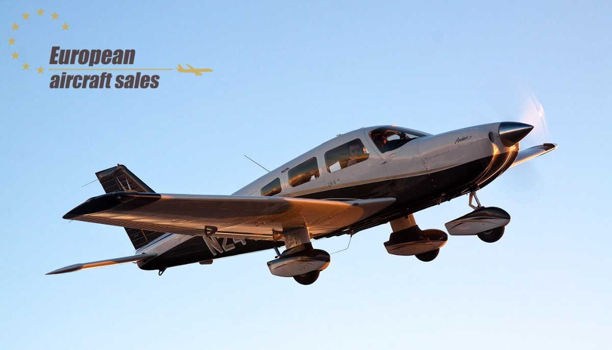

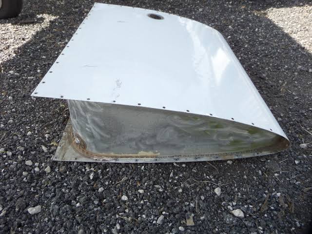

Thruster88 Posted July 22, 2022 Share Posted July 22, 2022 The PA-28 has the best fuel tanks for electric conversion of an existing airframe. Replacement of the Lycoming O-360 with a lighter electric motor and limiting it to two pilots or 200kg in the in cabin should allow about 300kg of batteries. Enough for 60 mins of flight? 1 2 Link to comment Share on other sites More sharing options...

RFguy Posted July 23, 2022 Share Posted July 23, 2022 best Lithium Graphite anode specific gravity is about 3..... so quite dense. really needs designed from the ground up, and distributed carefully. volumetrically - you'd probably 1/4 fill a fuel cell with batteries . they take the place nicely of metal in the front. 1 Link to comment Share on other sites More sharing options...
