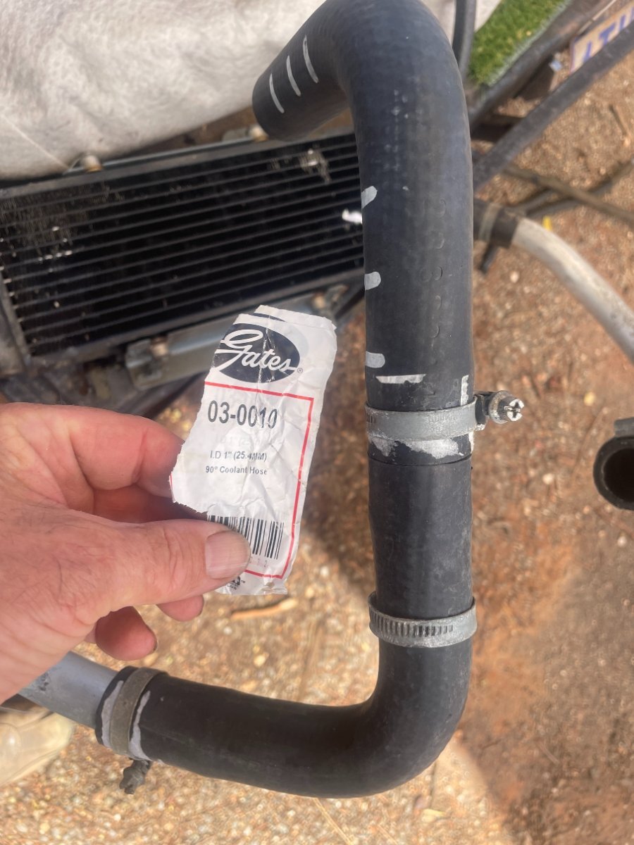

1 hour ago, skippydiesel said:
Did you purchase other 17mmID Gates coolant hoses or just the 02-1562 & 02-1415?😈
Yes Skippy, I'm pretty sure I bought a couple of 90° hoses but I can't find the invoice.
I bought four of these 25mm hoses as well. If Sandra finds the invoice I'll post the list but anything not marked for the plane has just gone into a file of assorted invoices never to be seen again.
