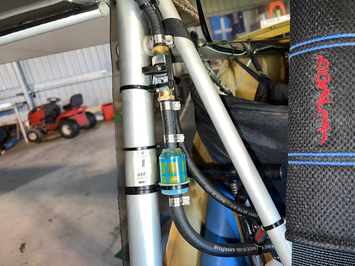

Blueadventures Posted July 24, 2023 Posted July 24, 2023 (edited) 3 hours ago, Marty_d said: Has anyone had luck sourcing fuel on/off valves? Inline that is, just for a safety "off" in the cabin in case of fire etc. I use these 3/8" BSP female ends. Placed between tank and fuel filter. No issues. Edited July 24, 2023 by Blueadventures 2

Marty_d Posted July 24, 2023 Posted July 24, 2023 1 hour ago, Blueadventures said: I use these 3/8" BSP female ends. Placed between tank and fuel filter. No issues. That looks like the go. Many are 6 or 8mm but the line at that point is 3/8 (9.5) - that one would allow those barbs.
