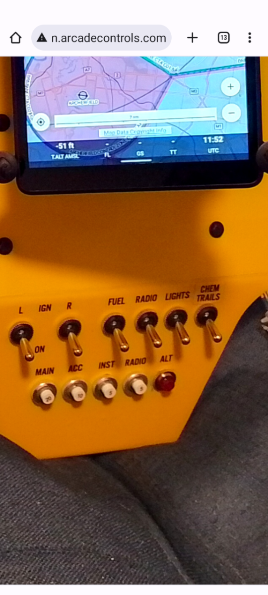

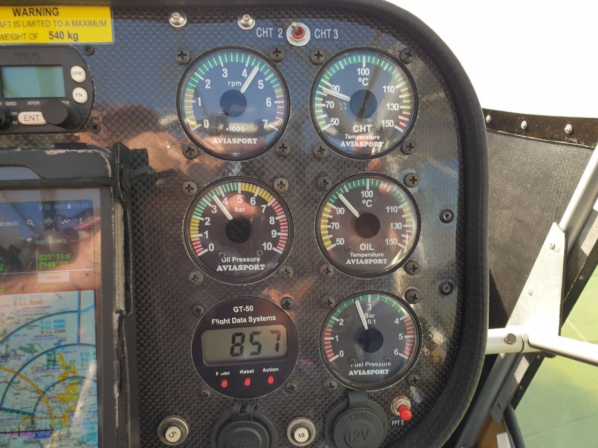

On my ULS engine oil temp is always higher than the CHT temp. usually about 8 degrees C.  I also have a two position toggle for CHT feed from #2 and #3 heads and these read differing temps (one gauge and I can select temp source).
That's a neat idea! I have one spare switch on my instrument panel, maybe that's what it'll be for 😎
Of course it's designated differently right now 😁Screenshot_20231007-150047.thumb.png.f74bdd6db936517c07e81f4c9bde34cc.png
I have the later model ULS with the CH coolant temp readouts for cylinders 2 and 3.
2 always reads cooler than 3.
But given that 2 is front LH, with the sensor at the front of the head, while 3 is rear RH, with the sensor at the rear of the head, that has never surprised me, and since they are both well below max temp, it has never bothered me.
