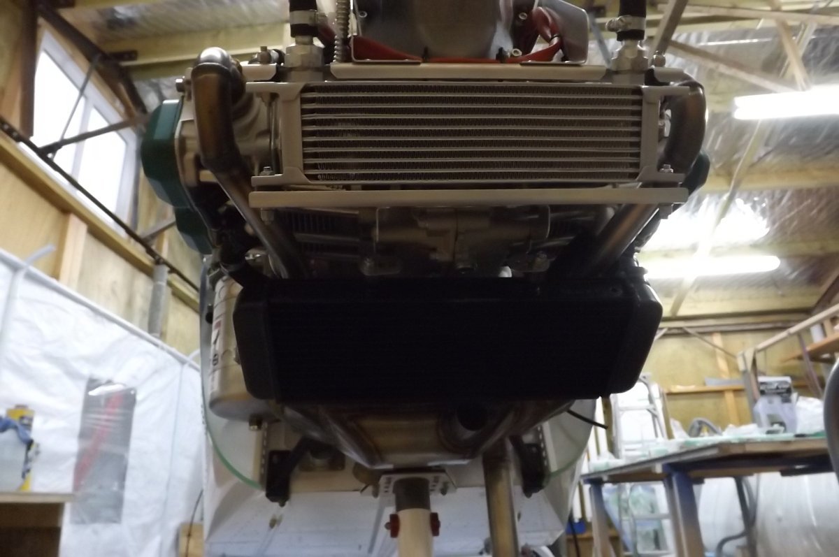

IBob Posted June 20, 2023 Share Posted June 20, 2023 It'll be interesting to see where you arrive at with both resizing and repositioning of the cooler, Skippy. The Savannah has the cooler at the pointy end with it's own air intake and a pronounced lip under the rear cowl to reduce exit air pressure. I can't tell you the size of the cooler (I can measure it when next at the hangar, if you wish), and obviously we don't have your elevated temperatures here in Nuzeelun. But in winter I'm flying with about 2/3 of the cooler blanked off, in summer 1/3, and it still takes a sustained climb to hit the recommended 100'C mark. 1 Link to comment Share on other sites More sharing options...
skippydiesel Posted June 20, 2023 Author Share Posted June 20, 2023 59 minutes ago, IBob said: It'll be interesting to see where you arrive at with both resizing and repositioning of the cooler, Skippy. The Savannah has the cooler at the pointy end with it's own air intake and a pronounced lip under the rear cowl to reduce exit air pressure. I can't tell you the size of the cooler (I can measure it when next at the hangar, if you wish), and obviously we don't have your elevated temperatures here in Nuzeelun. But in winter I'm flying with about 2/3 of the cooler blanked off, in summer 1/3, and it still takes a sustained climb to hit the recommended 100'C mark. Veeeery neat! I am impressed. Intersted to see a relatively wide (to height) oil cooler - did you read the earlier advise suggesting short cross tubes for reduced flow resistance? - comment! I will be intersted to get the part/model number and or dimensions. It will be at least a month or two, for all the changes to be completed - the modifications to the cowling, to accommodate the new heat exchanger locators, are likely to be the most demanding (for me). One of the (many) oil temperature "fixes" I tried was to install a pilot operated electric cowl flap - will keep this feature, at least until I know that both high & low temperatures are satisfactory. Link to comment Share on other sites More sharing options...
IBob Posted June 20, 2023 Share Posted June 20, 2023 Skippy, I'll take some measurements when next in. I cannot take any credit for the choice or the installation: I just followed the instructions and equipment that came with the kit (which included both the coolers) plus the excellent build pics supplied by the Oz agent at the time, Reg Brost. Points of difference between my aircraft and yours would have to include that my fixed pitch prop is set up for the usual compromise between takeoff and cruise. I typically cruise at 5000RPM and 85kts. And while the Savannah will go quicker, as a draggy aircraft with a fat wing, it doesn't really want to. All of which is to say that your engine is almost certainly working much harder than mine in cruise and so producing more heat. 1 Link to comment Share on other sites More sharing options...

Blueadventures Posted June 20, 2023 Share Posted June 20, 2023 Also consider mounting a second oil cooler in front of the coolant radiator. Some installation run a R912ULS with such a setup with success. Link to comment Share on other sites More sharing options...
skippydiesel Posted June 20, 2023 Author Share Posted June 20, 2023 42 minutes ago, Blueadventures said: Also consider mounting a second oil cooler in front of the coolant radiator. Some installation run a R912ULS with such a setup with success. Thanks! Will consider pretty much all suggestions however my policy (made to be broken) is to take small incremental (hopefully minimal cost) steps - a second oil cooler adds complexity & weight, so will be way down the list of potential fixes Link to comment Share on other sites More sharing options...

skippydiesel Posted June 21, 2023 Author Share Posted June 21, 2023 26 minutes ago, danny_galaga said: One other thing to consider is airflow direction is not always as straight forward as you might think. Is it worth experimenting with the angle the cooler is facing in regards to airflow? For instance, pointing it downward a few degrees more than it is. An example of how surprising air flow directions can be- when they put a model of a Junkers JU 52 in a modern wind tunnel, apparently almost NONE of the corrugations were in line with actual airflow! Of course the plane didn't know that, and so it flew 😄 200% agree!!! Air flow/cooling is , for those without a wind tunnel and all sorts of sensors, a dark art. 2 Link to comment Share on other sites More sharing options...
BrendAn Posted June 21, 2023 Share Posted June 21, 2023 3 hours ago, skippydiesel said: It sees to me that almost all Sonex / Rotax 912 ULS have / had cooling issues to start with - even the fairly recent factory one. Your friend may be particularly gifted/lucky in this area or has learnt from earlier builds and has designed his cooling system accordingly. Most of the successful (eventually) ones are using a side mounted Radiator with large NACA inlet and side outlet (pretty ugly in my eyes). My Sonex is a little unusual in that it has a; Firewall/bottom Radiator that is sealed ie is dependent on cowling air flow - it actually works, but only once airborne. This is about to be changed. Constant speed prop (CS) - most aircraft will be flying with a fixed pitch which is likely to unloaded the engine when in cruise while mine maintains/increases the load. the mates has a fixed prop. 1 Link to comment Share on other sites More sharing options...
