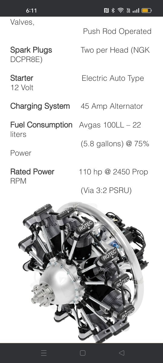

BrendAn Posted September 2, 2023 Share Posted September 2, 2023 (edited) On 01/09/2023 at 9:23 AM, facthunter said: I would think so.. The Continental 0-200 was a very reliable motor, and a near new one still can be, THIS motor has a few better features. No good little radials yet? They are the best to supercharge. Nev Aussie made. Reputation seems to be improving. Edited September 2, 2023 by BrendAn Link to comment Share on other sites More sharing options...

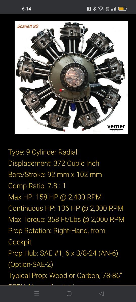

BrendAn Posted September 2, 2023 Share Posted September 2, 2023 On 01/09/2023 at 9:23 AM, facthunter said: I would think so.. The Continental 0-200 was a very reliable motor, and a near new one still can be, THIS motor has a few better features. No good little radials yet? They are the best to supercharge. Nev Don't forget the Verner either Link to comment Share on other sites More sharing options...

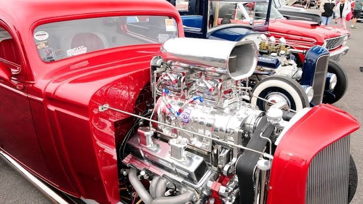

danny_galaga Posted September 2, 2023 Author Share Posted September 2, 2023 On 01/09/2023 at 12:05 PM, facthunter said: They usually need two.. A radial will easily have equal length and short intakes and a dead easy drive from the accessories drive case at the back. Nev Youve not looked too closely at a hot rod then. V seems nearly ideal for supercharging Link to comment Share on other sites More sharing options...

skippydiesel Posted September 2, 2023 Share Posted September 2, 2023 12 hours ago, danny_galaga said: Youve not looked too closely at a hot rod then. V seems nearly ideal for supercharging If they cant keep it within the engine bay of a car, what jhope for an aircraft🙃 2 Link to comment Share on other sites More sharing options...

danny_galaga Posted September 3, 2023 Author Share Posted September 3, 2023 2 hours ago, skippydiesel said: If they cant keep it within the engine bay of a car, what jhope for an aircraft🙃 I picked something deliberately lairy to make a point 😁 There are plenty of regular cars with mechanical superchargers nicely confined in the engine bay. Look at the Mercedes Kompressor range. 1 1 Link to comment Share on other sites More sharing options...

facthunter Posted September 3, 2023 Share Posted September 3, 2023 They've had a few issues over the Years The later reduction gears are case hardened which is better than Nitriding. I think you might be able to do without the reduction gears on lighter models. It's got a great period look and sound. Part of the reason it was produced. Let's hope it can be sorted. Nev Link to comment Share on other sites More sharing options...
onetrack Posted September 3, 2023 Share Posted September 3, 2023 The Verner radials are a clever piece of work, simply utilising Honda generator heads and VW cylinders and pistons. Repairs are much cheaper, thanks to the widespread availability of bits. Of course, you're never going to have a streamlined racer with a radial, but the exhaust note and the great vintage looks must count for something! https://opposite-lock.com/topic/28513/verner-radial-engines-the-art-of-sourcing-existing-things-to-make-new-things 1 Link to comment Share on other sites More sharing options...
