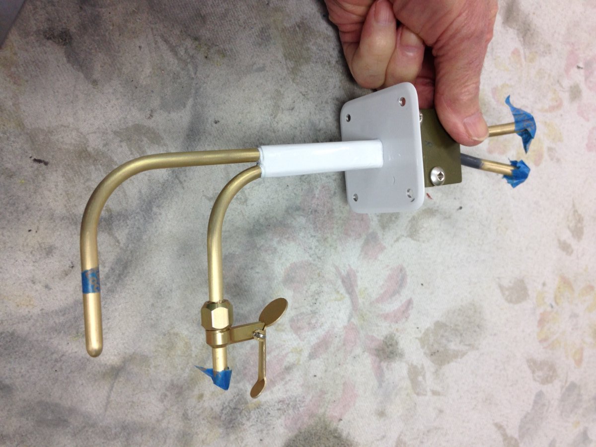

skippydiesel Posted August 10, 2023 Share Posted August 10, 2023 If you don't need anything fancy, like a heated unit - make your own! The photo shows pitot & static. The static should have been nice and tight to the pitot - but sometimes art/aesthetics gets the better of the project (has increased vulnerability though). They are both the same tube diameter (easy bend). The static tip is blocked and 2 small, 1mm holes are drilled through, to give 4 holes. Having the static out on/below the wing removes any concerns about picking a bad spot on the fuselage. The auto pitot "lide" is a bit fancy - it works that the main thing - I still cover the exposed pipe tips, in a purpose made bag, with draw string & "Remove Before Flight) tag. The "shaft" is just fiberglass wrapped around the two pipes. Tubing inside wing is yellow "Tygon" but you could use any long life(don't want it going hard & cracking) push on - I secured with spring hose clamps (not easy to find these days). Hose diameter is immaterial as both pitot & static are registering pressure not volume. Don't have a photo at the moment but have since added a 45 degree pipe for angle of attack/reserve lift. 2 1 Link to comment Share on other sites More sharing options...
