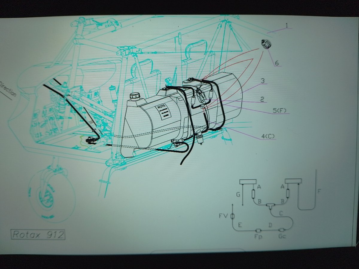

danny_galaga Posted March 3 Author Share Posted March 3 This is how it's hooked up Link to comment Share on other sites More sharing options...
Blueadventures Posted March 3 Share Posted March 3 8 minutes ago, danny_galaga said: This is how it's hooked up Maybe wrong but looks like fuel feed hoses exit out of top of tank through inline filters into a "T' then to Gascolator and then to the electric fuel pump and onto engine. And maybe the tank vents from top of tank and exit lower fuselage. Is that how yours is hooked up. Link to comment Share on other sites More sharing options...
danny_galaga Posted March 3 Author Share Posted March 3 Yes, pretty I hooked it up the same way. But who knows, it was years ago now 😄 The engine is running fine. This is all leading me to the conclusion there is something wrong with the gascolator. I wouldn't be surprised, just another kick in the head with this 'friday job' kit... Link to comment Share on other sites More sharing options...

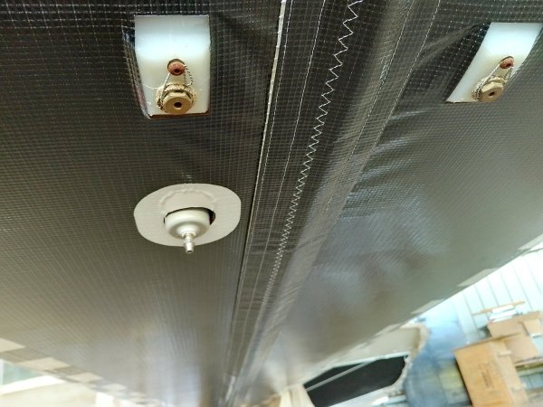

skippydiesel Posted March 9 Share Posted March 9 (edited) 22 minutes ago, Blueadventures said: You can buy flush mounted drain valves. I am very intersted Blue - Is this what you are referring to? What experince do you have? Are there others, suitable for aircraft? Edited March 9 by skippydiesel Link to comment Share on other sites More sharing options...
danny_galaga Posted March 9 Author Share Posted March 9 (edited) 10 minutes ago, skippydiesel said: I am very intersted Blue - Is this what you are referring to? What experince do you have? Are there others, suitable for aircraft? See my post above, I guess I have these flush mounted drains https://www.aircraftspruce.com/catalog/appages/curtisflushmounted_05-04888.php 😄 Edited March 9 by danny_galaga Link to comment Share on other sites More sharing options...

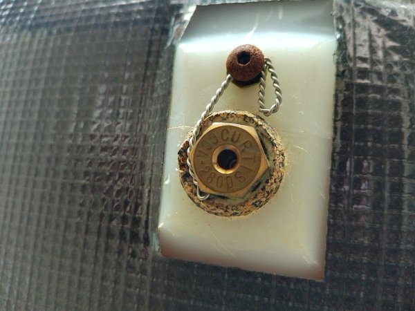

Blueadventures Posted March 9 Share Posted March 9 (edited) 12 minutes ago, danny_galaga said: See my post above, I guess I have these flush mounted drains 😄 Are good and flush. I use the curtis one that have the external push arrangement. They are brass so better operationally in my opinion. I have found some other brand cad plated valves that get seized due to corrosion of the steel components. (you can see corrosion on the hex fastening next to the brass body drain valve as an example of corrosion / time in service etc. Is that your Danny? (Edit, just read your post after posting my reply, Cheers) They require the glass cup with the pin in the centre or the drain tubes have a pin you can insert into the end to open the drain valve. Edited March 10 by Blueadventures 1 Link to comment Share on other sites More sharing options...
danny_galaga Posted March 9 Author Share Posted March 9 (edited) Yeah, I did try to stick a fuel drain in the bung last week thinking "surely that hole means something". But I borrowed someone's fuel drain, with a plastic pin. It's so old it was just bending. But it worked in the gascolator. But now I have a new fuel tester so just for shits and giggles tried it. Waddaya know 🙂 I feel bad for bending the other guys fuel drain so I bought him a new one too. Edited March 10 by danny_galaga Link to comment Share on other sites More sharing options...
