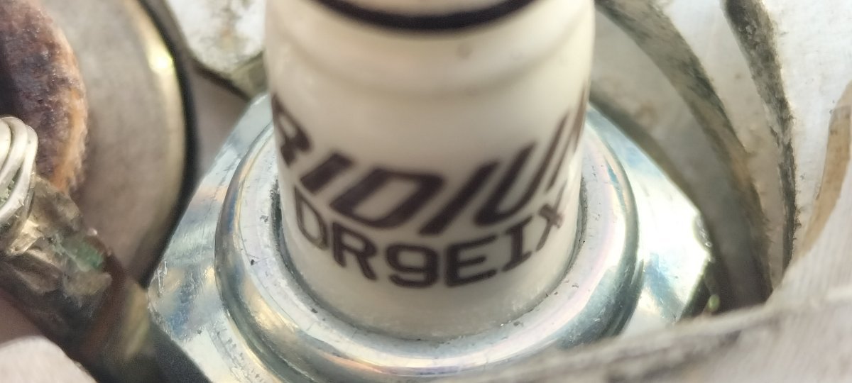

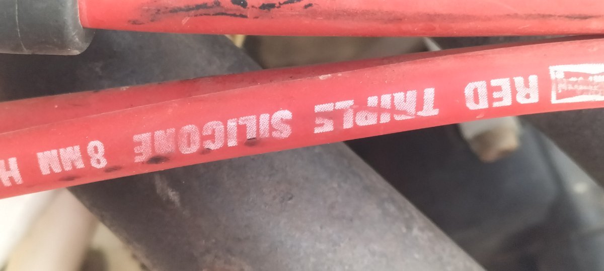

BrendAn Posted June 9 Author Share Posted June 9 These are the plugs and leads. Today I played around a bit with the radio and I turned the intercom off. It seems to be pretty good now. Radio is icom a210. 1 Link to comment Share on other sites More sharing options...

Red Posted June 9 Share Posted June 9 (edited) 4 hours ago, BrendAn said: These are the plugs and leads. Today I played around a bit with the radio and I turned the intercom off. It seems to be pretty good now. Radio is icom a210. Red leads are the early type, they changed to black leads at some point, I can't remember the physical difference, I replaced mine with Magnecor leads, but they didnt seem to make much difference in setup If turning the intercom off made a big change perhaps looking at shielded cables between Radio and intercom might be worth a try.(only ground the shield at one end of the lead.) I seem to remember Icom handheld radios having a noise suppression setting, I guess you've tried that (if it still exists on the modern models) Edited June 9 by Red 1 Link to comment Share on other sites More sharing options...
