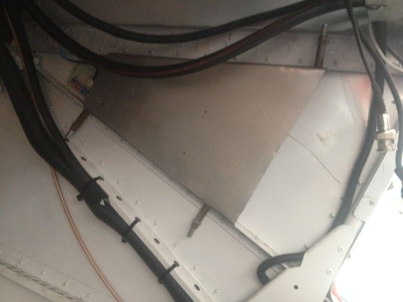

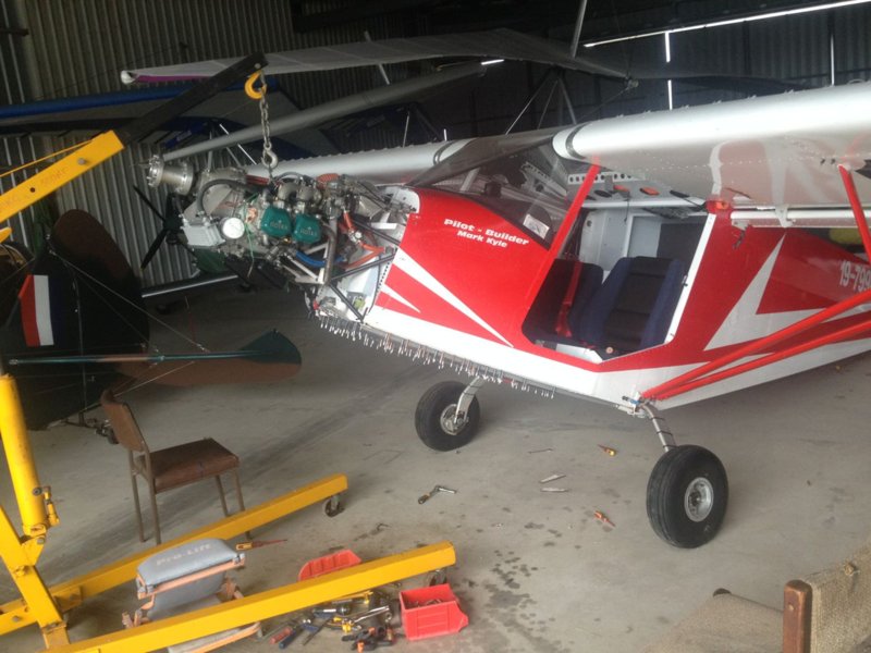

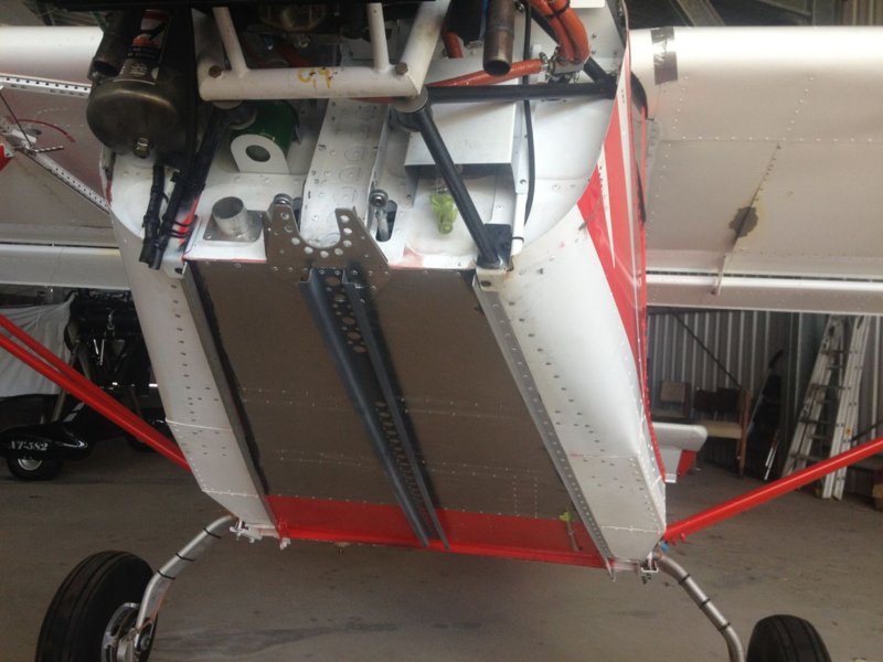

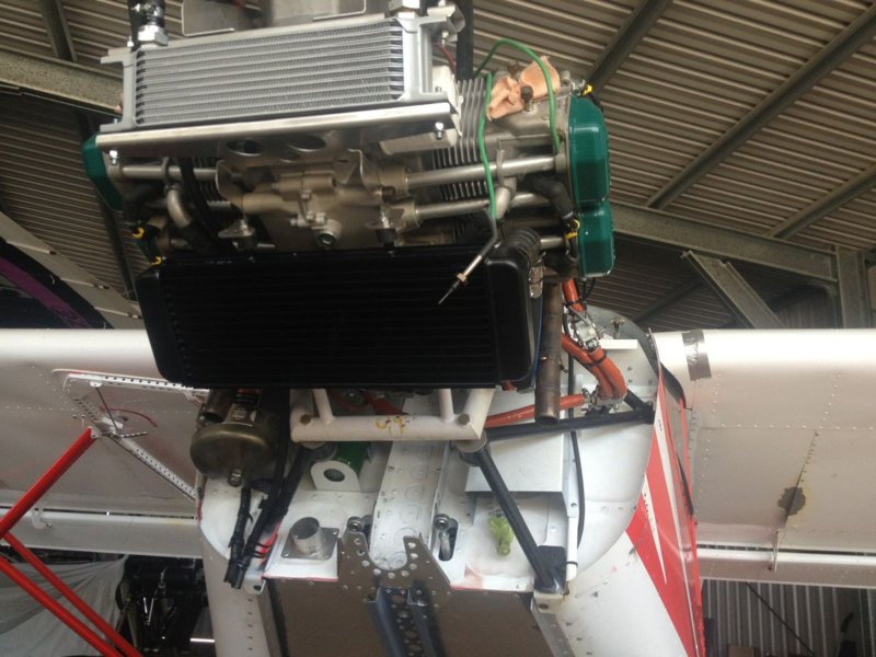

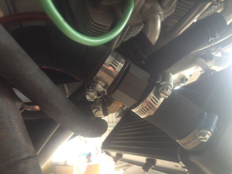

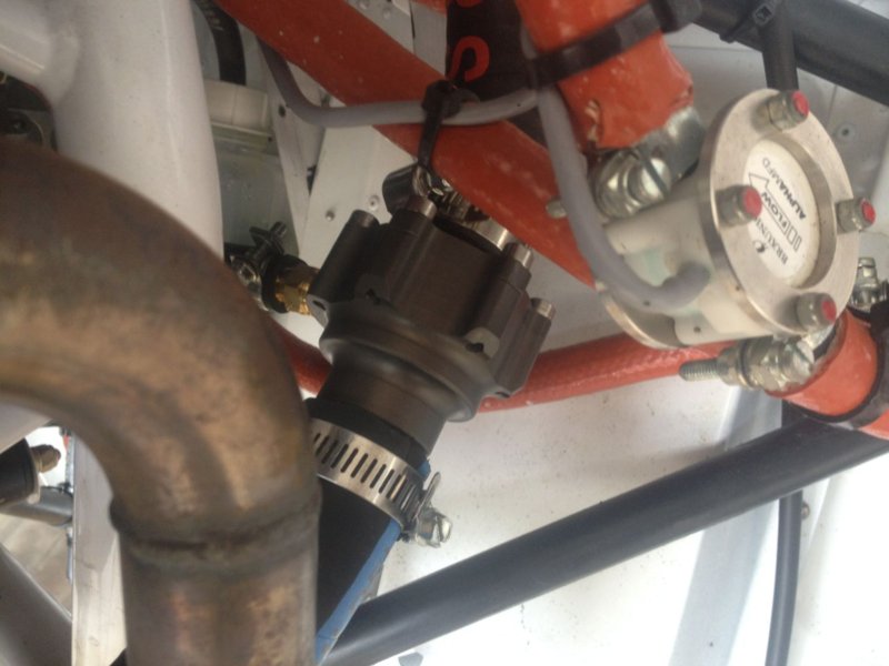

Kyle Communications Posted December 31, 2013 Author Posted December 31, 2013 Wow long time since I posted back in here. I thought I would fire it up again with the mods I have done to fix the girlfriend after the incident. The new panels are all clecoed in ready to rivet. I have fitted a new stronger support bar at the base of the firewall which ties back into the bottom engine mounts. I regent my stainless 90deg bend for the water outlet to the radiator to around 85 deg this makes for a better angle for the hose and no strain on the radiator at all so it won't split like a lot have. I have fitted the water thermostat its a ThermoBob one relatively easy to fit. The engine crane takes the weight off the engine mount so when the frame is riveted back and it is good to see nothing was bent at all the weight will come off the engine mount and then it will be bolted back The triangle shaped alu plate inside the cabin under the dash is for the RDAC engine unit for the EFIS I didn't want to mount it under the cowl as there is a lot of heat there Mark 2

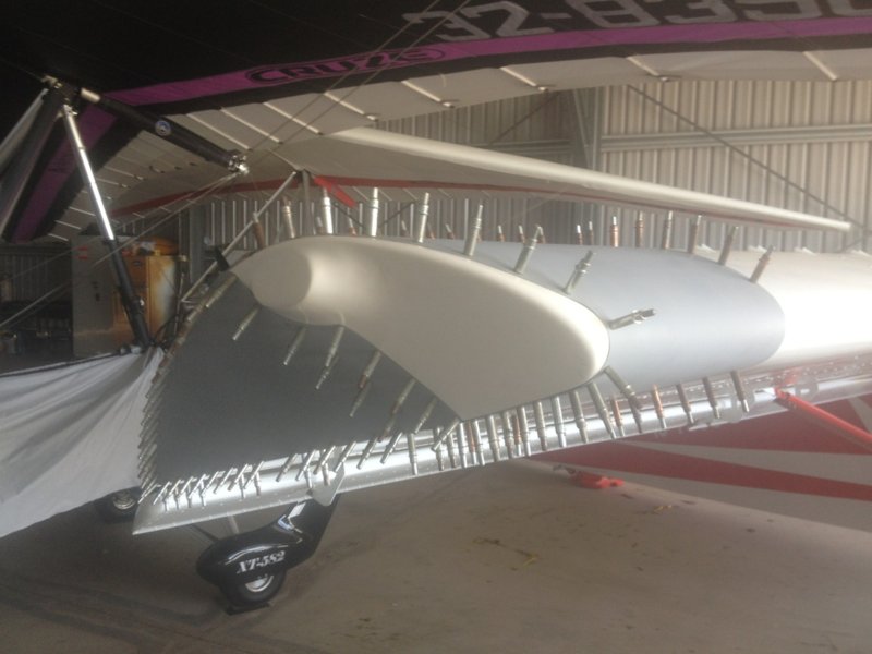

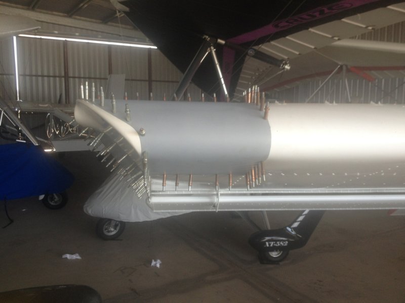

Kyle Communications Posted January 1, 2014 Author Posted January 1, 2014 More progress this morning…a good way to start the new year 1
eightyknots Posted January 1, 2014 Posted January 1, 2014 Great to see the mods coming into place, Mark! I hope you'll get her back into the air soon.
Kyle Communications Posted January 1, 2014 Author Posted January 1, 2014 This morning I will tighten the engine mount bolts up then I can fit the muffler system back on and mark and fit the new cowl and she will be almost ready for painting 1

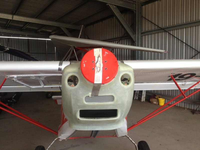

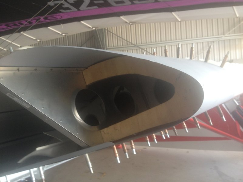

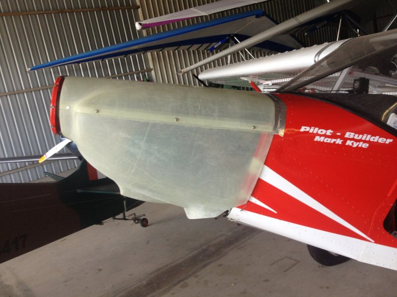

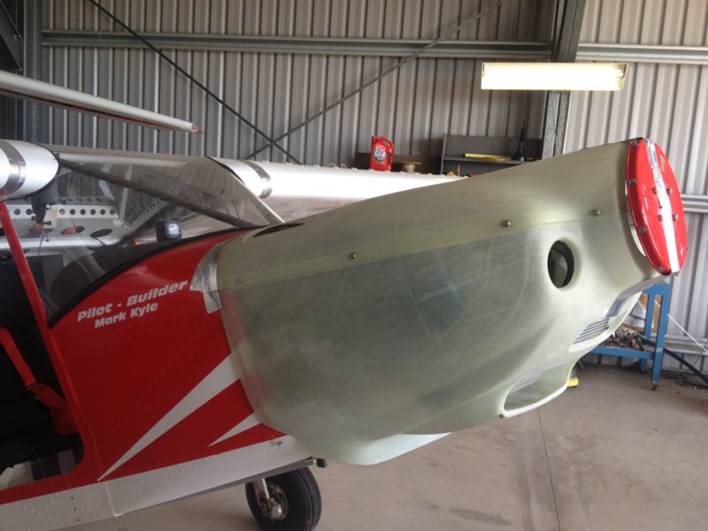

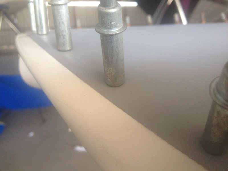

Kyle Communications Posted January 4, 2014 Author Posted January 4, 2014 Worked on the girlfriend the last 2 mornings…got so hot yesterday I had to leave the hangar before 12 and today before 11am…supposed to get to 41 deg today and it feels like it will. Even the magpies were sitting in the shade of the hangar yesterday. Cowl is fitted and 2 screws on each side fitted the bottom screws on each side I need to get my heat gun out and heat the glass up to form it better at the bottom to the outside skin otherwise it pulls too much. Fitted the D nose skin for the tip and all the tip parts…had to find my plywood jig I made to form the D skin so I could cut and fit the fibreglass tip…at least I had the old one it wasn't damaged too much to make the cuts so it was a easy fit. just need to rivet it all now. Yes Steve I nearly forgot to pull the former out too lucky I hadn't riveted it yet, I will do the cowl mods tomorrow and fit the exhaust and see if I have to make any more cutouts in the cowl. I saw "speedy" yesterday he is the local go to guy for painting aircraft at Caboolture…and he is the best around for sure going to do the painting. Dropped off the paint to him I had left over so colour matching should all be fine Mark

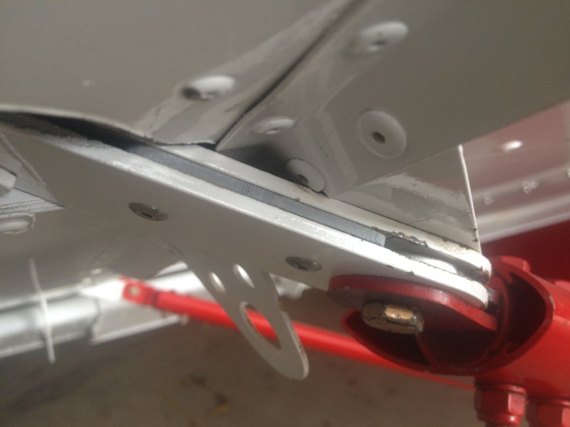

Kyle Communications Posted January 5, 2014 Author Posted January 5, 2014 Got a few things done today had a early start 6am at the hangar..although today was no where near as hot…it was 45 deg yesterday!!!!!!!! riveted the tip repairs all done ready for paint. Did the 600kg upgrade mod. Put the cowl on and heated the glass to make the bottom screws fit better it now conforms better to the side of the aircraft. Fitted the exhaust system back on to check the fit to the cowl. I will have to make the same mod as I did before with a small hole and cover it with metal mesh to stop the exhaust burning the cowl, Just need to fit the hinge for the oil door flap and the door then and pretty mud the plane is ready for painting
rankamateur Posted January 5, 2014 Posted January 5, 2014 Quote Cowl is fitted and 2 screws on each side fitted the bottom screws on each side I need to get my heat gun out and heat the glass up to form it better at the bottom to the outside skin otherwise it pulls too much. The new cowl is way more transparent than mine, the old white gelcoat version. I am pretty sure I can see the engine covers through it in that first photo. It might take more coats of paint to make it look solid.
Kyle Communications Posted January 5, 2014 Author Posted January 5, 2014 My first cowl had a crap load of gelcoat all over it…to hide all the imperfections and I fixed a lot of low points in it the gelcoat it was 2mm thick in places…this new one is at least 2kg lighter than the first one. Undercoat will cover it easily. Just finished off the modified rudder pedals tonight..new coat of black paint to boot. Interesting the backplate of the new bolly spinner is predrilled for the 6 bolts it sits over so that saves a lot of work. I didn't get a hinge for the oil door either so it looks like a trip to Bunnings to get something or maybe Ralph might have something at ASAP aircraft spares..need to get it done this week as painting is starting. Mark 1
