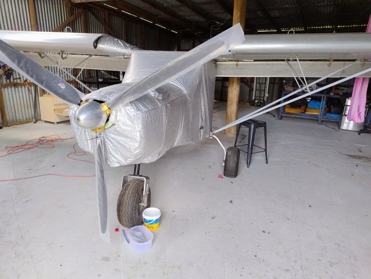

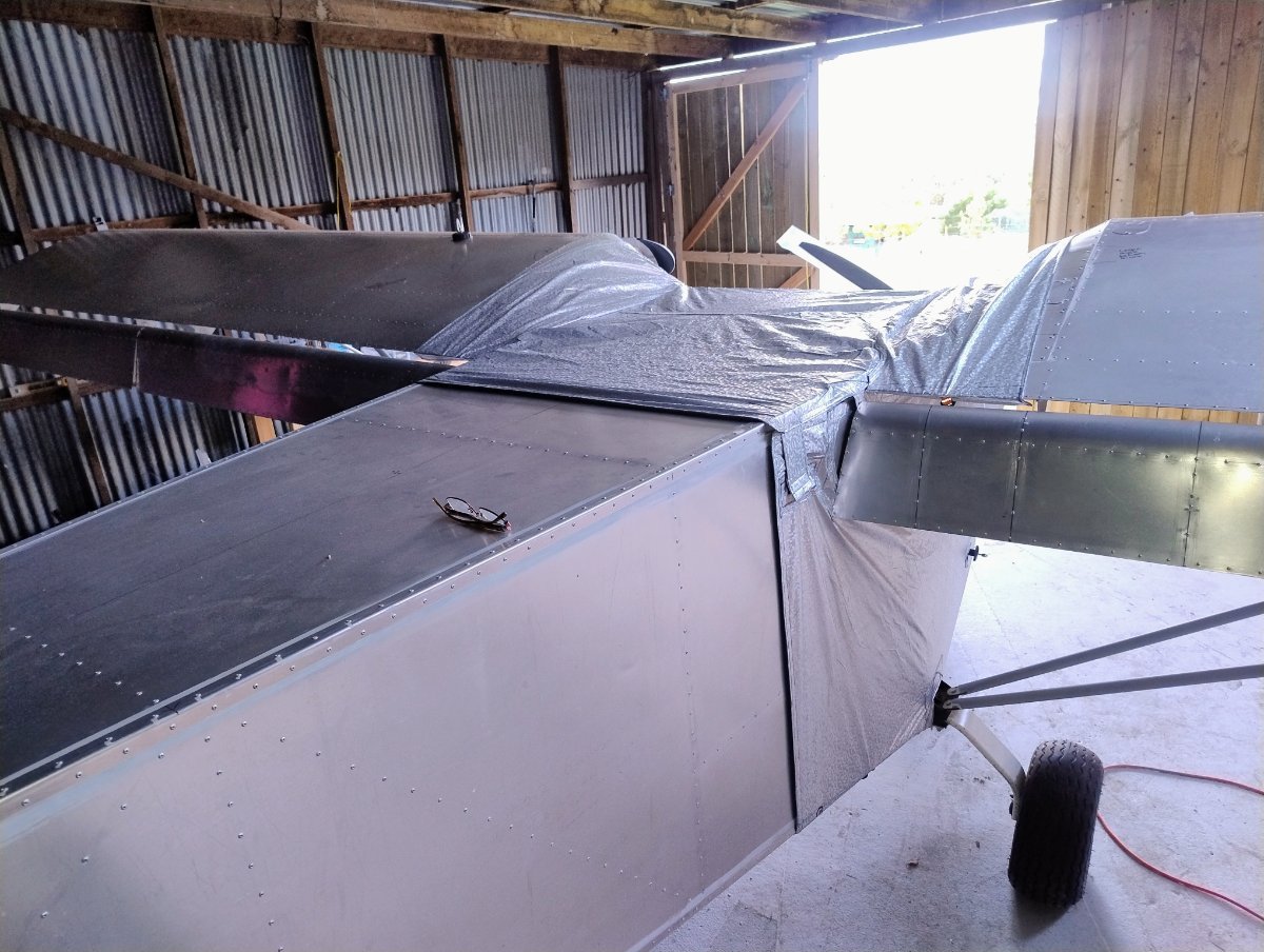

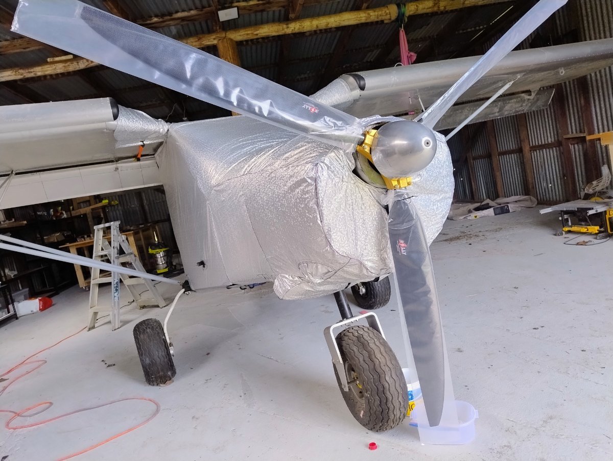

I actually measured from TE wingtip of each wing to the opposite LE tip of the HS, and it was within 1 mm - so I must have had the same amount of forward sweep on each wing!
Looks like it! I had both wings on (with supports) last weekend but need to do a fraction more skin trimming around the rear mounts, at the moment it's got a tiny bit of forward sweep. Looking forward to getting the wings set up properly so I can work on the struts.
