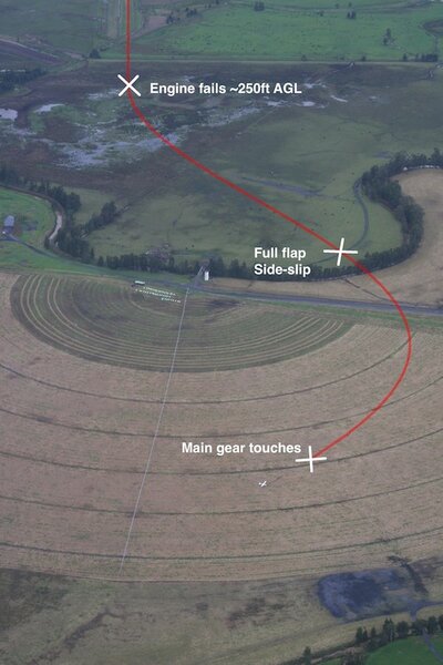

Our J160 suffered an engine failure on takeoff yesterday afternoon. It gave no indication it was about to pack it in. My junior Instructor (I_Like_planes) was doing circuits with a student.At about 200 feet it started running ruoughly and vibrating, then over the next 4 or 5 seconds it lost power and started misfiring badly with a heavy knocking noise. He did a hell of a job to get it down safely, using what power that was left to clear a row of trees and a power line before dumping all the flap and sideslipping into the paddock. The ground was very soft and the nose wheel dug in tipping it up onto a wing. Both he and the student escaped with nil injuries.cheers
Motz, that`s an excellent outcome! We all know,aircraft can be repaired or replaced!
Over the years, I`ve experienced 3 failures under 150` AGL on take-off and each one with a student on board! One before we ran out of strip so I was able to get back down on the strip. The other two just off the end of the strip and I had to put down on the paddock, so I understand what it`s all about.
Positive end result with each and no damage to the Drifter or ourselves
Frank.
Ps, Sorry to you, i_like_planes! I forgot to mention that you did well.
