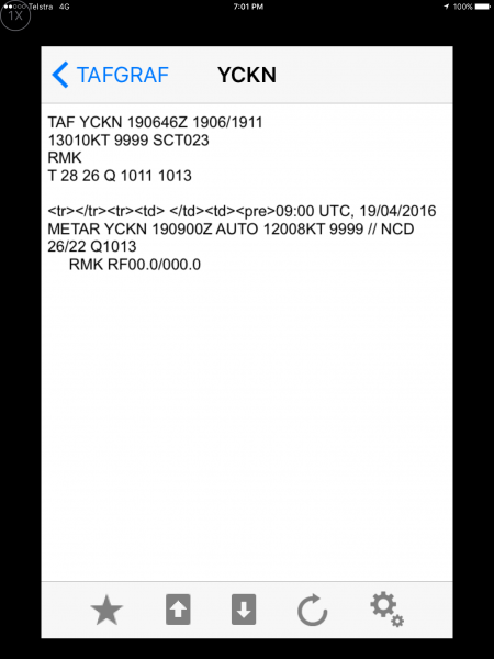

Dunno if you have Ozrunways, if you do there is a function to translate to plain English.
I looked up Horn earlier today, winds 12 kn at 130deg, scattered at 2000
So runway 14 would have been ideal.

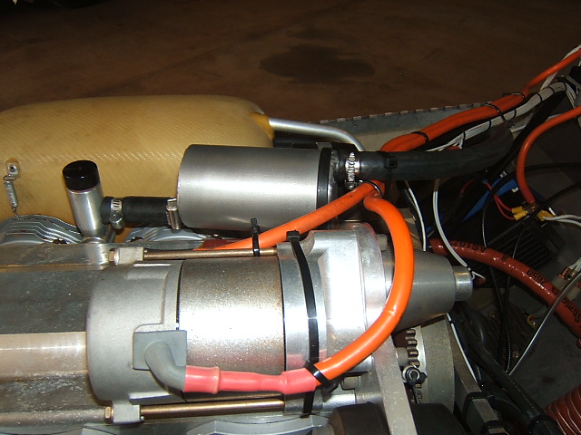

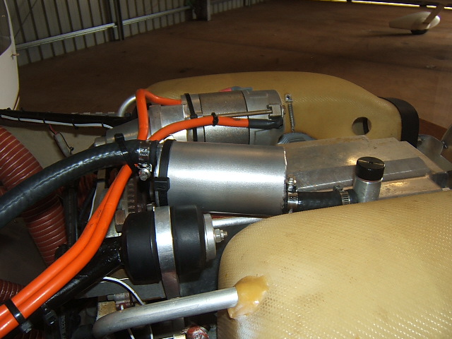

Fitted an oil return recently ( crankcase vents into cylinder, oil runs back into engine ) works a treat. Can now run higher oil levels on the long trips, engine always used to push out higher levels, and run on barely up the dipstick, I was never comfortable with this. So yes....I'm more happyerer.
Mate has been running exact same for several yrs now, alls good.

Bill, they are fitted standard to new Jabiru aircraft now. I don't have one fitted to mine but as oil useage is very low I am quite happy to top up with fresh oil as needed - comes down to personal choise I guess.
Fitted an oil return recently ( crankcase vents into cylinder, oil runs back into engine ) works a treat. Can now run higher oil levels on the long trips, engine always used to push out higher levels, and run on barely up the dipstick, I was never comfortable with this. So yes....I'm more happyerer.Mate has been running exact same for several yrs now, alls good.
What do Jabiru have to say about this? My concern is that people do 'these sorts of things' and then when things go wrong Jabiru engines get blamed and CASA slaps their BS on them. We're not tinkering with hot rods and motor bikes here.
DSCF1539.JPG.c55706900c1877cb56ca2a7557e566f7.JPG Now allows me to run higher oil levels ( bit higher anyway ) on long trips/legs. Prior to this the engine would spit out oil to just on the dipstick ( it's sweet spot ) so in my view during loong legs, actual oil usage begins at the real low point, as 80..100ml has been pumped out. This worried me.....low oil in the sump.
As to "tinkering etc" as 7252 raises........maate, if i was to stick 12ply tyres on...........the reply would be in the negative from jab. ( many guys, i repeat many guys, have over the yrs changed "things" on their jab.......proven by faultless hrs of operation, and the benifits gained as well.......and jab poo poo the bloody lot )
How many times has the discussion been around of jab and their stubinous ( where's me spell check thingo ?? )to ANY changes.........the most recent jab / camit saga. ( camit have done some tweeks etc to the basic jab.........bingo, from All reports......a damn good engine. And jab won't have a bar of it.
Beware of returning condensate to engine oil. I'm not saying the original set up is good. Nev
spoke to a "well qualified " person re "returning oil"......absolutely not a problem here, couple of reasons.....canister and contents are near on engine core heat, at shutdown any residue retained oils would be drained back to sump while still HOT.... oils are changed at 25hr intervals.......he did mention, from time to time good housekeeping would be to remove canister and give it a good washout.
