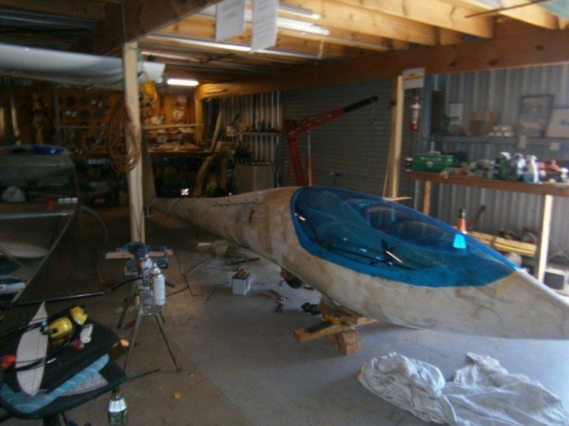

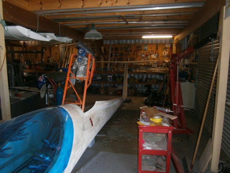

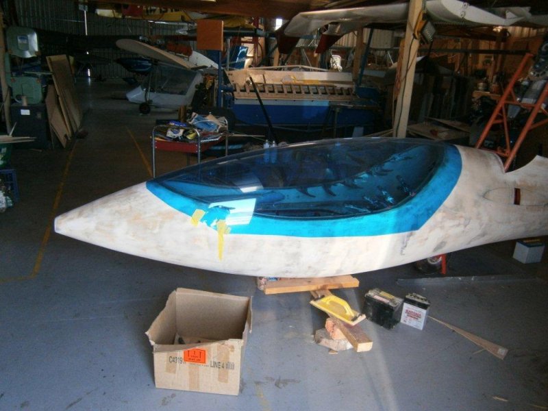

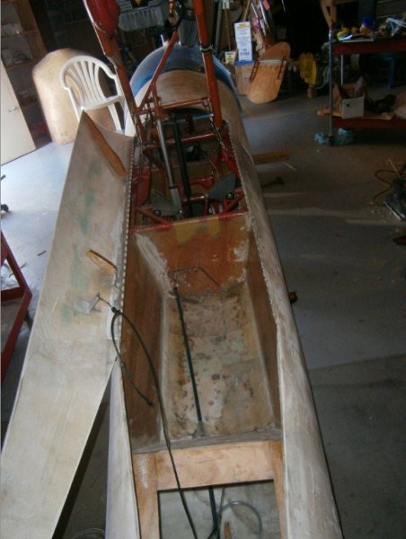

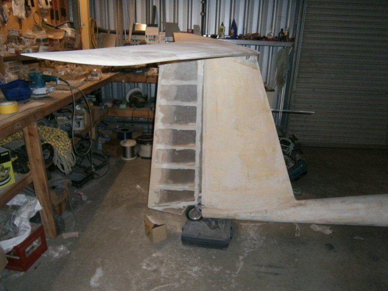

pylon500 Posted May 19, 2016 Share Posted May 19, 2016 Some Shawnee photos (by request) 1 Link to post Share on other sites
