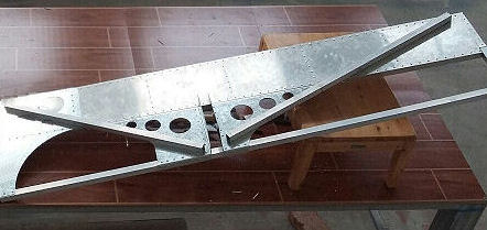

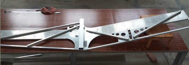

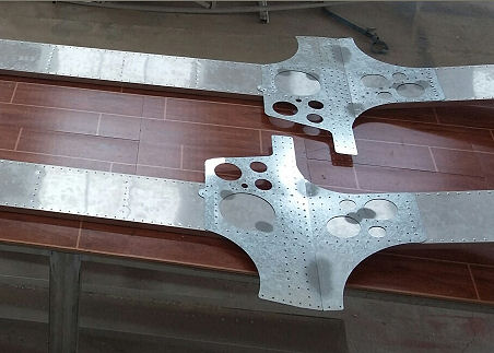

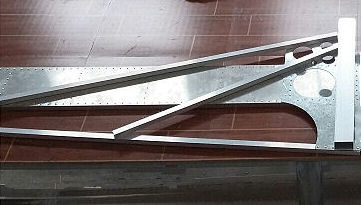

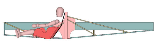

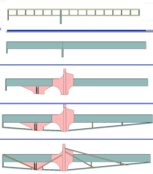

bexrbetter Posted December 27, 2016 Author Share Posted December 27, 2016 So a few weeks ago I was looking at the sides of my project and was thinking that every vertical and angle brace was of a different length and had a different angle cut on each end, along with each individual gusset to carry it to the longerons, I quite like the design but a bit of a headache to consistently reproduce and maybe for others to build with consistency. Note I am not intrinsically changing the design, just making the frame simpler, faster and more accurate to build. That's what actually led to the welded sides, simplifying ease of fitment etc - we all know how that worked out But I had also been considering another idea, and that was a simplified box shear web running the length of the fuse with appropriate further additions, something like this, I call it "The Submarine" ..... .. and of course I'm actually making it, should be done tomorrow ... 2 Link to comment Share on other sites More sharing options...
geoffreywh Posted December 27, 2016 Share Posted December 27, 2016 interesting Link to comment Share on other sites More sharing options...
bexrbetter Posted December 28, 2016 Author Share Posted December 28, 2016 interesting Someone will complain about it. Actually today I decided to split them in half as it was awkward moving the whole side around with the kink in the middle. So much easier to work with 2 smaller and flat pieces. Extremely easy to build up ... 2 Link to comment Share on other sites More sharing options...
