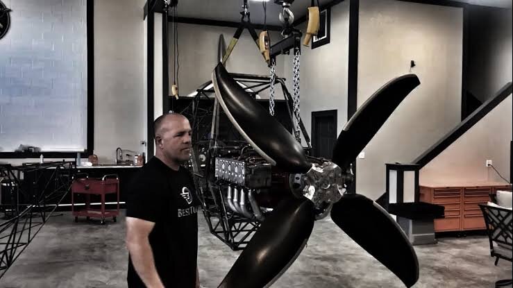

Single blade !, is scientifically the most efficient !.
Three blade seem more balanced & good for climb,
five blade seem to be in the realm of the most power-full.
Ducted fan are suddenly making their way in the modelling world.
And if any one knows who has the rego 55-3014, there's I picture of the BD-5  Jet motor in front of their plane .
spacesailor

This single blade has two features:
  1. The blade is balanced by a counterweight on the opposite side if the hub.
  2. The hub is connected to the propeller shaft through a bearing that allows the propeller assembly to rock back and forth on the mounting.
 It works on centrifugal force more or less. There is no controls or linkages. On take-off it is flat (fine pitch), and in cruise it moves forward at the tip for more bite (coarse pitch).
Backcountry-sentimentalJ2013255_zpsfcc3d433-575x384.jpg?resize=570%2C380     J2-Cub-Single-blade-prop-575x430.jpg?resize=570%2C426
The idea is that a single blade would be more efficient than multiple blades because the single blade is always travelling through undisturbed air. The propeller is counter-weighted and mounted eccentrically on the hub to keep it balanced. It also has fore-aft pivot so the prop pitch self-adjusts to the most efficient angle – you can move the tip of the blade forward and back several inches with your hand.”
“Apparently the design worked; in 1939 the Everel prop was tested on a Taylorcraft in a race and won by quite a bit. However, shortly after the introduction of the prop, powerful 50HP engines were developed which rendered the efficiency gains of the single blade moot. Considering that the balance of the prop was very fickle in changing weather, the already mechanical complex prop just wasn’t worth the effort, so the design never caught on. It’s a nifty bit of engineering and a cool piece of history.
Despite this bit about engines which could produce enough torque and high enough RPM to produce more horsepower being the killer of the single bladed prop, here's an article showing one fitted to a Cessna C-37 with a big radial engine. http://rexresearch.com/unibladeprop/onebladeprop.htm
Perhaps the single blade concept might be abandoned, but the floating hub assembly might be a simple way to get variable pitch.
Don't go there. Stick to a simple 2 blade with no hinges or gimmicks like the majority of engines have always had. Piston engines deliver torque with lumps in it and a loose prop is bad enough without making it more risky structurally. Nev
