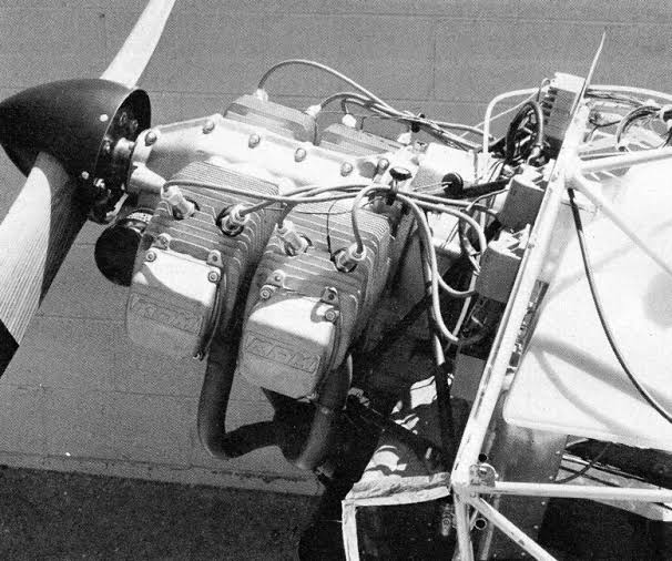

What's the set up with having opposite cylinders in line?. The only opposed motor s like that, which I know of have silly conrods with lots of offset. Nev
Link to post
Are they?
Link to post
It's a V twin.. What horizontally opposed motor has a single pin.? Merlins are the same and a fork and blade rod set enables a non staggered cylinder arrangement (Expensive) A "V" twin can have an excellent even piston speed. Nev

Hi Guys,
Firstly @Thruster88 thanks for the photo, got any more ?
Now..
the KFM112 has offset crank pins and 3 main brgs.
So for example on any pair of opposing cylinders both pistons travel outwards and inwards at the same time due to the crank pins being 180 degrees from each other.
This results in a very well balanced engine.
One side of cylinders is set back by around 30mm from the other side.
Hope this helps.
Skelly.

It doesn't show if there's any offset in the rods near the small end, The 3 main bearing set up allows less cylinder offset than Jabiru's 5 main bearings arrangement. That's why the Jab as a twin had too much vibration to ever be a proposition. Jabiru put one mainbearing between each throw which is good diesel practice but adds weight and makes the cylinders offset more, and makes the crank essentially longer and less stiff in twist. This would have been more of a problem with the 8 cylinder version which is discontinued.. Most aero FLAT engines don't run full counterweighted crankshafts because of the extra weight. This means the middle main bearing is highly loaded as revs go up. I can't see much wrong with that engine except it's probably too small for the job in some situations. Everyone whinged about it's price.. Having the barrel and head in one piece is fine till you have to work on the valve seats but it can be done as it is with most other aero engines of the aircooled kind. Nev
Link to post

Hi Nev,
The rods have no offset, they are pretty short too.
The opposing cylinders are staggered by the thickness of a rod plus the bit of crank between them.
Yes, only 3 main brgs and direct drive.
I can imagine its a pain to replace valve seats as they are right at the end of the cylinder, Putting them should be easy but taking them out looks like a challenge.
Luckily its something I don't need to do anytime soon.
I must say I like the way the engine has no oil pick up pipe to vibrate and snap off, its cast into the crankcase instead.
Skelly.
