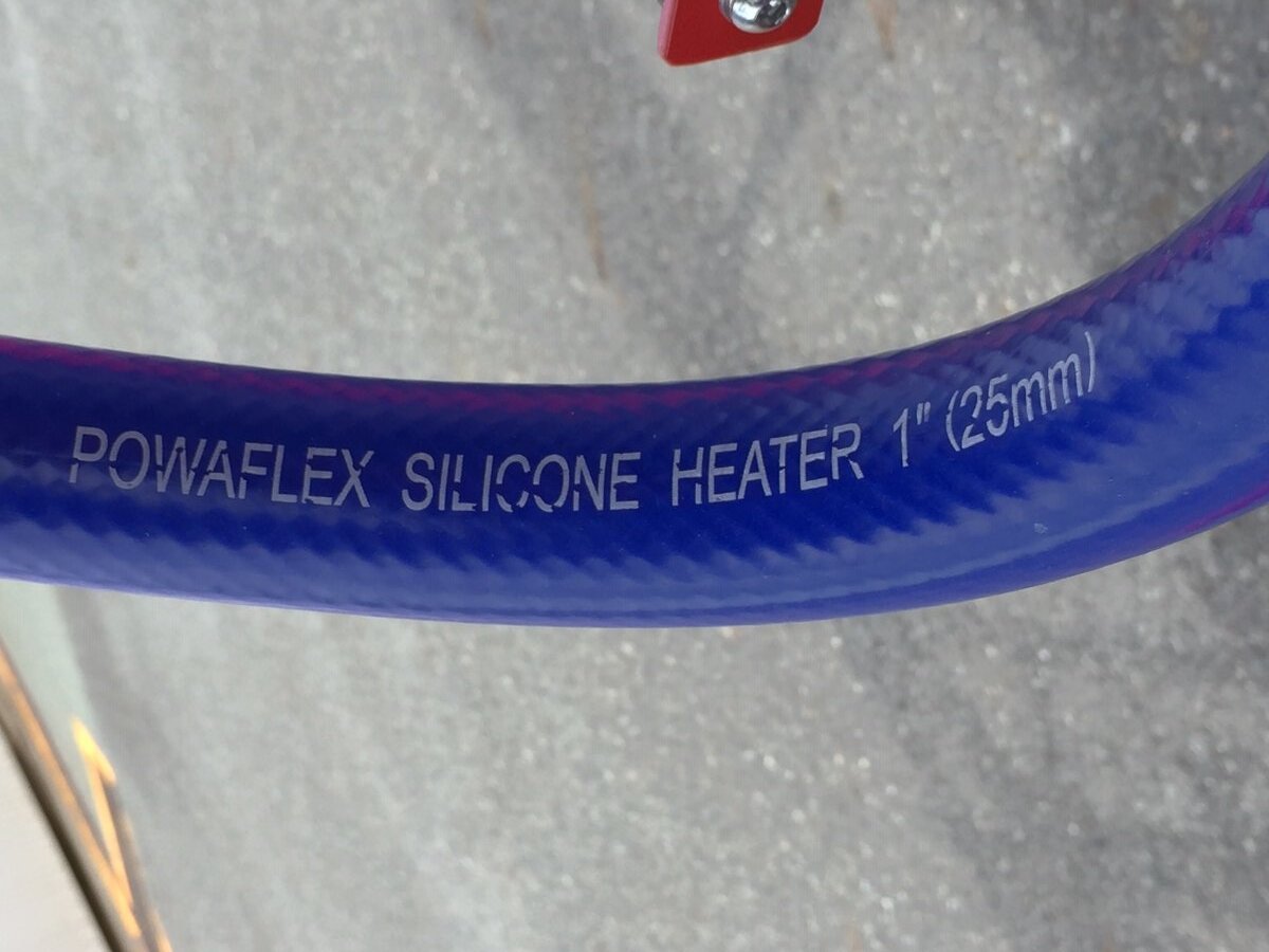

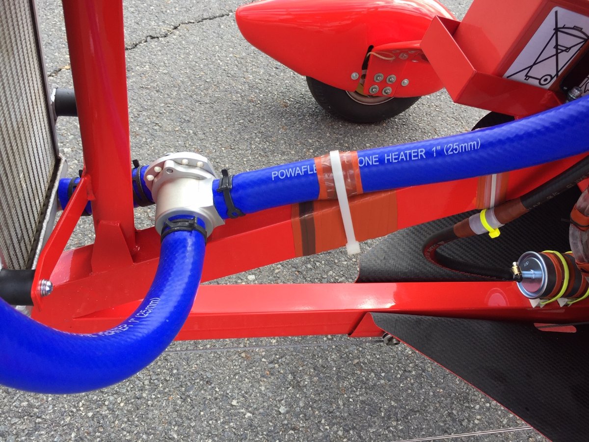

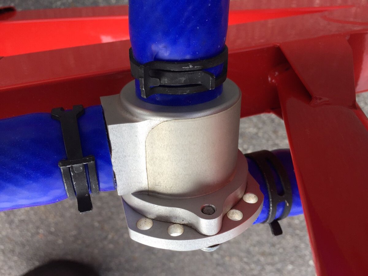

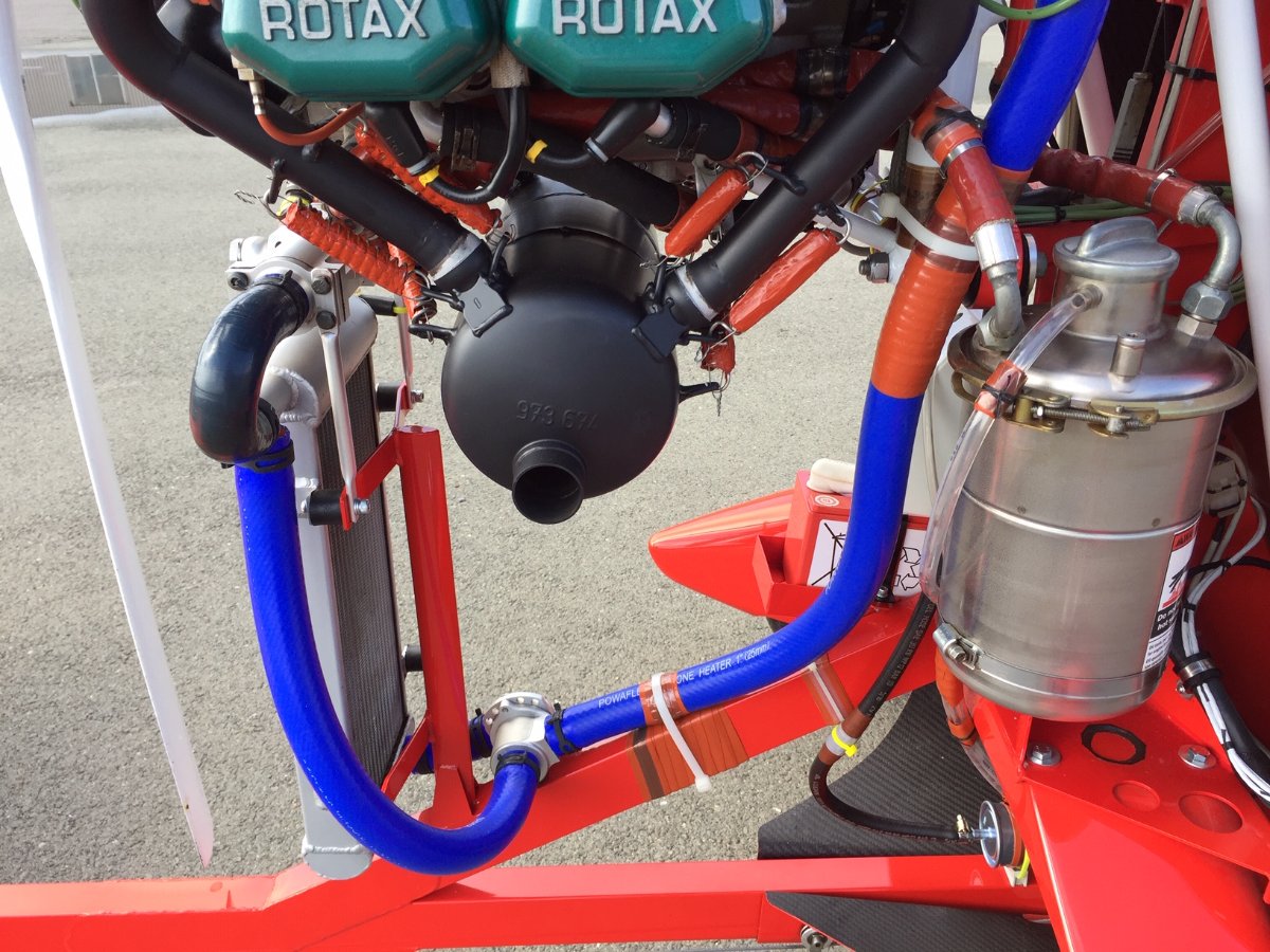

I'd love to hear anyones experience and any feedback good or bad regarding silicone hoses used on Rotax 912ULS engine and whether if this is appropriate? I recently completed a Rotax 5 year rubber replacement on my engine and replaced the one inch stiff ribbed style hose with a silicone one inch heater hose. This silicone hose flex (refer to pictures) easily meets/exceeds the temperature and pressure requirements of this system and there are no kinks when hot or cold.

Your install looks good OT!
I wouldn't mind having one of those thermostats.....
Hows the ceramic exhaust coating holding up?

Silicone rubber hose is superior in every respect over "natural" rubber hose, as regard both low and high temperatures, has higher pressure ratings, is more resistant to UV light, and stays supple for longer.
Probably the weakest point of your installation is the cable ties. Make sure the cable ties you use are UV-resistant, and able to cope with the Australian sun. The white nylon ties do not have the UV-resistance of the black nylon ties.

Agree....Get rid of the zip ties altogether and use some P clamps. It would make that look way more professional and last for years (and safer). If you get the correct size, they could also be shaped to fit the square section. Reuseable too.
I'd be hesitant to drill holes to secure the P clamp without mfg approval personally......
Use two clamps...One shaped to fit the square section and one in the size of the hose, attached to each other.. Common practice. Drilling holes never comes into it.

Hey thanks Downunder and that's great to hear. Yes the ceramic coating is holding well so far also thanks, it was well worth the $300 investment.
https://swiftsupplies.com.au/nylon-uv-resistant-cable-ties-range
Thanks Onetrack for your feedback and much appreciated mate, I generally replace all my zip ties annually so it's not a problem 🙂
I would never use zip ties in this application. At least no longer than an emergency temporary when you are out in the Tanami Desert. Like 30 days maximum.
AND
if you do use black zip ties, make sure you buy the ones with the METAL TONGUE.
I would suggest NOT use the types with the plastic tongue, about 1 in 10 has a defect in my experience.
-glen
The farm supplies store where I lived previously only stocked Ty-rap - Thomas and Betts cable ties. They are the best, have rated load and excellent UV resistance (black). Two should be used interconnected to attach soft hoses to frame work.
