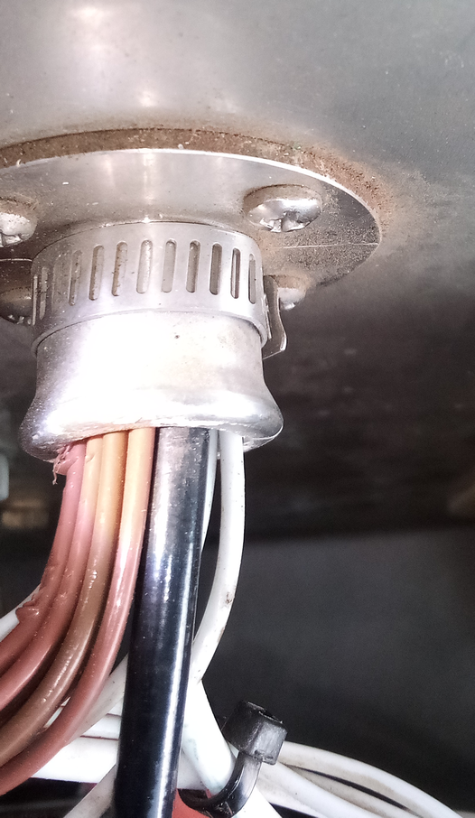

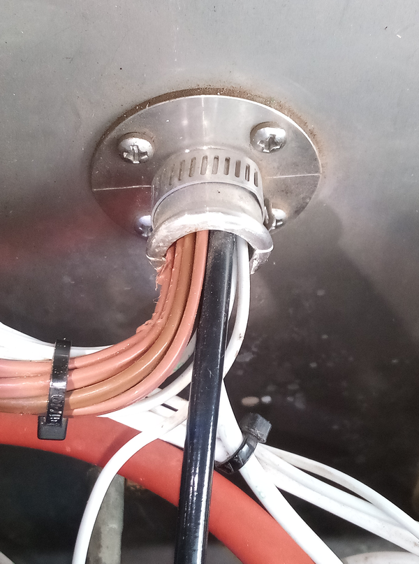

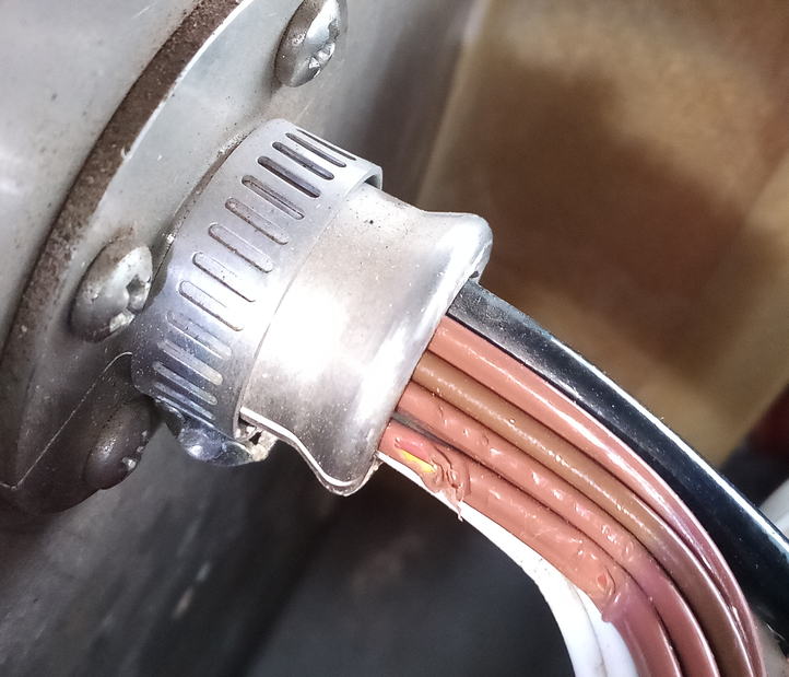

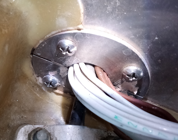

RFguy Posted December 21, 2020 Share Posted December 21, 2020 On my J230D, there is a firewall penetration with no grommet. I would always have a grommet, however read on ... Now, this might be OK as the edges of the metal clamp are all fairly clean and smooth and it is quite a deep long clamp, clamps over a vary long length and hence has a large surface area BUT there are some sharp edges where to the two halves join . In my airplane, the EGT/CGT wires have gone through to the wire, through two lots of insulation. AND the unfused 10/12 AWG TEF wire , direct to battery wires have lost quite a bit of their insulation !!! fire waiting to happen. I rectified this before I flew it, however people may want to check it I have pulled the wires back in the photo to show. You cannot see the loss of insulation on the battery wires, too hard to do with a phone camera. This is on the STARBOARD side, IE co pilot. Also there is a single photo from the OTHER side- pilot side. Link to comment Share on other sites More sharing options...
Thruster88 Posted December 21, 2020 Share Posted December 21, 2020 Glen, If you turn the master switch off (smoke in the cockpit) is that wire still live? Link to comment Share on other sites More sharing options...
RFguy Posted December 21, 2020 Author Share Posted December 21, 2020 (edited) yes. its how they are wired. it's in the schematic. the penetration- I just dont know if this is typical (mfr/install) or special (unique) Edited December 21, 2020 by RFguy Link to comment Share on other sites More sharing options...
facthunter Posted December 21, 2020 Share Posted December 21, 2020 You must take a lot of care with "Unprotected" wiring. Even fuses don't rule out a fire. Sharp metal edges there are wrong also. "It's your life. Ralph". If you get smoke you should be able to isolate the circuits from POWER quickly and easily.. Nev 1 Link to comment Share on other sites More sharing options...
RFguy Posted December 21, 2020 Author Share Posted December 21, 2020 (edited) either way, I suggest people to check out their aircraft BEFORE ANY FLIGHT I am also going to dig a bit deeper on the Tasmania J170C fire (ATSB report). I have got a MIDI fuse size setup ready for it, and a contactor in the pipeline. so it can be completely isolated. It's f__king insane the way it is. Edited December 21, 2020 by RFguy 3 Link to comment Share on other sites More sharing options...
Thruster88 Posted December 21, 2020 Share Posted December 21, 2020 2 minutes ago, facthunter said: You must take a lot of care with "Unprotected" wiring. Even fuses don't rule out a fire. Sharp metal edges there are wrong also. "It's your life. Ralph". If you get smoke you should be able to isolate the circuits from POWER quickly and easily.. I fly and work on certified aircraft, they have the ability to isolate all electrical power. Link to comment Share on other sites More sharing options...
facthunter Posted December 21, 2020 Share Posted December 21, 2020 (edited) Relay points can weld/stick too, and whatever they energise stays working, even though the switch says OFF.. I experienced a BIG engine fire that way. Nev Edited December 21, 2020 by facthunter Link to comment Share on other sites More sharing options...
RFguy Posted December 21, 2020 Author Share Posted December 21, 2020 (edited) Anyway, this needs to be made a safety priority. Like I said I do not know if that setup I have is unique or factory. Service Problem 1) firewall wire clamp cuts wires , no conformable grommet used. (IE unique or factory ?) Design Problem 2) Battery has no ability to be isolated for wires passing through the firewall into the unknown where they cannot be readily inspected. Should this be driven from the manufacturer or RAaus technical manager or the regulator ? I AM NOT TRYING TO CREATE A HEADACHE FOR PEOPLE HERE-- BUT I KNOW WHAT BATTERY DRIVEN ELECTRICAL FIRES DO Edited December 21, 2020 by RFguy Link to comment Share on other sites More sharing options...

onetrack Posted December 21, 2020 Share Posted December 21, 2020 (edited) I find it hard to believe anyone would build an aircraft with such an amateurish wiring protection setup. Either that, or someone has worked on it, and discarded any properly-installed grommet or other protection. I wouldn't even allow any land-based vehicle to have a firewall wiring setup like that, it's just asking for trouble. Edited December 21, 2020 by onetrack 1 Link to comment Share on other sites More sharing options...
old man emu Posted December 21, 2020 Share Posted December 21, 2020 RFguy, I'm being serious here. I firmly believe that it is your duty to firstly notify RAAus and the manufacturer of the situation in your aircraft. I would strongly recommend, in fact, say to do it first, contact CASA and advise them of the defect. There will be some here who will exhibit their paranoia about "The Man", but if you tell CASA they will have to do something about it. RAAus and the manufacturer might sit on it. You've saved your life by identifying the problem, and no doubt, rectifying it, but what about the other poor bugger who might find him/herself dealing with an in-flight fire over inhospitable country? 1 2 Link to comment Share on other sites More sharing options...
Blueadventures Posted December 21, 2020 Share Posted December 21, 2020 4 hours ago, RFguy said: On my J230D, there is a firewall penetration with no grommet. I would always have a grommet, however read on ... Now, this might be OK as the edges of the metal clamp are all fairly clean and smooth and it is quite a deep long clamp, clamps over a vary long length and hence has a large surface area BUT there are some sharp edges where to the two halves join . In my airplane, the EGT/CGT wires have gone through to the wire, through two lots of insulation. AND the unfused 10/12 AWG TEF wire , direct to battery wires have lost quite a bit of their insulation !!! fire waiting to happen. I rectified this before I flew it, however people may want to check it I have pulled the wires back in the photo to show. You cannot see the loss of insulation on the battery wires, too hard to do with a phone camera. This is on the STARBOARD side, IE co pilot. Also there is a single photo from the OTHER side- pilot side. Just too many wires in this penetration gland. Need two and wrap the wires to prevent mechanical damage to the wire insulation. Some wrap the wires in fire sleeve through the gland and then fill with a heat resistant silicone. No worries if done correctly. Yours needs fixing so agree that you are getting on to it. Your Jab a 19 or factory build? Link to comment Share on other sites More sharing options...

RFguy Posted December 21, 2020 Author Share Posted December 21, 2020 (edited) 24 build airframe #J766. built 2010. TTIS 700 h. Mechanically everywhere else- beautiful. Fantastic to fly. A pleasure to fly . Mechanical maintenance and books was in my opinion, gold standard. The previous owners really looked after this bird . But, as I see regularly, electronics and wiring can be a weak spot in general aviation . (I wrapped it up in Kapton tape before it flew). I think the gland-clamp is supposed to work by a broad area clamp (heater hose clamp?) , so if nothing moves, and the insulation does not cold-flow (I am not sure about cold flow behaviour for TEF wire ???) then you might be lucky. There is not much movement due to the size of the bundle, and the bundle going all different directions, so for that reason, there are probably less fires than there might be. Either way, people need to check their aircraft. I will have a discussion with a maintenance facility tomorrow. on a course of action. Edited December 21, 2020 by RFguy 1 Link to comment Share on other sites More sharing options...

skippydiesel Posted December 22, 2020 Share Posted December 22, 2020 On 21/12/2020 at 5:47 PM, RFguy said: On my J230D, there is a firewall penetration with no grommet. I would always have a grommet, however read on ... Now, this might be OK as the edges of the metal clamp are all fairly clean and smooth and it is quite a deep long clamp, clamps over a vary long length and hence has a large surface area BUT there are some sharp edges where to the two halves join . In my airplane, the EGT/CGT wires have gone through to the wire, through two lots of insulation. AND the unfused 10/12 AWG TEF wire , direct to battery wires have lost quite a bit of their insulation !!! fire waiting to happen. I rectified this before I flew it, however people may want to check it I have pulled the wires back in the photo to show. You cannot see the loss of insulation on the battery wires, too hard to do with a phone camera. This is on the STARBOARD side, IE co pilot. Also there is a single photo from the OTHER side- pilot side. RF the damage you have shown looks to me to have little to do with the firewall penetration/gland itself. It looks like the one with obviously damaged wire/insulation and its close partner, have been subject to strong mechanical force, consistent with being pulled ridiculously hard. The one with the peeled back insulation has been pulled against a, none too sharp, edge, its close partner shows possible stretch damage. Link to comment Share on other sites More sharing options...
planedriver Posted December 22, 2020 Share Posted December 22, 2020 However, this is something many should all be aware of. Not everyone is oh fay with electrics and by raising the issue which could possibly save someones bacon, I say good on you RF. To be forewarned is to be forearmed. Hopefully not too many around like it, but certainly worth checking. Not easy to do once airborne. All electrics should have provision to be isolated if the need arises. Link to comment Share on other sites More sharing options...
RFguy Posted December 22, 2020 Author Share Posted December 22, 2020 Sean you cannot see the damage to the TEF wire, either. There is a edge on the clamshell join . Make no mistake . This is a very serious situation. Everyone needs to check their aircraft Link to comment Share on other sites More sharing options...
skippydiesel Posted December 22, 2020 Share Posted December 22, 2020 1 hour ago, RFguy said: Sean you cannot see the damage to the TEF wire, either. There is a edge on the clamshell join . Make no mistake . This is a very serious situation. Everyone needs to check their aircraft I agree 110%. Just musing/speculating on the possible cause/mechanism of the damage - not intending to minimise the seriousness of the issue - no one wants an in flight fire. Link to comment Share on other sites More sharing options...

Yenn Posted December 23, 2020 Share Posted December 23, 2020 That grouping of wires looks poor to me. The greater the number of wires in a bundle, the greater the heating effect and also the greater the possibility of circuits interacting with each other. You would not want to put the P leads in with CHT or EGT and the general setup is just asking for abrasion and damage. At the very least the bundle should have had some protection from mechanical damage, Just a case of very poor assembly. Was it done by the manufacturer> I doubt it. 1 1 Link to comment Share on other sites More sharing options...
Blueadventures Posted December 23, 2020 Share Posted December 23, 2020 7 hours ago, Yenn said: That grouping of wires looks poor to me. The greater the number of wires in a bundle, the greater the heating effect and also the greater the possibility of circuits interacting with each other. You would not want to put the P leads in with CHT or EGT and the general setup is just asking for abrasion and damage. At the very least the bundle should have had some protection from mechanical damage, Just a case of very poor assembly. Was it done by the manufacturer> I doubt it. It’s a factory built 24. Being J766 in 2010. Refer earlier post by RF. The gland is excellent, just the number of wires and their fit up is poor / not good enough. Link to comment Share on other sites More sharing options...
