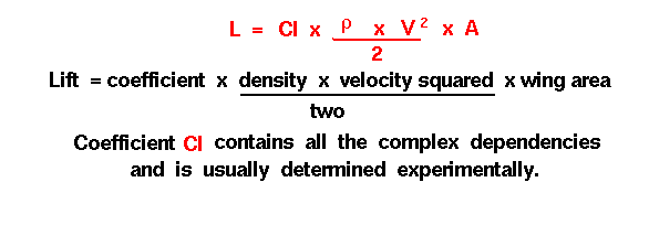

old man emu Posted January 22, 2021 Share Posted January 22, 2021 I hope I've read into the question correctly and we are back into the Lift equation, albeit this time in purely practical terms We want to calculate what conditions are need for a wing to generate sufficient Lift to balance, or exceed the weight of the aircraft. So let's look at what can and cannot change in that formula. Total Lift - This is the result of the calculation. Coefficient of Lift - unchangeable as it is part of the aerofoil design Density - We know that is a variable thing. Velocity - That's in True Airspeed, and since density and temperature are involved, it is a variable Wing Area - That is part of the aircraft design so in unchangeable. If we acknowledge the involvement of Coefficient of Lift and wing area in lift creation, but know that they are not variables, we can assign them the value of one (1) for calculation purposes. Therefore the Lift equation becomes Lift = {1 x (density x TAS)^2 x 1} /2 If you know the air density and the TAS you can calculate Lift. If, on the other hand , you know what Lift you need, then you have to fiddle with density and TAS. In this case, because you are operating from a certain altitude and at a certain known density, then by pluging in the known density and fiddling with the TAS you can calculate how much faster your takeoff speed will be above the speed for MYOW. Link to comment Share on other sites More sharing options...

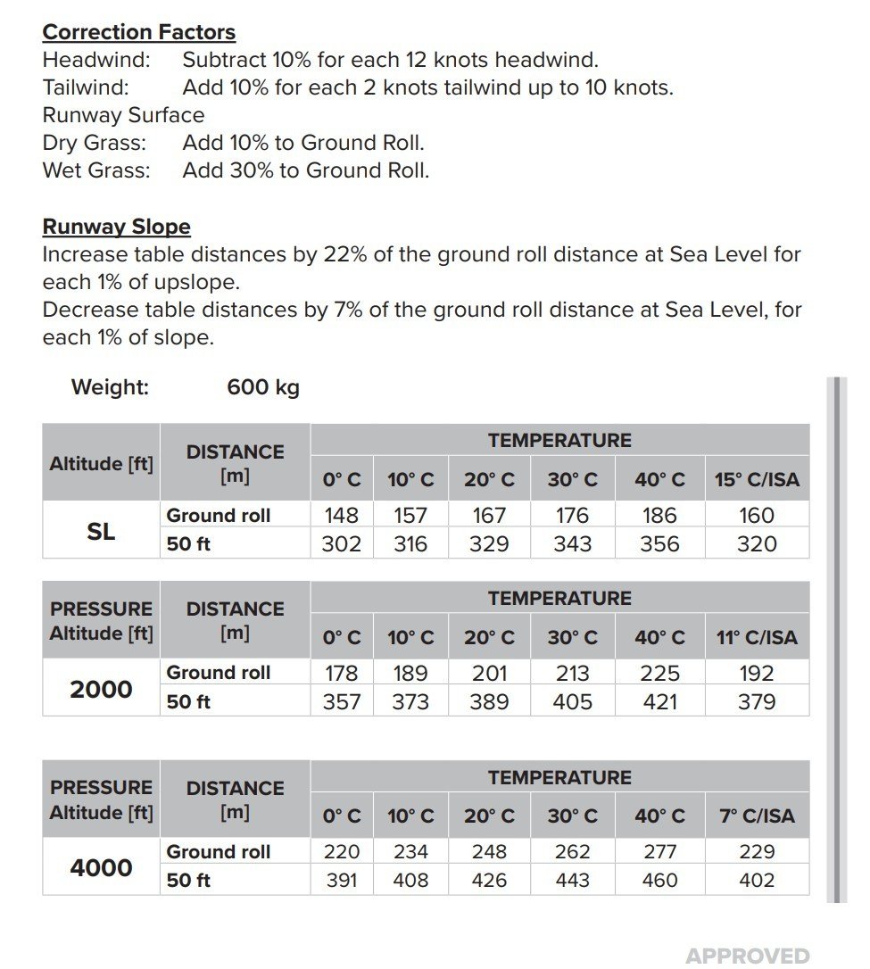

FlyBoy1960 Posted January 22, 2021 Share Posted January 22, 2021 all of this should be in the manual for every aircraft. They are easy formulas to calculate but some manufacturers include simple tables like this for people that don't have a calculator 2 1 Link to comment Share on other sites More sharing options...
old man emu Posted January 22, 2021 Share Posted January 22, 2021 2 hours ago, FlyBoy1960 said: They are easy formulas to calculate but some manufacturers include simple tables like this for people that don't have a calculator That table is not good for answering the OP's original question. If the published MTOW is exceeded, can you calculate how much above it the wings can lift. Clearly the question relates to going beyond manufacturer's advice. Remember that the in one famous operation in DC-3 (or C-47) aircraft, they overloaded the planes like a Tokyo commuter train and they still flew. I'm hoping for some discussion on the assumptions I made. This is an interesting topic. There is one factor that the Lift formula cannot account for, and that is the location of the Centre of Gravity. I suspect that an aircraft's wing is capable of generating very much more lift that would be required, but getting the Balance within the envelope might be the idea's killer. Link to comment Share on other sites More sharing options...
