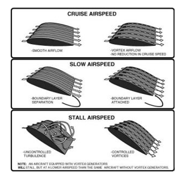

IBob Posted February 6, 2021 Share Posted February 6, 2021 I enjoyed that. And some beaut images too! What I still don't really get is the stuff about VGs (and gold balls). Not that I doubt they work in altering wing behaviour and flight of ball, but when it gets to the bit where they describe just how that happens, the explanations always seem to me to be vague: In the case of the golf ball, while the downstream turbulance appeared different, the laminar flow didn't appear to be sticking any better to the ball. In the case of the VGs, you're making a vortex which swirls or rolls the laminar air. Okay, fine, I got that. But why does that then delay the onset of stall??? Link to comment Share on other sites More sharing options...
old man emu Posted February 6, 2021 Share Posted February 6, 2021 Laminar flow around golf ball. Either my eyes are better than yours, or my monitor is. I watched the video on full screen and I could in fact see a longer space behind the ball before the eddies appeared. Vortex Generators. The impression I got from the images was that without VGs, at the stall, the airflow separated from the surface of the wing and never returns. With the VGs it still separates, but swirls back down to contact the wing closer to the trailing edge. That return to the surface must result in enough lift to reduce stall speed. Link to comment Share on other sites More sharing options...
skippydiesel Posted February 6, 2021 Share Posted February 6, 2021 1 hour ago, IBob said: I I But why does that then delay the onset of stall??? This numskull recons that it induces mixing of the fast air (molecules ?) with the slowing air close to the surface, which induces an acceleration, which helps to "stick" the airflow to the surface of the wing for longer (not for ever) enabling a lower stall speed a - slower controlled flight, shorter take offs, steeper climb outs - am I close?????? 2 Link to comment Share on other sites More sharing options...

facthunter Posted February 7, 2021 Share Posted February 7, 2021 When the air flows over a wing at an angle to the relative airflow there's a point where separation commences. IF you blow that area or impose vortices on it t he separation will take place further along the wings chord and more lift is produced at those angles since the area "working" has been increased. Nev 1 Link to comment Share on other sites More sharing options...
