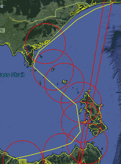

RFguy Posted May 29, 2021 Share Posted May 29, 2021 (edited) Looking at how to meet the 25nm limit to Burnie. Mind you, by the time i do this I'll likely have my RPL/CPL. Does this sort of route pass muster ? comments please. deviations of course matter little on this one. Edited May 29, 2021 by RFguy 1 Link to comment Share on other sites More sharing options...
turboplanner Posted May 29, 2021 Share Posted May 29, 2021 38 minutes ago, RFguy said: Looking at how to meet the 25nm limit to Burnie. Mind you, by the time i do this I'll likely have my RPL/CPL. Does this sort of route pass muster ? comments please. deviations of course matter little on this one. I'm not sure what's being dreamed up here, but if it's a series of 25 NM hops by a student, the 25 Nm is from your home airport where you are being taught. The home airport if PPL teaching is taking place will also have a "Training Area" with boundaries you must stay within. In both cases you get out of that home base by getting your certificate/licence AND after your Cross Country/Navigation theory and practical exams have been passed. Even at that heady stage I wouldn't be thinking of Island hopping to Tasmania where even the coast fishermen carry BOATS on board. If however, this is a fully qualified and endorsed pilot with, for example a bladder liit of 25 Nm, there could be closer ALAS on the mainland or northern Tasmania. 1 Link to comment Share on other sites More sharing options...
Thruster88 Posted May 29, 2021 Share Posted May 29, 2021 4 minutes ago, turboplanner said: I'm not sure what's being dreamed up here, but if it's a series of 25 NM hops by a student, the 25 Nm is from your home airport where you are being taught. The home airport if PPL teaching is taking place will also have a "Training Area" with boundaries you must stay within. In both cases you get out of that home base by getting your certificate/licence AND after your Cross Country/Navigation theory and practical exams have been passed. Even at that heady stage I wouldn't be thinking of Island hopping to Tasmania where even the coast fishermen carry BOATS on board. If however, this is a fully qualified and endorsed pilot with, for example a bladder liit of 25 Nm, there could be closer ALAS on the mainland or northern Tasmania. RFguy most definitely has a nav endorsement. Just hope he doesn't want to fly to tasmania in the jab, he is a good guy and would be sadly missed😥 1 1 Link to comment Share on other sites More sharing options...

facthunter Posted May 29, 2021 Share Posted May 29, 2021 Jabs have flown to New Zealand. I would have kept closer to the prom. You don't use ALA's you just use a place you can land on in an emergency That will be affected by cloud base wind and how well the plane glides. Some of the land is rough and hard to guarantee a non injury landing. I'd fly closer to a beach when one exists than off the coast where you can just make it. Google earth should enable close scrutiny. Nev Link to comment Share on other sites More sharing options...
RFguy Posted May 29, 2021 Author Share Posted May 29, 2021 Although I think I'm still in experienced with regard to judging weather, and judging changing weather from the airplane. to glide 25nm, I'd have to have the Jab about, in nil wind, about 13000 feet Rolling on floor laughing... Seriously though, yeah some of those islands are best suited to penguins and seals. Fly in a 5mm wet suit is probably a good start. Link to comment Share on other sites More sharing options...
RFguy Posted May 29, 2021 Author Share Posted May 29, 2021 Hi Nev Yeah, I agree with your points of staying a bit closer. if it is only going to cost 30 minutes extra the whole trip (450nm) to route so that one can glide (wind dependent) to land, then that is certainly a 30 minutes worth taking. 1 Link to comment Share on other sites More sharing options...
tillmanr Posted May 29, 2021 Share Posted May 29, 2021 I believe that the safest route is from Wilson’s Prom, Flinders Island to Tassie. Maybe not able to land everywhere but ditching close to shore sounds better than ditching at sea. Not much of a diversion for you. Link to comment Share on other sites More sharing options...

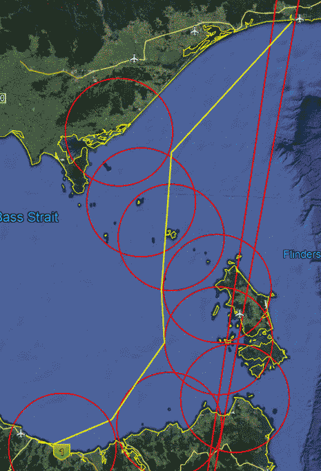

RFguy Posted May 29, 2021 Author Share Posted May 29, 2021 like this ? 385nm versus 292 nm. we'll call this METHOD#2 1 Link to comment Share on other sites More sharing options...

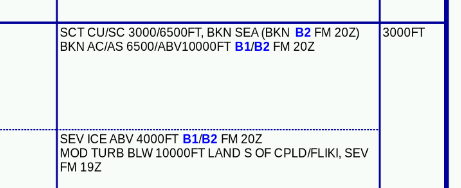

RFguy Posted May 30, 2021 Author Share Posted May 30, 2021 GAF today area 70 : With the 1032 HIGH right over the Strait , and this is about as friendly as it gets I think this time of year : oh boy - area 70,23Z- 05Z Then, after 05Z : Link to comment Share on other sites More sharing options...

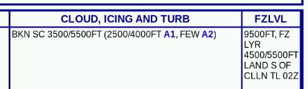

RFguy Posted May 30, 2021 Author Share Posted May 30, 2021 (edited) Thanks Marty ! even with a big high system overhead, another day of low level BKN SC doesn't really change all day. The $64 question is , if one flys above it, does it extend over land, so you'd really want to get under it before getting near the land. wind over flinders at 5000 270T/10. to the west with the front approaching, to the west over King, 330T/18 ish Edited May 30, 2021 by RFguy Link to comment Share on other sites More sharing options...

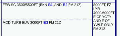

RFguy Posted June 4, 2021 Author Share Posted June 4, 2021 (edited) Today, not so friendly. Bass Strait in the north, not too friendly. further south, quite unfriendly. freezing level is low. maybe stay in the airport pub. Northern SOuthern Edited June 4, 2021 by RFguy Link to comment Share on other sites More sharing options...
