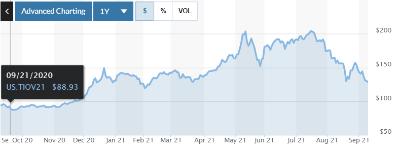

RFguy Posted September 10, 2021 Author Share Posted September 10, 2021 Iron Ore prices the past 12 months have sent the steel for hangars cost skyrocketing. But its back on its way down Futures market price for Jan, feb March is back down at $120. 1 Link to comment Share on other sites More sharing options...
