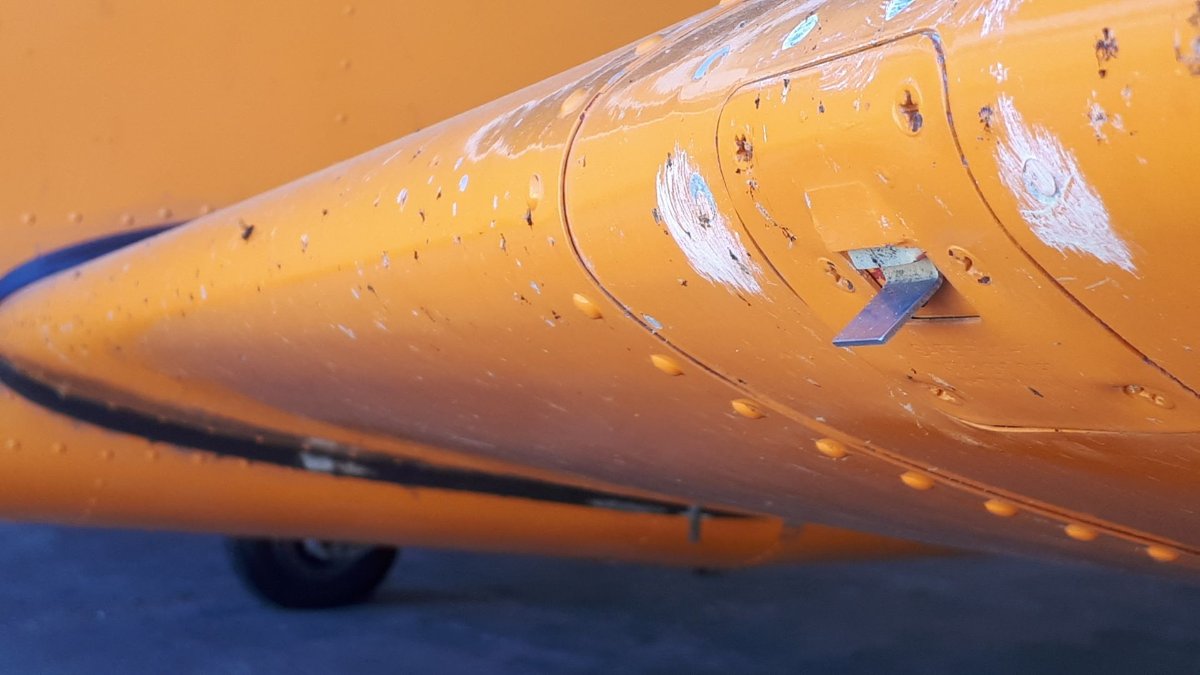

Thruster88 Posted October 22, 2021 Share Posted October 22, 2021 A simple angle of attack stall warning system. Works at any airspeed. Works while being distracted by birds.😉 This is old technology so it is probably shit. 3 1 Link to comment Share on other sites More sharing options...

facthunter Posted October 26, 2021 Share Posted October 26, 2021 The Cessna type stall warning is quite effective. I've flown on it when I had to. I don't like generalisations being made about any group because you will be wronging a significant number of good operators if you do.. A basic plane doesn't need a complex set of instruments and at some stage you will be distracted by some of them, when your eyes should be better used outside.. Unintentional stalls? How many of them do you think you can get away with? The answer may be NONE. Nev Link to comment Share on other sites More sharing options...
F10 Posted October 26, 2021 Share Posted October 26, 2021 1 hour ago, facthunter said: The Cessna type stall warning is quite effective. I've flown on it when I had to. Yes I’ve always thought this Cessna type to be a very effective yet simple stall warning. Paul’s UTube clip was interesting. One of the big dangers to the base leg stall is the fact that the stall symptoms are masked by the fact you are descending, so the wing loading is reduced. With reduced wing loading, stall speed is lower. for example, If you fly a bunt type manoeuvre, you can fly the aircraft, under control at well below the basic stall speed. Just don’t pull back and load the wings, it will seem to stall immediately. So in the descending base turn, with low wing loading, you will feel no buffet, indeed, flaps may have altered downwash so root stall buffet now misses the tail plane. You will not see a high nose attitude, controls will feel sloppy, but at base and final approach speeds, the do anyway. So, it all looks ok….but just apply a bit of back pressure (wing loading) to tighten that base turn, to avoid flying through centreline…and all hell breaks loose! If you do stall, “go for the ground”, on recovery, what I mean is, give the aircraft a chance to recover. Being too enthusiastic to get that nose up and getting into a secondary stall….and you are in deep trouble. 1 Link to comment Share on other sites More sharing options...

turboplanner Posted October 26, 2021 Share Posted October 26, 2021 On 22/10/2021 at 3:08 PM, Thruster88 said: A simple angle of attack stall warning system. Works at any airspeed. Works while being distracted by birds.😉 This is old technology so it is probably shit. Standard on the Cherokee along with the sound warning. Amazing how far you can get into the delaminating state with the aircraft still flying, and the "stalling/not stalling/stalling" as the indicator reacts to temporay buffets.This would be very helpful in a steep turn where you didn't have enough power on. However, this is a very good video and lifetime explanation of what inattention can do, and the thread title is apt. This distraction scenario most often occurs when you start taking passengers, beginning with kids who start pulling knobs to adults who don't realise the concentration needed, and burst out with a question on the base final phase. The risk increases when a passenger wants to take a photo and directs you into tighter and tighter turns; they have no undestanding of how an aircraft flies. It multiplies with a four seater with kids being sick and people telling you to slow down while they attend to them etc. A good book when you've just got your Certificate/licence is Paul A. Craig's "The Killing Zone" which gives similar examples to the hawk distraction that Paul Bertorelli explained. Link to comment Share on other sites More sharing options...
