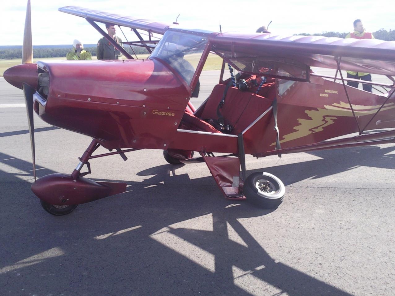

Over the fence the guy got the nose a little flat for my liking and i urged him to lower it slightly, especially due to the gusting wind. Id no sooner said that when the airspeed went from 60 kts to sweet bugga all. I was watching it when it happend, and we literally fell from about 15 feet onto the runway, full power was applied before we touched down but it was too late. We impacted hard. Real hard. The pilot still ahd the stick right back and the acft pitched up to what felt like a vertical climb position. I used alot of strength to push the nose back over and managed to unbreak the stall before a second impact. On the climb out i realised the right undercarriage was resting just below the wing strutt. After a further look i realised that the undercarriage leg was bent quite badly. I asked the pilot to look at the wheel on his side, he said it was fine "why?"
lol...I said well that makes at least 1 good wheel we have.
It took a few moments to dawn on us both that we were gunna have major problems getting it down on the ground.

In the flare I added power to try and minnimise the touchdown speed and landed on the good wheel, which slowly sunk into the same broken position the other one was. After a long slide we came to a stop on the tailskid and what was left of the mains. Evrything off and we were out in a flash.

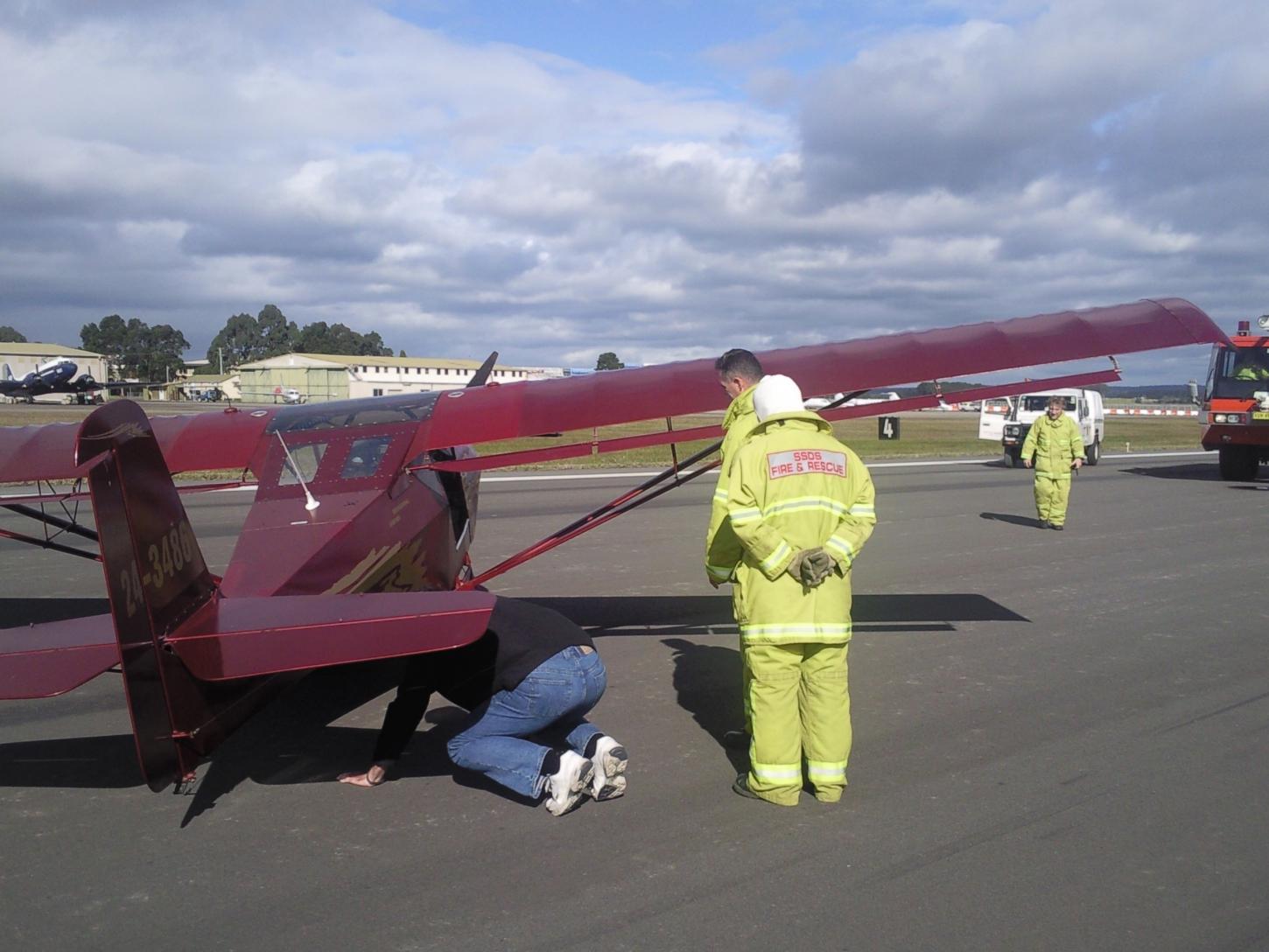

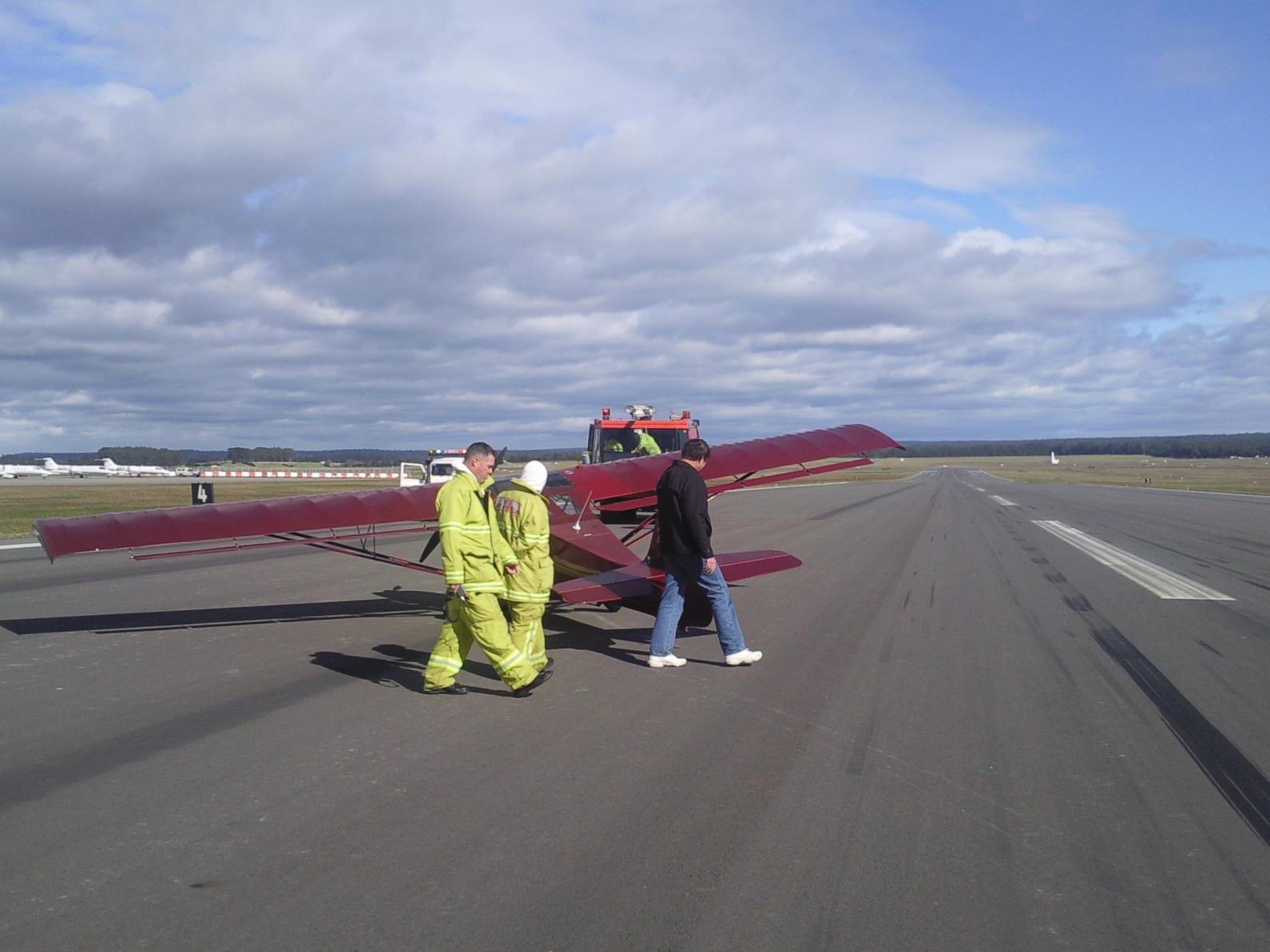

The fireys were exellent. So were the the guys from 817 squadran, all pitched in to help us out, and get the gazelle clear of the runway and on a trailer.
Good Job fella's, much appreciated.
Pretty sure the Gazelle's had it, a quick look over by our L2 confirmed things have moved and twisted a bit.

Also those pilots flying Gazelles, make sure that your planes landing gear is ""Regularly"" inspected ""INSIDE"" the covers on the rubber blocks. They are fairly hard to inspect casually. you have to drill out the rivets to move them a little bit to actually see inside. The steel rods come away from the rubber and you,ll have a collapse that will look just like the pics earlier. They are not a long wearing item.
