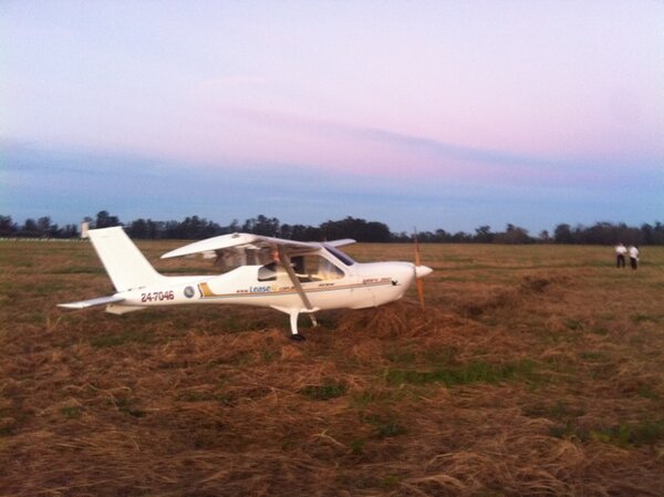

Camel Posted April 14, 2012 Share Posted April 14, 2012 http://m.smh.com.au/victoria/plane-flips-as-it-crash-lands-20120414-1wzrx.html http://www.sunraysiadaily.com.au/ Just saw on TV, ABC 24 news Link to comment Share on other sites More sharing options...

Guest Maj Millard Posted April 15, 2012 Share Posted April 15, 2012 Yes, but does the nose-leg have to fail everytime they need to do an outlanding, as is often the case, and often with an experienced instructor flying ?......But yes always nice when all get out ok...........Maj... Link to comment Share on other sites More sharing options...
alf jessup Posted April 15, 2012 Share Posted April 15, 2012 Yes, but does the nose-leg have to fail everytime they need to do an outlanding, as is often the case, and often with an experienced instructor flying ?......But yes always nice when all get out ok...........Maj... Hey Maj, Looking at where it put down i think the nose wheel would have broken off on any aircraft. Alf Link to comment Share on other sites More sharing options...
Guest Maj Millard Posted April 15, 2012 Share Posted April 15, 2012 Well reviewing the photos again you may be correct, and he may also have tangled with a nastly looking fence. However there have been more than a few incidents where nose legs have failed on landing, also putting the aircraft on it's back. One a few months back at Ayr on a smooth grass strip..It is certainly not a rare occurance on Jabs............................................Maj... Link to comment Share on other sites More sharing options...
frank marriott Posted April 15, 2012 Share Posted April 15, 2012 Ross The one at Ayr you mentioned was not a nose wheel failure but the manner of landing - would have bent the firewall on a rugged C182. I don't know of any aircraft [nose wheel type obviously] that will cop a heavy nose first landing. I don't know about others so I cannot comment about them. FrankM Link to comment Share on other sites More sharing options...
planesmaker Posted April 15, 2012 Share Posted April 15, 2012 My question is 'What caused it to need to put down in a paddock? engine failure perhaps? More info please? Link to comment Share on other sites More sharing options...
Geoff Posted April 15, 2012 Share Posted April 15, 2012 It appears to have a sticky intake valve and that's only hear say Link to comment Share on other sites More sharing options...
