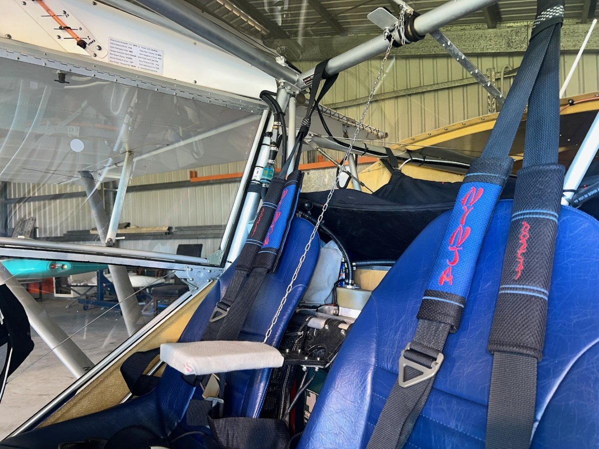

Just completed an enjoyable trip from Palmyra at Mackay to Longreach, then Charleville, then Roma and then home to Palmyra.  Total flight time was 11.3 hours (engine hobbs) over 6 days.  OAT was down to 6 at times so ordering a cabin heat unit from UK today so better prepared next trip.  Had gloves but thin socks and light sport shoes so a bit cold, however not unbearable. My wife Sandy enjoyed the trip.  Also the armrest I have been using over the last year is very comfortable and worked great and is better with the chain to adjust the height / angle (Firm feel, no springiness the cord made) it is turned up and away for takeoff and landing.

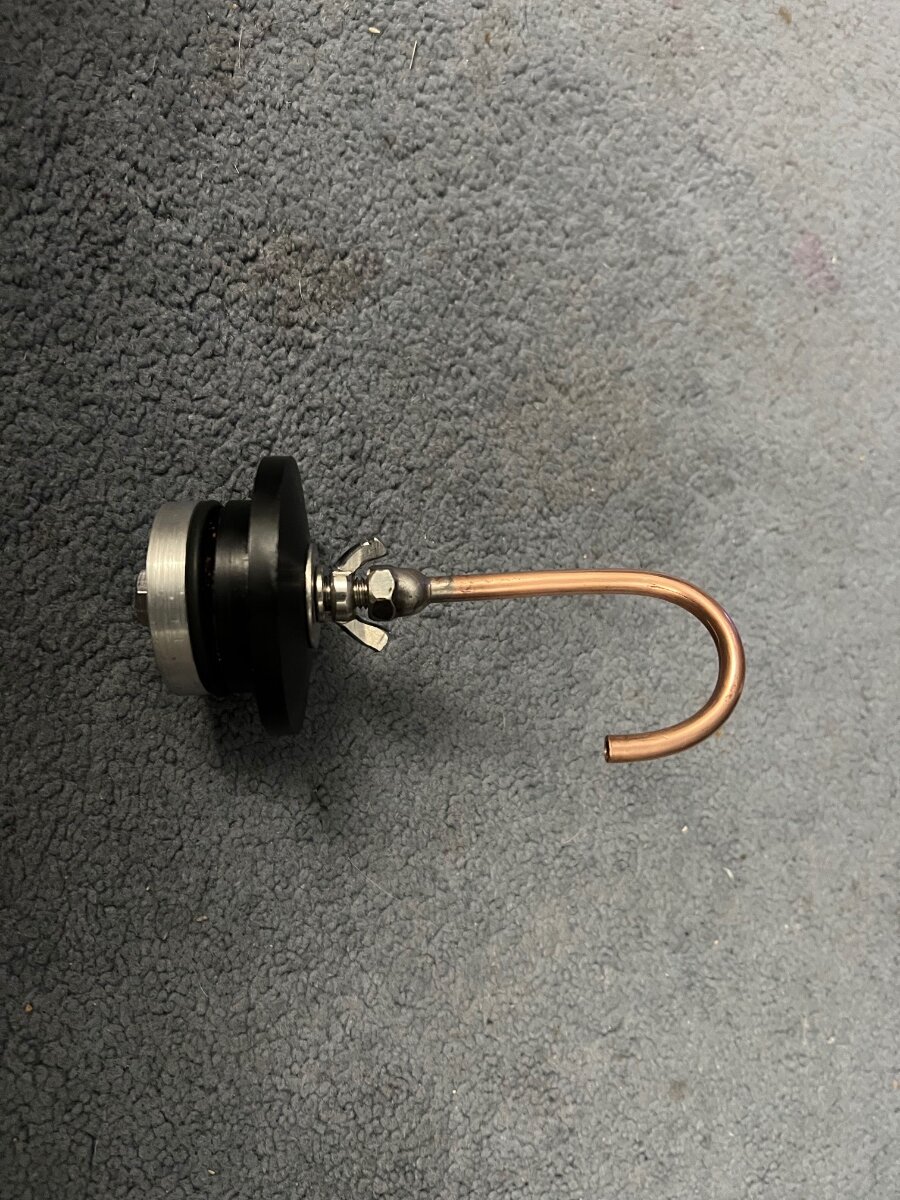

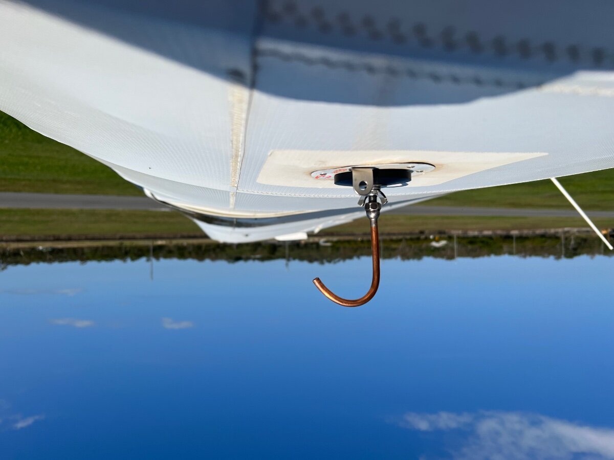

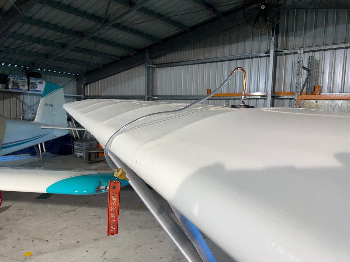

Fabricated a new style vent to trial in my wing tanks. Have completed one as a trial / proof of concept (it’s a spare that a mate gave me). Drilled a 3.5mm bore in the bolt on a mates lathe today so now ready to fit to one tank and give it a tryout.

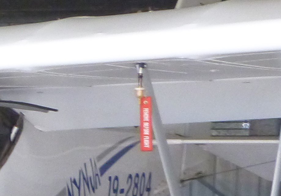

Noice! Make sure you carry a plastic cap for the vent tube to stop the mud-dauber wasps. I think CASA say it only takes 20 mins after landing for a mud-dauber wasp to block an opening.
These are my covers that prevent the mud wasps.  (There is a mud wasp build on the end of the pitot cover.)

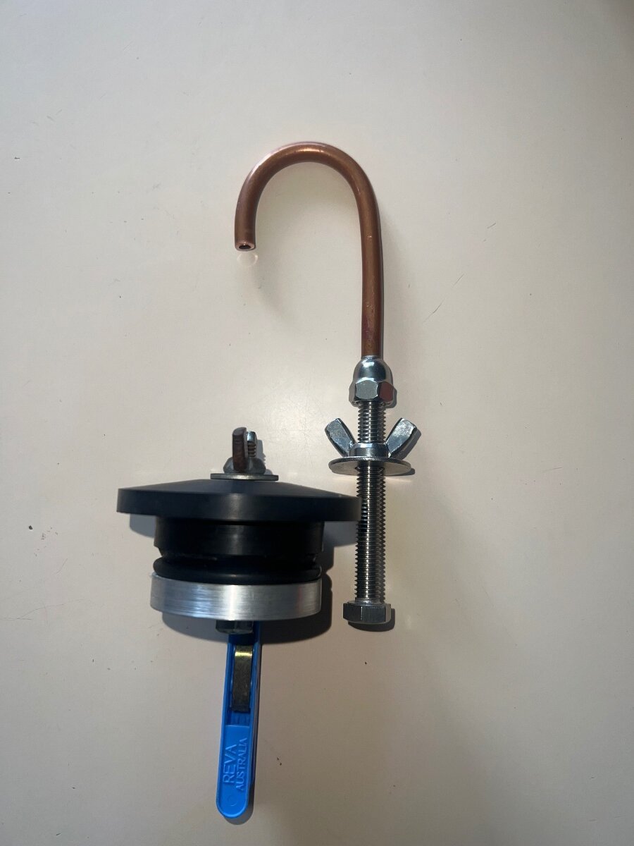

I think Mike they need to be more forward in the airstream. Like they are they will act like a vacumm sucker and possibly draw fuel out there will be no positive pressure going into the tank.
  • Informative 2
8 hours ago, Kyle Communications said:
Like this
773666588_IMG_2337copy.jpg.4779bbc791648dddddd3fa3443c9df2d.thumb.jpg.12cb4243f17681092f17f118a47f0a8e.jpg
Thanks Mark I'll take some of the bend out; appreciate the information.

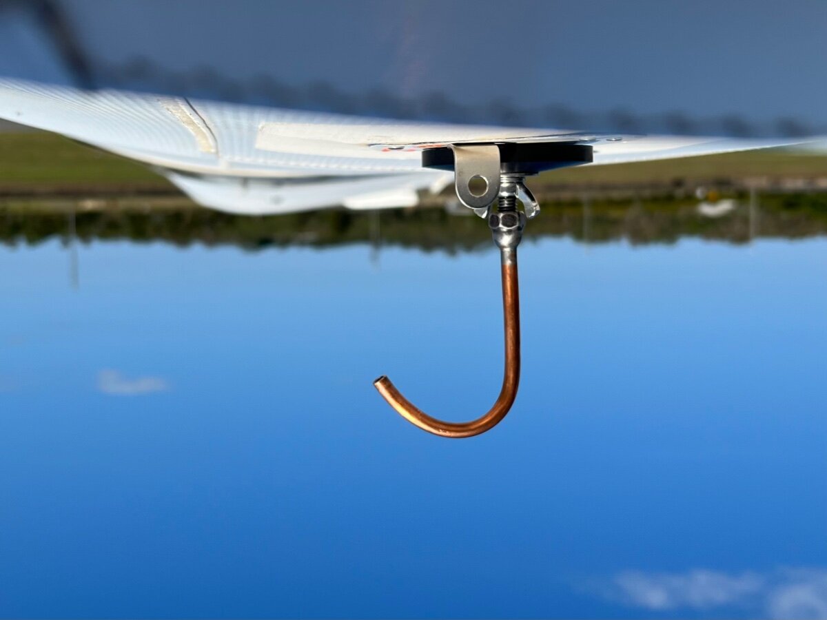

On 28/7/2025 at 9:20 AM, Kyle Communications said:
Like this
This is how I rebent the tube ends into the airflow flow. Worked well today so will fly agin to trial the fit up over the next couple of weeks, before doing the other filler cap. Thanks for comment Mark.
