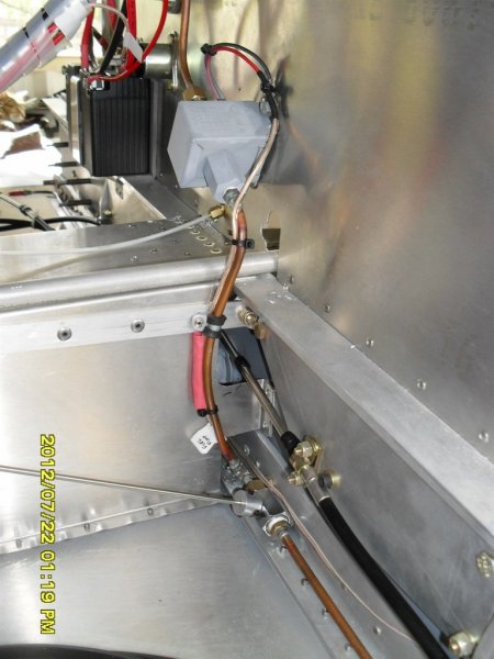

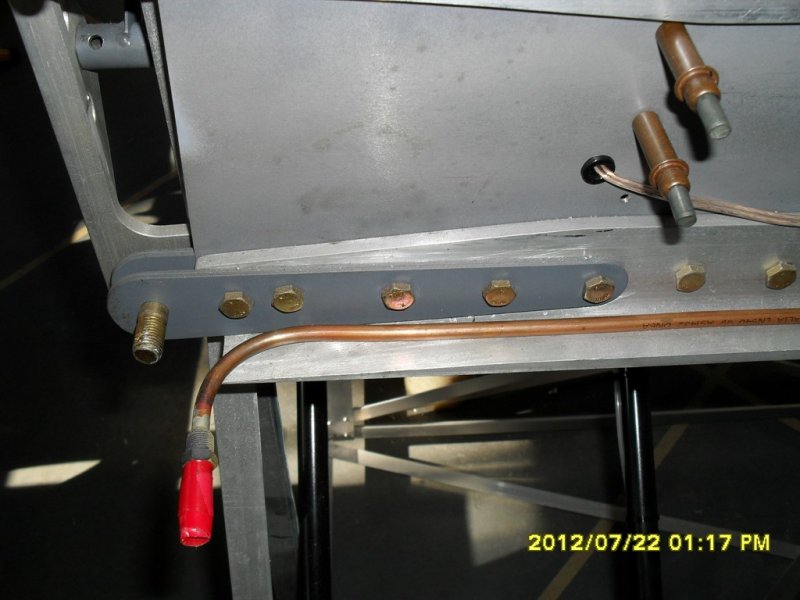

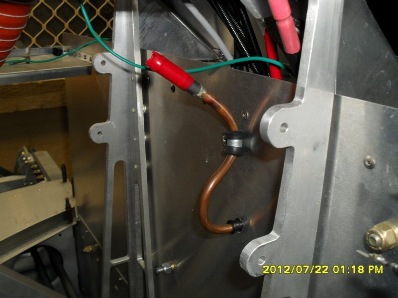

I've attached a couple of pics of my fuel lines in case they might be helpful to anyone - the red insulation tape is covering the brass barbs and blocking the fuel lines to keep ants and wasps out.
