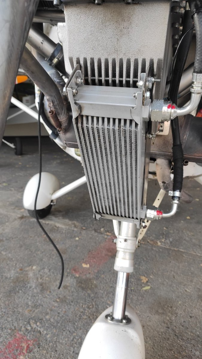

I am looking for solutions to the questions of my Storch HS Jabiru 2200A (Jab sn: 3823) powered UL airplane, purchased within a year, in barely used condition. I welcome any experience and suggestions. I have heating problems with the cylinder heads (which I may be able to control slowly by cutting out some radiators) but the oil is not so easy to handle. Because of these, the plane is normally unusable. I can only fly it for short tests. With a load of around 2000 RPM, it does not overheat according to the tests, but this is not enough even for the 0 vario. When taking off, I can spin at max speed for about 1.5-2 minutes, which allows me to reach 200-230m, so it would not be suitable for takeoff at a foreign airport on non-flat terrain. The club has a slightly older edition of a similar Storch (Jab sn: 1653) and I started to compare, but this question just kept me going.
The old ones have a cooling fin on the oil pan. What could be the reason why, if this type has heating problems (as I often read), why does the manufacturer reduce the cooling surface?

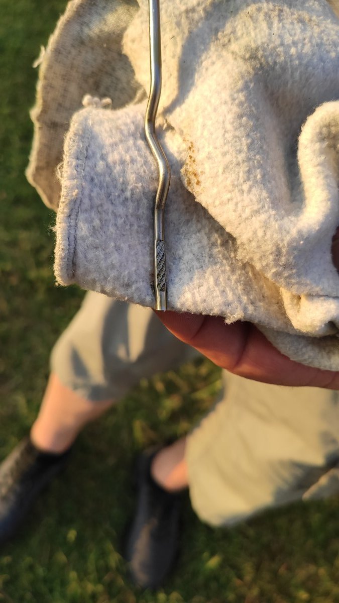

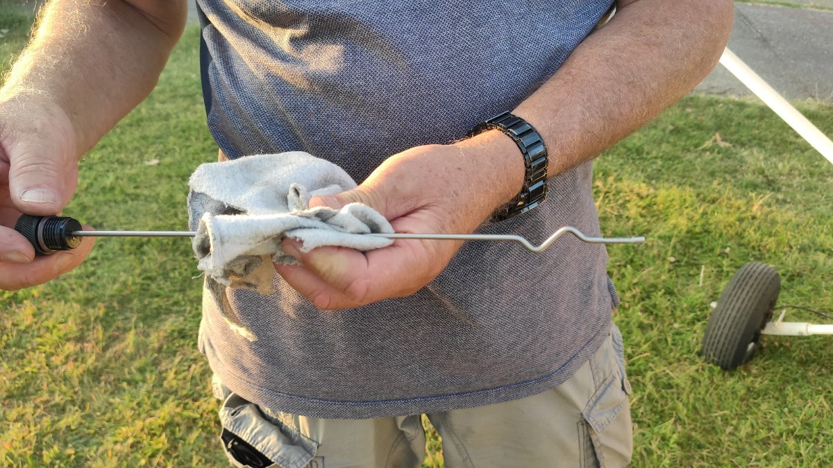

The new one has a steeper front of the turtle and even the oil dipstick is different. That's why I can't decide on my own whether the Z deformation on the stick is the level indicator or the cross-ribbed part below it? (attached picture) Unfortunately, the length of the rod in the other engine is also different.
The oil cooler on the colleagues' machine also had to be replaced (due to heating, with a larger one), but they also had to adjust the engine compartment cover. Unfortunately, I no longer know the type of cooler, and I would like to receive offers on what I should replace, perhaps so that the Storch engine compartment cover does not have to be plasticized, at most cut out a little?

Looking at your photos link:
The very first thing I see is that your oil cooler was not the one supplied by Jabiru for that age of engine. My own engine is 130 on by serial number from yours. Your cooler is nothing like the one Jabiru supplied back then. I have 550 hours and near 18 years on mine (not in the same type of airplane).
The cooler supplied by Jabiru back then was a small generic automotive transmission cooler with 5/16" (8mm) auto transmission hose.
One of your hoses looks to be way bigger than the other. Hoses are also different to each other.
Your installation is not "by the book." Some may say "so what? - it's just an oil cooler."  I say you're on your own when deviating from the Jabiru manuals and instructions. What you have there is not standard. I have seen a few non-standard installations go bad, big time. That's all I have to offer.
The more alarming thing I see in a photo of your propeller hub is the use of mixed and incorrect length bolts and nuts - some nuts are short, some are long, some nuts have no bolt thread showing. Silver nuts? They certainly are not the supplied standard AN hardware. I presume they are metric hardware? Fitted to a 1/4 inch imperial drilled prop hub?
