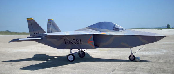

Hi guys
I was surfing the net for kit planes as a lot of us do and found this little gem I LOVE IT !
The name of the kit is" SF-1 Archon Aerosports gr"
I think I have attached a pic and he is a cockpit vid'
Please someone build one and let me know what it's like :}
here are the specs'
Wing Span : 7.25 m
Length : 8.00 m
Height : 2.20 m
Net Weight : 205 kg
Gross Weight : 300 kg
Fuel Tank Capacity : 45 lt
Engine Type* : 40-130 hp
Propeller Diameter : max. 1,60 m
Stall Speed : 65 km/h
VNE : 210 km/h
VNO : 180 km/h
VA : 155 km/h
VFE : 110 km/h
Load Factor : +4 -2 G
Take-off Distance : 200 m
Wing-detach Time : 30 min.
*The standard engine mount is for the Rotax 503, 532, 582 engines.
Estimated build time for the SF1 Archon kit is about 500 hours
Can't find a price.
Cheers
Rick {sorry still laughing at it, but I want one !!! }
I just notice the engine type that can be fitted 40 to 130hp , big difference between the two?????
the 4ohp must just float you around just above stall speed.

Looks like it would handle a water landing OK (if the gear was retractable). Getting in must be a bit of a mission with no visible steps etc especially for old buggers like me. First ever stealth ultralight.
Guest Howard Hughes
Seen the vid couple months back and loved it. I bags call sign " Maverick" Lol
We all know Viper was the best pilot! ;)
I just love the irony of how it would be described as compared to how it looks....
LOOKS; Single seat jet fighter in appearance.
DESCRIPTION; Fixed undercarriage, strutted biplane, twin boom pusher!
If you find the right videos, you can see down the intakes and realise the bottom of the fuselage/intake area is actually another wing with a pusher engine driving an normal size propellor that protrudes below the fuse (a little) behind the top and bottom wing trailing edge.
The sides of the 'intake' area become a pair of booms either side of the prop, with the two fins and the tail mounted at the end.
All in all a bit clever to give it the appearance it has.

Except the sound and lack of speed it is cool, and since it is alloy can be polished and painted for great drool appeal.
It appears to have a great view forward and to the sides and down for its type. And looks to have plenty of lift appears stable in the vids.
But more speed, retracts, higher g loads etc would be better.
But that may be possible with a few changes by the designer/builder in greece. It would have been designed for the euro 300kg rules but given it has a hp range up to 130hp stated he may have in mind a faster better suited to our rules version.

I found this aircraft video a little while ago. If you go through the videos, look at the construction carefully. It's not the best finishes...look at the angles in the inner wings for example.
How would you clean up some of that?
Yeah, I've looked closely, and it's a bit rough, but still not a bad effort for (probably) an amateur.
One assumes the kits have been tidied up a bit?
It does make a good starting point for improvements like a decent bubble canopy and maybe retracts, followed by balancing of the controls (watch the elevator bouncing while taxying), and better flaps, and maybe do away with the struts.
I agree that it could be tidied up considerably with just a bit more attention to detail in the build, and those bits you mention would be lovely, but most of them are unnecessary, just aesthetic improvements for could be an inexpensive 95:10. I guess a lot of the expense could be cut if you blew your own canopy and designed and fabricated retracts, but would just blow the price out if sold as a kit.
