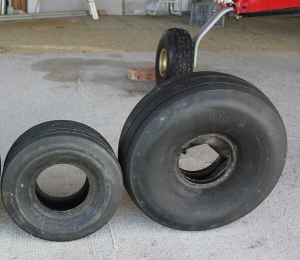

M61A1 Posted February 9, 2018 Share Posted February 9, 2018 M61A1, Do you have spats, if so, do they fit ok? ...I`m interested you say you`re taking off and landing 10 kts slower than before, what do you think is the reason for that?Frank. No spats Farri. The reason is a massive change in the AoA as it sits on the ground. Previously it sat almost flat so there was insufficient AoA to get flying under 55kts, same when landing...if you arrive at an angle where you can fly at 45 kts, (and will easily fly at that speed) the tail wheel will be running down the runway and the mains still well in the air. Makes little or no difference once I'm airbourne, just enables me to get it off and on at a lower speed at a higher AoA. 1 Link to comment Share on other sites More sharing options...
farri Posted February 9, 2018 Share Posted February 9, 2018 A new Mixmaster burning up 3 mins after you turn it on, is not really a major health and safety issue - unless you happen to be electrocuted, or burnt by it - which is reasonably rare.However, buy a counterfeit, sub-standard safety or aviation-related item, that has not met any stringent QC, testing, or standards, could definitely cost you your life. You`re absolutely correct! I thought that was obvious without me pointing it out! Probably shouldn`t have posted about a mixmaster. 1 Link to comment Share on other sites More sharing options...
farri Posted February 9, 2018 Share Posted February 9, 2018 The reason is a massive change in the AoA as it sits on the ground. Previously it sat almost flat so there was insufficient AoA to get flying under 55kts, same when landing. I have the 6.00x6 mains and the 200 pneumatic tail wheel. If I don`t hold the Drifter on the ground I`m off the ground just above the stall speed. If you`re Drifter has an MTOW of 400kg, the Take Off Safety Speed (TOSS) is 50kts, with a Stall Speed (Vs) of 36kts at MTOW, therefore, at 55kts the AC would have been well above flying speed. Flying speed and distance before getting airborne are two completely different things, the AC can be held on the ground well above flying speed. Frank. Link to comment Share on other sites More sharing options...
M61A1 Posted February 9, 2018 Share Posted February 9, 2018 Mine has 450kg MTOW. I've been looking at your pictures trying to see if there's any difference in rigging. It's hard to tell, but your wing looks as though it might have a slightly higher incidence, but the fuselage sits fairly flat like mine did. Using some fairly dodgy measurements of your pics, it looks like the vertical tube at the aft spar on mine may be longer than yours. Link to comment Share on other sites More sharing options...
farri Posted February 9, 2018 Share Posted February 9, 2018 Mine has 450kg MTOW. Thanks for that, I knew about the increase to 450 kg MTOW but never knew why they did it and didn`t ever bother to find out! I remember wondering at the time if they`d only increased the MTOW figure to allow for a larger nose pod, the 582 engine and underbelly fuel tank or if they`d actually strengthened the airframe. So what is the Stall Speed and the Take Off Safety Speed, please? The figures may be different but the principle remains the same! Link to comment Share on other sites More sharing options...
M61A1 Posted February 9, 2018 Share Posted February 9, 2018 Stall speed at MTOW is about 38kts indicated, pretty close to the POH for the strut braced version. I can find no mention of a Take Off Safety Speed, but I generally stay in ground effect until around 55kts. Yes the A582 airframe has a few structural reinforcements, in the landing gear. the horizontal stabs and the spars as far as I know. 1 Link to comment Share on other sites More sharing options...
JG3 Posted February 12, 2018 Share Posted February 12, 2018 No spats Farri. The reason is a massive change in the AoA as it sits on the ground. Previously it sat almost flat so there was insufficient AoA to get flying under 55kts, same when landing...if you arrive at an angle where you can fly at 45 kts, (and will easily fly at that speed) the tail wheel will be running down the runway and the mains still well in the air.Makes little or no difference once I'm airbourne, just enables me to get it off and on at a lower speed at a higher AoA. I've built a 95.10 that I call my High Clearance Trail Bike. The wing is Drifter skins on my strut braced frame, so essentially the same as a Drifter wing. Bottom surface 12.5 degrees in three point attitude. Weight is 184kg so it's heavier than a pre-cert. When holding the tail wheel on the ground, it leaps off at 33kts indicated, landing pretty much the same. Flies just fine at that speed, and of course hold down in ground effect and the speed quickly builds up to 50 for a good safe climb. Sure is great for STOL ops off rough ground..... A lot of Drifters sitting at that flat stance on the gear give up a whole lot of STOL capability.... I'd like to see a Drifter with motorbike wheels on the mains to increase the three point attitude. Probably small trail bike wheels would be tall enough to give the right attitude. Sure would look cool.... Would have to machine hubs or adapters to mount on the stub axle, but not a big problem. Might even be able to use motorbike caliper brakes.... 1 3 Link to comment Share on other sites More sharing options...
