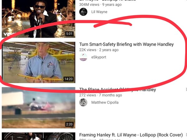

Bennyboy320 Posted January 12, 2019 Share Posted January 12, 2019 Here’s a great video that talks about both skidding & slipping turns in the stall, explains the aerodynamics of why as well as an actual demonstration of which wing will stall first. 1 Link to comment Share on other sites More sharing options...
