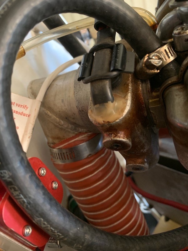

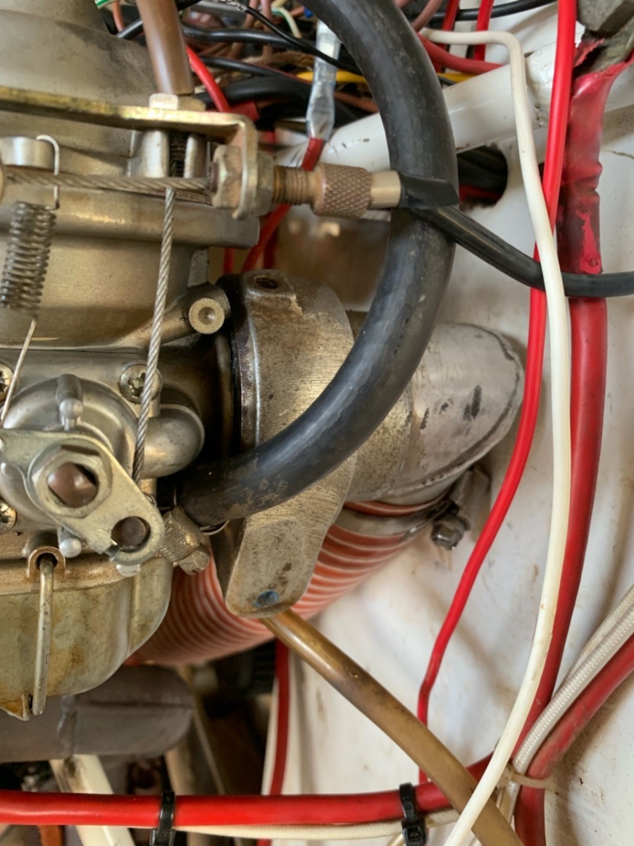

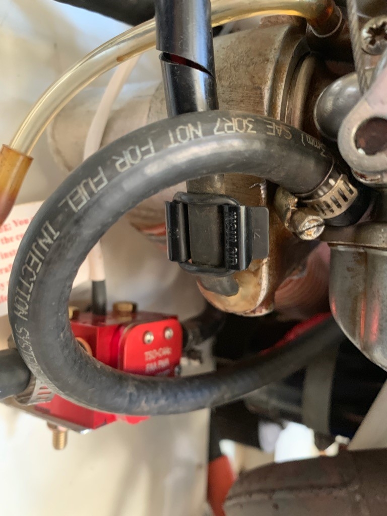

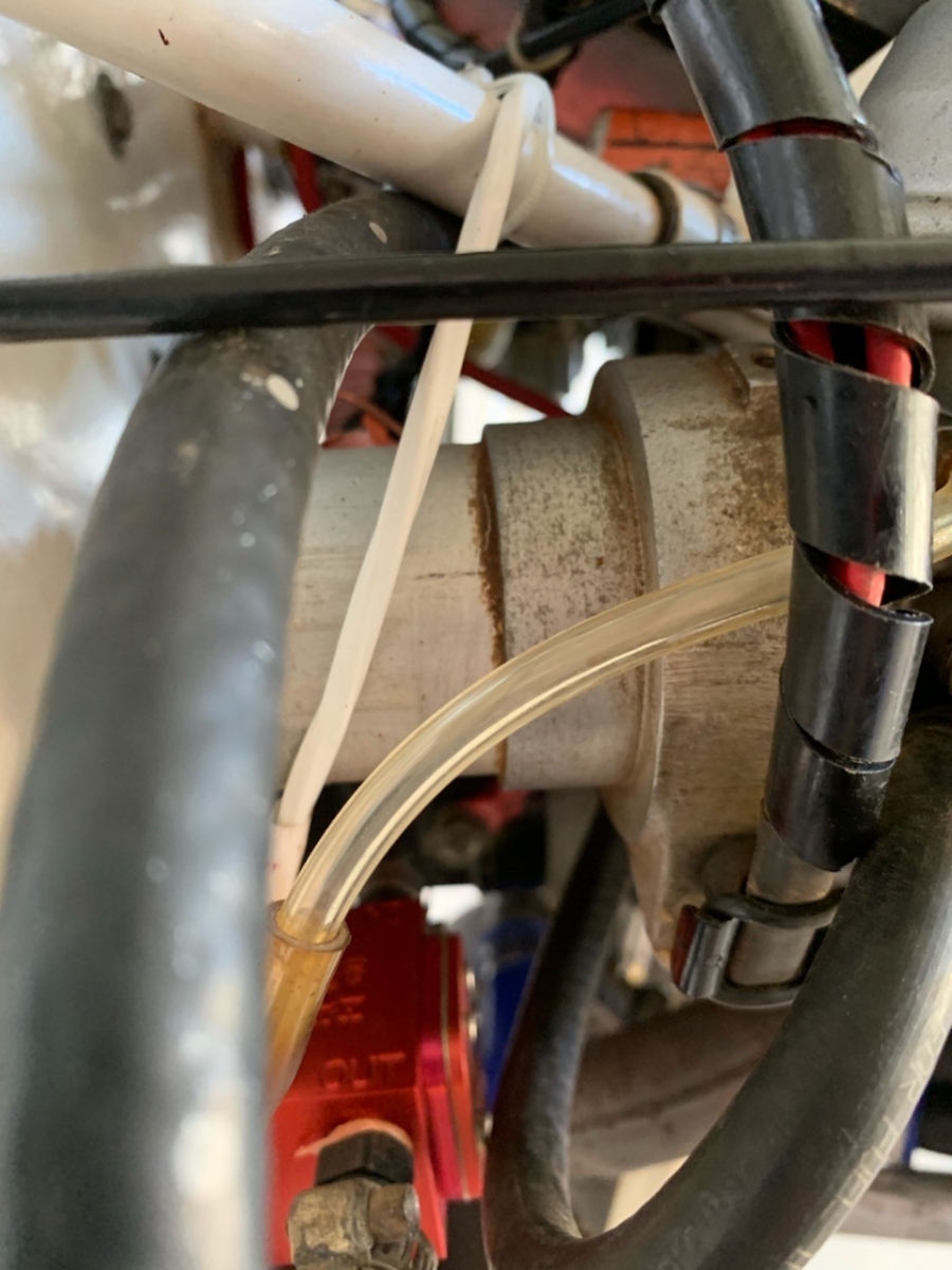

Blueadventures Posted February 13, 2019 Share Posted February 13, 2019 Hi A friend is doing some maintenance to a Rotax UL (80 hp) installed on a Lightwing. He is asking for any details on the attached carby heater unit; wiring details etc. He said it was wired into the ac wires (Yellow) that go from engine into the rectifier regulator. He would like to know if it can be wired direct via a switch and fuse to 12 Volt DC or if it must connect to the yellow wires (ac). Any advice is appreciated by him. Link to comment Share on other sites More sharing options...
Downunder Posted February 13, 2019 Share Posted February 13, 2019 I've not seen one using the ac power before. The ac output is about 25 to 40v, depending on rpm. The good thing I guess is that it is pre regulator so not loading that system up? My (non electrical) opinion is you probably wouldn't get the same heat with 12V...... 1 Link to comment Share on other sites More sharing options...
scsirob Posted February 13, 2019 Share Posted February 13, 2019 From the pictures it looks like it is on the input side of the carby. That makes no sense. No amount of available electric power on that side will significantly raise the input air temperature enough to avoid carb ice. There's other electric carb heaters producing about 50W that attach to the butterfly side where it may help a bit, and they are hardly effective. I'd opt to remove this pre-heater contraption and find a way to install proper hot air carb heat from near the exhaust pipes 2 Link to comment Share on other sites More sharing options...
Mewp Posted February 13, 2019 Share Posted February 13, 2019 I wonder if it is trying to heat the carb body close to the venturi and not the air passing through. 1 Link to comment Share on other sites More sharing options...
facthunter Posted February 13, 2019 Share Posted February 13, 2019 IF you keep the carb body above freezing it won't have any ice forming on it. The advantage of electric it's not dependent on the engine being hot, and it doesn't cause significant loss of power. You can just have it on anytime the plane is in use AC or DC doesn't matter with a heating element. Nev Link to comment Share on other sites More sharing options...
skippydiesel Posted February 13, 2019 Share Posted February 13, 2019 Problem with posting pictures is that people like me see them and make uncalled for comment - Apologies in advance no offence intended- What looks like the left carbi throttle cable is badly damaged & rubbing against the fuel pipe. You may have different throttle opening/closing characteristics between carbi's (out of balance) The float bowls look stained with petrol residue - are the gaskets leaking? Most of the tubes, cables, wires in the photo's are not adequately secured against vibration/movement/abrasion. Ordinary hose clamps have been used to secure the fuel lines to carbi spigots - use fuel injector clamps or similar even pressure/non crimping clamps. Carbi air vent lines look distinctly non standard Sorrrry! 1 Link to comment Share on other sites More sharing options...
