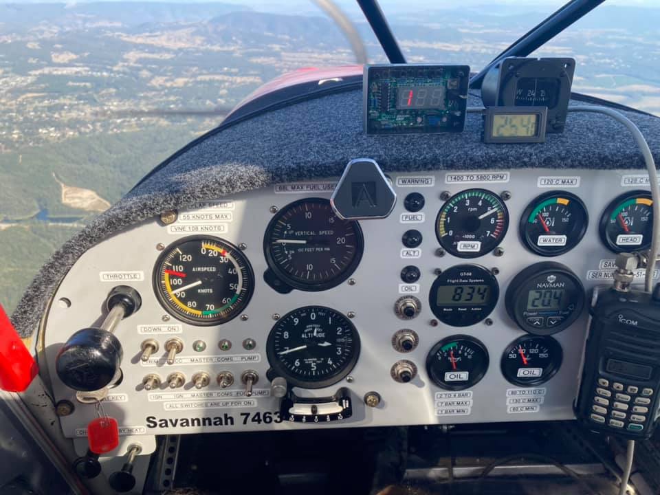

Kyle Communications Posted September 7, 2020 Share Posted September 7, 2020 Well I never thought I would see the size of these improvements to be what they are. When JG did his first prop tests there really wasnt much between the props but I think you will see a pretty dramatic jump in the data. The guy with the trike has got his prop now and I look forward to seeing his numbers as it being a pusher. Interesting that Eprop recommend he run a extension to get the prop further away from the engine as the airflow past the engine on a pusher is quite disturbed and you get a good benefit from the prop being further away. Danny did some further testing today in tandem with another aircraft that has his ASI well calibrated as the sav with the crappy static port often doesnt give a true reading so to confirm the readings he had he matched the speed with Roger at 5200 rpm in cruise he is doing 92kts in level flight as the picture shows and Danny can get 5500 rpm at WOT in flight...That is incredible for a VG Link to comment Share on other sites More sharing options...
Cosmick Posted September 7, 2020 Share Posted September 7, 2020 TAS usually increase 2% ea 1000' so at 2700' 92kt IAS, TAS would be up 5.4% = 97kts. (just saying) Link to comment Share on other sites More sharing options...
Kyle Communications Posted September 8, 2020 Share Posted September 8, 2020 With my 72 inch Bolly on The Girlfriend all I could get was 97kts at 5600 WOT in flight indicated and I used to get very consistant 85kts at 5000 rpm for cruise....that is a major difference Link to comment Share on other sites More sharing options...
