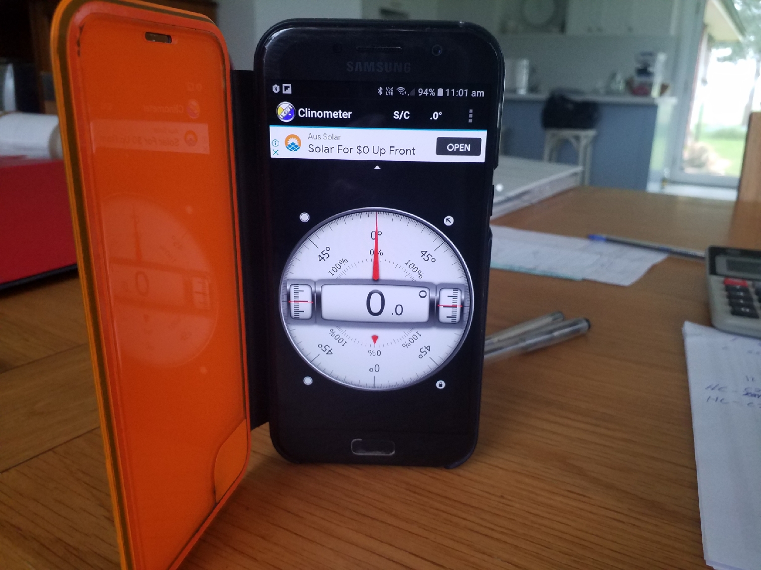

Thruster88 Posted June 23, 2020 Share Posted June 23, 2020 For anyone setting or checking propeller pitch the clinometer app on a phone is really quick and accurate. 1 1 Link to comment Share on other sites More sharing options...

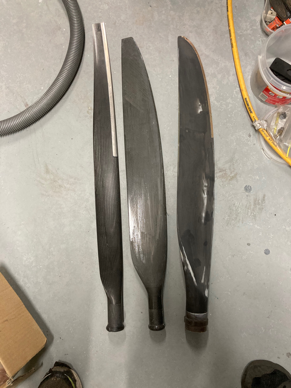

Kyle Communications Posted June 27, 2020 Share Posted June 27, 2020 I meant to post this the other day...prop comparison..left is the Eprop then a Bolly then a Warpdrive 2 Link to comment Share on other sites More sharing options...

eightyknots Posted June 27, 2020 Author Share Posted June 27, 2020 I meant to post this the other day...prop comparison..left is the Eprop then a Bolly then a Warpdrive [ATTACH=full]54350[/ATTACH] Bolly and Warpdrive propellers are clearly much 'chunkier' than Eprops. However, the additional length of the Eprops could be a bit of an issue with off-field aircraft like the Savannah. Link to comment Share on other sites More sharing options...
Kyle Communications Posted June 27, 2020 Share Posted June 27, 2020 No those are the short props they are 68 inch from memory The Eprop is the recommended size it is the DUR-3-175-C4-T which is just under 69 inches . The hub diameter is where the difference is in the overal diameter. The bolly I had on the girlfriend was the 72inch but in actual it was a 70 inch Link to comment Share on other sites More sharing options...

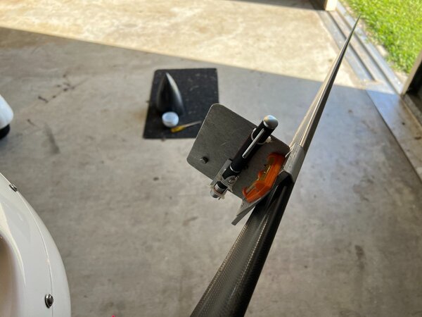

Kyle Communications Posted June 27, 2020 Share Posted June 27, 2020 I am not sure if Danny has one in his aircraft. Dont really need one unless you have a CS prop or turbo. Interesting is the setup...initial blade setting is 25.1 deg and on the ground the prop should be pitched to produce 5500 rpm on the ground...certainly different to most other props. We will know by the aircraft performance..so it will be a objective view but the Sav is such a draggy aircraft but super consistant in speeds and take off and climb numbers..will see if there is a change Link to comment Share on other sites More sharing options...

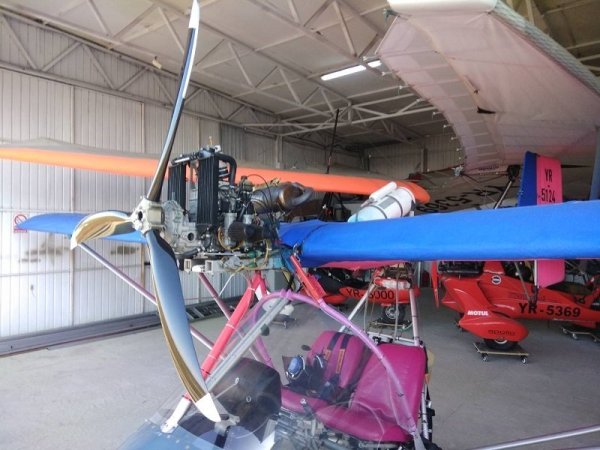

M61A1 Posted June 27, 2020 Share Posted June 27, 2020 Are you sure the R/H one is a Warp Drive? I've not seen one like that. I've only ever seen these types.... https://warpdriveinc.com/propeller-components/ 1 Link to comment Share on other sites More sharing options...
Kyle Communications Posted June 27, 2020 Share Posted June 27, 2020 UMMM I think it is..they were over at Dannys place the other night so took a pic to compare...maybe a Neuform as I know he has one there too Link to comment Share on other sites More sharing options...
skippydiesel Posted June 27, 2020 Share Posted June 27, 2020 Props are a bit like dresses - length, cut, etc changes with the fashion - always being (re) invented. I am perplexed - Rotax 912/914 have relativly (to LyCon & Jab) slow revving props. Without any training / verifiable knowledge, it would seem to me that broader/paddle like props would likely be the best in this application BUT here we have a long thin skinny thing doing the job. Perhaps this is why 3 blades are recommended and set to quite a course pitch. On another allied point - do broader blades make for quitter operation ? Link to comment Share on other sites More sharing options...
Kyle Communications Posted June 27, 2020 Share Posted June 27, 2020 One of the big plusses about the Eprop is apparently everyone says its a lot quieter than any other prop..also less vibrations produced as well. The thin blade at the tip givees you slip on takeoff so you can develop all the horsepower of the engine...this is what I am told...I am not across this indepth theory..the main part of the blade has quite a undercamber and a good constant helix in it...All I can say is it must work as they are certainly stirring thepot in Europe and there literally are hundreds of reviews posted by people who have changed to them and I havent seen one review that says they would not change it back to anything they had..some see a big speed improvemt some not so much but they all say its far quieter and less vibration and also comment that the gearbox doesnt clunk at start and especially shutdown..the whole prop/ hub and spinner only weight 2.5kg...the bolly with the extension and spinner on the Sav is 6.5kg. The normal blades have a lot of drag apparently due to their width..this being so thin in width makes a big difference Link to comment Share on other sites More sharing options...
eightyknots Posted June 27, 2020 Author Share Posted June 27, 2020 One of the big plusses about the Eprop is apparently everyone says its a lot quieter than any other prop..also less vibrations produced as well. The thin blade at the tip givees you slip on takeoff so you can develop all the horsepower of the engine...this is what I am told...I am not across this indepth theory..the main part of the blade has quite a undercamber and a good constant helix in it...All I can say is it must work as they are certainly stirring thepot in Europe and there literally are hundreds of reviews posted by people who have changed to them and I havent seen one review that says they would not change it back to anything they had..some see a big speed improvemt some not so much but they all say its far quieter and less vibration and also comment that the gearbox doesnt clunk at start and especially shutdown..the whole prop/ hub and spinner only weight 2.5kg...the bolly with the extension and spinner on the Sav is 6.5kg. The normal blades have a lot of drag apparently due to their width..this being so thin in width makes a big difference Something I haven't yet read, but expect to be true, is that with the thinner Eprops blades a plane would glide a significant distance further in the event of an engine failure (compared to the broader propellers). Link to comment Share on other sites More sharing options...
dlegg Posted June 27, 2020 Share Posted June 27, 2020 For anyone setting or checking propeller pitch the clinometer app on a phone is really quick and accurate. [ATTACH type=full" alt="20200623_110020(0)_resize_23.jpg]54245[/ATTACH] I use it all the time, great app and very accurate Link to comment Share on other sites More sharing options...
IBob Posted June 27, 2020 Share Posted June 27, 2020 I don't know what they're comparing them with in Europe, but I have a 70" Bolly prop and I'm very happy with it. I have it pitched very accurately, not with a digital protractor, but with a DIY laser projecting from blade to floor. It's a simple system, as accurate as you choose to make it and entirely reliable. At my prop height, 1 degree of pitch = 22mm of light movement on the floor. When last checked all blades were within a 2mm band. I chose this method as I have reservations about some of the cheap digital measuring devices we now have: just because something reads to 0.1degree does not mean it is actually accurate to that. Further, when you try to dig back, there is often no published spec giving accuracy and repeatability.......... I have virtually no vibration and it doesn't start or stop with a clunk either. Link to comment Share on other sites More sharing options...

Kyle Communications Posted June 27, 2020 Share Posted June 27, 2020 Mick that prop on the right side in the pic is a Kiev I chased danny thats what he told me Link to comment Share on other sites More sharing options...
flymate Posted June 27, 2020 Share Posted June 27, 2020 The blade on the right is a KIEV.. Last year, on a CH601 HDS (short/taper wings) with an ULS engine. We went from a Warp Drive 68'', to a Kiev #263 ( 1710mm 67.3'' ) to an E-props Durandal 100 We saw better performance from WD to Kiev and from Kiev to E-props , similar numbers..but the E-props runs smoother , and have a less inertia than the Kiev . Link to comment Share on other sites More sharing options...
