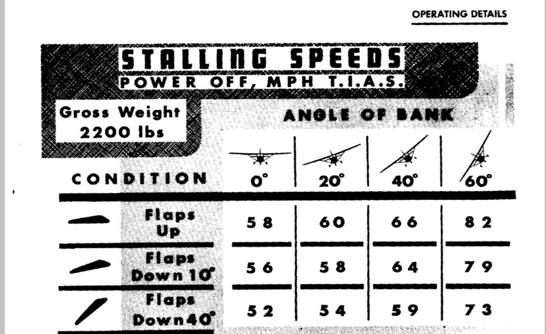

If your aircraft's POH doesn't have a table like this:

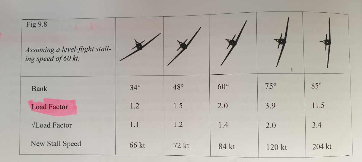

Then use the table below (from Bob Tait RPL/CPL books) to calculate new stalling speeds :
For example in Foxbat A22LS, multiply level-flight stalling speed with the square root of Load Factor.
AoB 34deg 48deg 60deg 75deg 85deg
Vs = 42kts 47kts 51kt 59kts 84kts 143kts
Vso = 32kts 36kts 39kts 45kts 64kts 109kts
Yes, there is much more involved than this (weight, climbing, descending...).
Regardless, for a student learning to fly, these numbers will be sufficient to know.
Add 5kts buffer and you'll be safe.

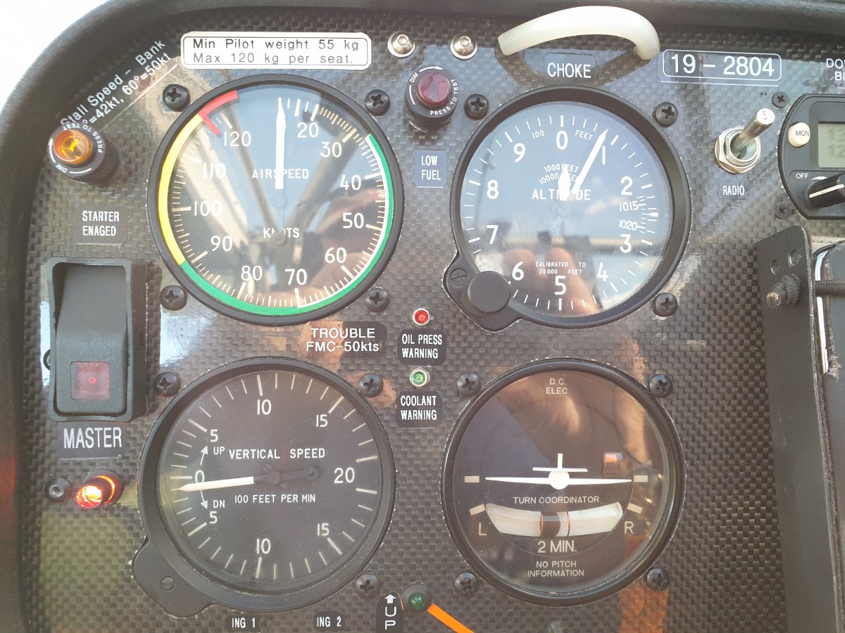

Like, I put a reminder in the top left of my panel, I read to refresh from time to time and know its there; however if ever needed the event will tell its effectiveness.
Having the placard is good. Putting a DMMS (defined minimum manoeuvring speed) line right on the ASI and adjacent panel would be even better. 1.4 x 33 = 46 knots. We never go below this speed until late final. DMMS is also best climb and best glide, the goto speed when things turn to shite and our brains are mush.
Your clean and flap stall speeds are the same?
Yes, to do a blue line.
