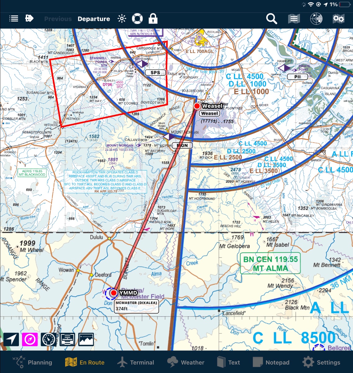

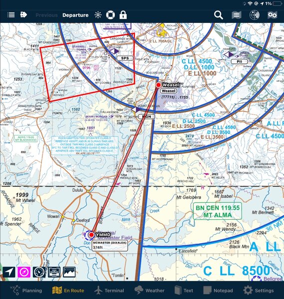

jackc Posted October 25, 2021 Author Share Posted October 25, 2021 Well, I ended up in contact with Brisbane Air Services after being given multiple phone numbers. I was enquiring on information about arrival and departure from my own ‘firebreak’ read airstrip for which I gave the GPS coordinates. Seems I must fly not above 1000 AMSL until I get away from below Class E airspace. Now this gives me an approximate clearance from terrain of 500ft variable for some distance, as my airstrip is 500ft or so AMSL. I am asked why can I not ask for clearance into controlled air space? I told him no go with an RPC….. So, it looks like I am in for some low level flying, like it or not 🙂 Link to comment Share on other sites More sharing options...
RossK Posted October 26, 2021 Share Posted October 26, 2021 Just do long approaches and long finals 😁 you can be under 500ft AGL as long as you are on final or upwind Link to comment Share on other sites More sharing options...
jackc Posted October 26, 2021 Author Share Posted October 26, 2021 12 minutes ago, RossK said: Just do long approaches and long finals 😁 you can be under 500ft AGL as long as you are on final or upwind IF it was that simple 😞 Airstrip at waypoint ‘Weasel’ ……… 23 35.066 S. 150 27.163 E Link to comment Share on other sites More sharing options...

Thruster88 Posted October 26, 2021 Share Posted October 26, 2021 Depart SW and you will be straight into the 2500ft step. Grassroots flying at its finest. Link to comment Share on other sites More sharing options...
jackc Posted October 26, 2021 Author Share Posted October 26, 2021 But what about entering the local Flying School training area D706? Link to comment Share on other sites More sharing options...
Thruster88 Posted October 26, 2021 Share Posted October 26, 2021 13 minutes ago, jackc said: But what about entering the local Flying School training area D706? Any aircraft may enter a danger area. It is a heads up so the pilot is informed about any activity that may be taking place. https://vfrg.casa.gov.au/general/rules-of-the-air/prohibited-restricted-and-danger-areas/ 1 Link to comment Share on other sites More sharing options...
Yenn Posted October 26, 2021 Share Posted October 26, 2021 The class D has changed where you are in the last few years, it used to be D 2500 min. I doubt that any aircraft would be down at 1000' in that area unless they were local. You can fly in class E if you have a transponder, but I reckon your mention of class E was not what airservices were worried about. D is the thing you have to avoid. Do you get access from Webb Rd, I know the area and have a friend who lives there. The country to your East is not suitable for low flying. I have walked a bit of it. Link to comment Share on other sites More sharing options...
RossK Posted October 26, 2021 Share Posted October 26, 2021 Can you not follow the Burnett Hwy west and then climb out under the 2500ft step and then head south? Link to comment Share on other sites More sharing options...
jackc Posted October 27, 2021 Author Share Posted October 27, 2021 34 minutes ago, Yenn said: The class D has changed where you are in the last few years, it used to be D 2500 min. I doubt that any aircraft would be down at 1000' in that area unless they were local. You can fly in class E if you have a transponder, but I reckon your mention of class E was not what airservices were worried about. D is the thing you have to avoid. Do you get access from Webb Rd, I know the area and have a friend who lives there. The country to your East is not suitable for low flying. I have walked a bit of it. Here is pic, Webb Road runs between Nugget Ave and Burnett Hiway (red) Airstrip (green) runs North/South, it’s 1500 ft long. Very slight downhill to North. Height is around 500ft AMSL and 12nm from Rocky airport. Link to comment Share on other sites More sharing options...
APenNameAndThatA Posted October 29, 2021 Share Posted October 29, 2021 I must admit, I don't see what the problem is, so long as you arrive and depart from the west. Your firebreak seems less than a mile from the LL1000 boundary. That means that if you fly 500 ft circuits you will *automatically* stay clear of the Class D airspace. With the tiger country to the left, I do see that an overhead departure would have been nice, but. If you join a local flying school, you might be able to use Class D with a transponder and medical but *without* having a RPL. If you get an RPL, transponder and CASA medical, you will be able to use Class D. But, if you don't want to do overhead departures and don't mind departing to the west, I don't see how you would get in Class D space if you tried. 1 Link to comment Share on other sites More sharing options...
jackc Posted October 29, 2021 Author Share Posted October 29, 2021 My problem is not fly over 1000 ft AMSL, and airstrip is about 550 ft AMSL give it take a bit over its length. Anyway, I spoke with Rocky Tower the other day and had that confirmed. Apparently they keep a local ‘mud map’ of private airfields anyway, to which I will add mine. They did not say I could not fly, but going under 500ft other than for departure and arrival is not allowed, so see what happens. Told them I would use a Skyecho2 ECD for ADS-B in/out that they cant see anyway, but others can and they did not know such a device existed 🙂 I advised I would make radio calls for departure etc etc an they seem happy with that. Guess I will find out on the day I call for a departure advice and see what happens 🙂 1 Link to comment Share on other sites More sharing options...
