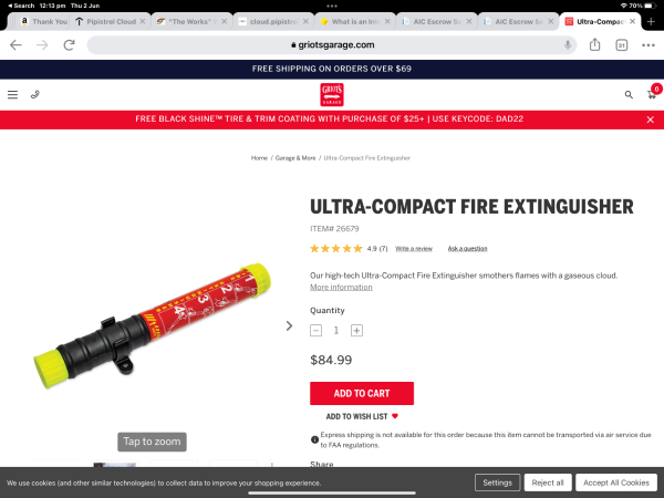

My avionics guy just showe me these. He picks up unknown aircraft regularly and has quite an emergency package with water etc and this very small extinguisher.
PRODUCT INFORMATION
The Ultra-Compact Fire Extinguisher doesn't consume oxygen but chemically bonds potassium radicals to the oxygen molecules which interrupts the chain of combustion and prohibits the oxygen from being a combustible fuel. So the extinguisher can be used in enclosed spaces such as the inside of a car without the fear of suffocating occupants. Since the unit discharges with zero thrust it will not spread oil and liquid fires under the hood, in the kitchen, shop, or anywhere else. It measures 10 1/2 inches in length, extinguishes for 50 seconds, and can be aimed and held with one hand, distancing the user from danger. The gas cloud is heavier than air so it settles on the flames, deterring propagation. The Ultra-Compact Fire Extinguisher is easy to mount or store under your seat... Get one for every car you own, your garage, and your home.
  • Informative 2
7 minutes ago, Arron25 said:
Looks good.. Do you know if there is there an Aus supplier ....or only supplied direct with $60 freight and markup via eBay. Would concider a couple for the car instead of the 2 1/2 kg dry powder I carry
I just spotted that it can’t be air shipped due to FAA regs! Try googling some of the key words like potassium radicals. I’ll ship some in a 20’ container in September with am aircraft and various bits.
