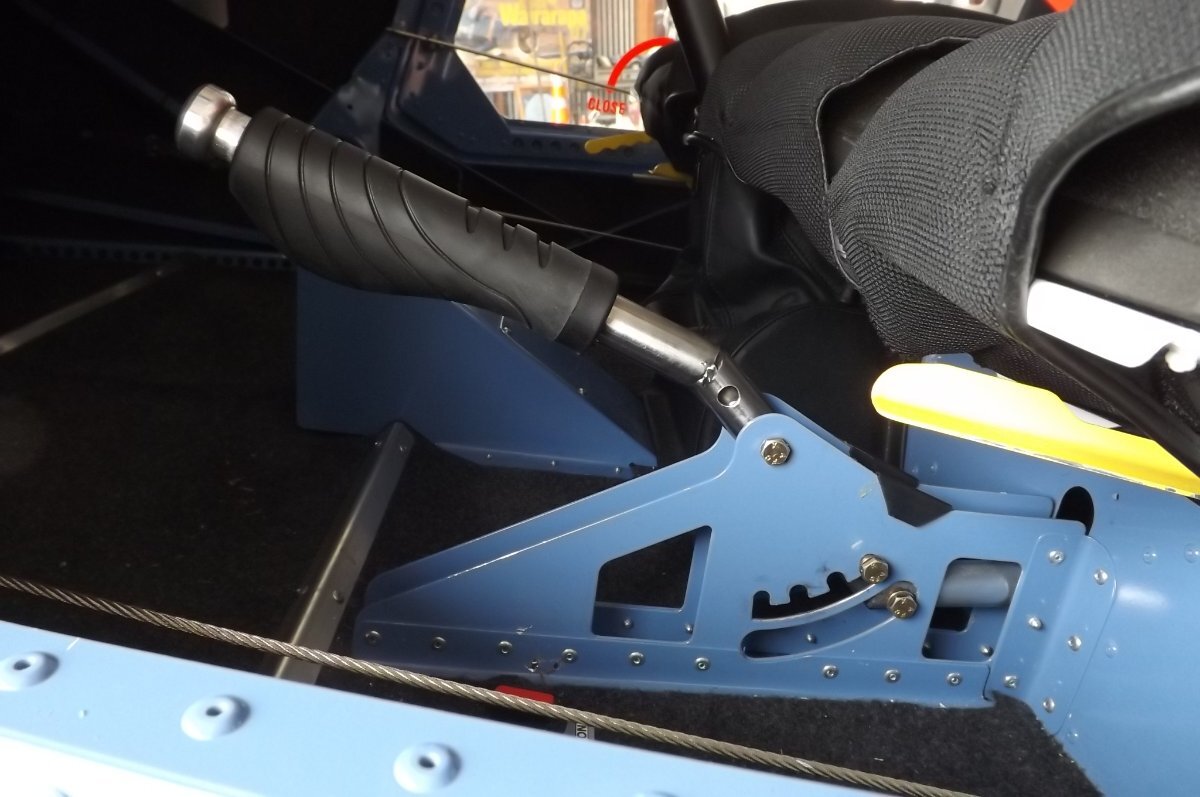

The flap handle is too close to the seat when using full flap. Also there are only 2 setting on the std savannah for flap.
I changed the geometry on mine by making a new bracket using the same parts just the angle so you can get the mechanical advantage back. I also added a extra flap position. I basically never used full flap on the sav as I think its too agressive, On mine I just mainly used the first and second stage and never used the third stage for full flap
This is the updated with extra position
  • Like 4
I bought the excellent Kyle Communications 3 position brackets (above) and fitted this:
  • Like 3
  • Winner 1
