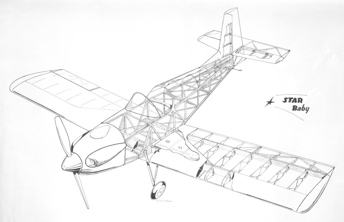

LoonyBob mentioned Corby bebe.
Me thinks the loon might have some knowledge of the Corby (and 3 others) Star Baby design (never built) which preceded the other three John Corby designs.
  • Haha 1
SSSSSSSSSSSSSSSSSSSSSSSHHHHHHHHHHHHH! Innit luverly, though...
