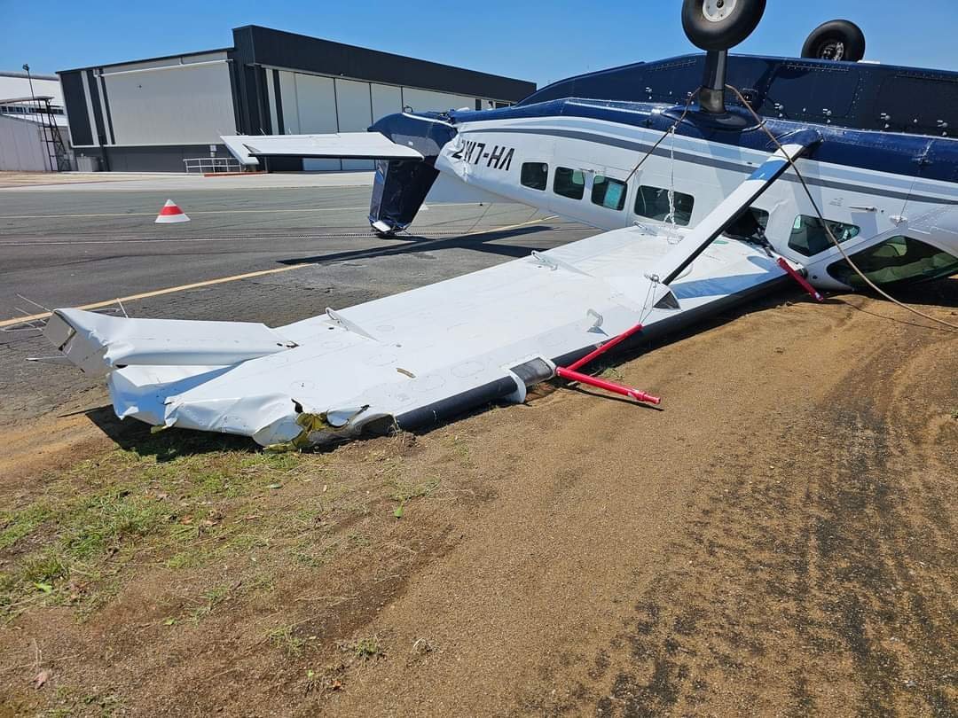

turboplanner Posted December 16, 2023 Share Posted December 16, 2023 It seems tying down your own aircraft is not enough these days. 1 Link to comment Share on other sites More sharing options...

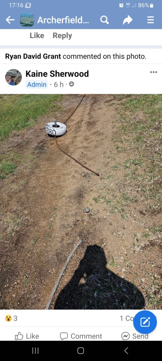

Kiwi Posted December 16, 2023 Share Posted December 16, 2023 1 hour ago, turboplanner said: It seems tying down your own aircraft is not enough these days. Cable snapped. 1 Link to comment Share on other sites More sharing options...
turboplanner Posted December 16, 2023 Share Posted December 16, 2023 1 hour ago, turboplanner said: It seems tying down your own aircraft is not enough these days. My mistake. Channel 9 footage tonight shows the top aircraft from the other side with a tie down chain still firmly attached to a wing and the ground cable ripped out. Wind speed was 169 km/hr. Link to comment Share on other sites More sharing options...

KRviator Posted December 16, 2023 Share Posted December 16, 2023 1 hour ago, Kiwi said: Cable snapped. That ain't gonna be a cheap fix. And their insurer's gonna have fun with that assigning liability to the airport for failing to ensure the tiedowns were adequately maintained! 1 Link to comment Share on other sites More sharing options...
Jerry_Atrick Posted December 16, 2023 Share Posted December 16, 2023 Is the airfield liable for the cables? The two airfields I have had parking at provided the tiedown points/blocks, but it was up toi us to provide the cables.. Link to comment Share on other sites More sharing options...
Litespeed Posted December 16, 2023 Share Posted December 16, 2023 Those two small Cessna's look like they had a wild party, got on the sauce and drugs and woke up bruised and in a compromising position. How else do aircraft breed? 1 Link to comment Share on other sites More sharing options...

KRviator Posted December 16, 2023 Share Posted December 16, 2023 11 hours ago, Jerry_Atrick said: Is the airfield liable for the cables? The two airfields I have had parking at provided the tiedown points/blocks, but it was up toi us to provide the cables.. The cable that's snapped looks to be part of the airport infrastructure, I can't imagine it being a users responsibility to provide the heavy steel cable that let go. Certainly though, it's the aircraft owners responsibility to provide the tackle to lash the aircraft to that heavy steel cable. 2 Link to comment Share on other sites More sharing options...
derekliston Posted December 16, 2023 Share Posted December 16, 2023 That makes me wonder whether, if the airfield operators are deemed responsible for the cable breaking, they will completely remove the cables and leave the responsibility to owners to use ground screws or whatever for their tie downs? Link to comment Share on other sites More sharing options...
