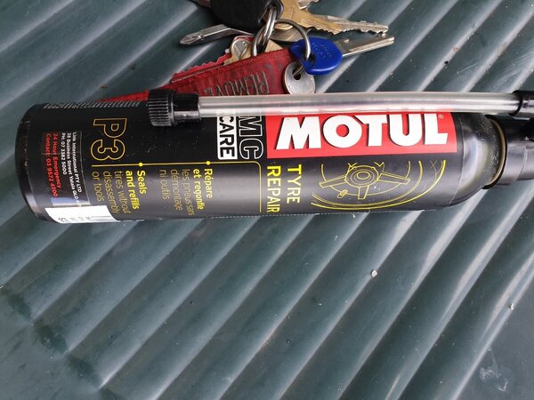

Blueadventures Posted April 22 Posted April 22 (edited) 5 hours ago, rhtrudder said: Thoughts on using anti puncture goo in aircraft tyres, planning on some trips away , don’t need flats, anyone tried this I am set up to fix flat tyres when flying solo; so have a jack (0.5kg by Peter Anson Engineering), two bottles of repair foam for tubed tyres (0.3kg each), two tubes, tube repair kit, spare valves and removal tool and the necessary tools to remove wheel and disassemble the wheel; and a pump. Mine is split rims and easy to get apart. I've been involved with Savannah tyre changes and re tubing and there are a problem to get tyre bead off the rim, real hard and near impossible. I say be able to do solo as you need to get wheel off the ground and a rock under the leg if you don't have a jack or a support. The P3 is great for a quick fix, get you going and about $26 a can. Edited April 22 by Blueadventures 1 3
Freizeitpilot Posted April 22 Posted April 22 Just curious - does the P3 have a flammable propellant and the can have a temperature limit stated on it at all ? 1

Blueadventures Posted April 23 Posted April 23 22 hours ago, Freizeitpilot said: Just curious - does the P3 have a flammable propellant and the can have a temperature limit stated on it at all ? It contains a flammable propellant; there is a safety data sheet for it. It works very well I'm told by a reliable person who has used two cans on at least two occasions as he fly's a Nynja at an airfield that has thorns in the grass. 1

skippydiesel Posted April 24 Posted April 24 15 hours ago, Blueadventures said: I have detailed my knowledge of the P3 product in the earlier post and in the other thread. It would be helpful to all if you could update your post with the product brand detail of what you used. You have omitted this information. Yes , you wrote about the product, all the tools you have and some tips on wheel/tyre removal but did not mention any actual experince of the product mentioned/shown. Experience is all important. Without it you are just echoing marketing & third hand myths, which does little to inform the Forum readers😈 1
Blueadventures Posted April 24 Posted April 24 39 minutes ago, skippydiesel said: Yes , you wrote about the product, all the tools you have and some tips on wheel/tyre removal but did not mention any actual experince of the product mentioned/shown. Experience is all important. Without it you are just echoing marketing & third hand myths, which does little to inform the Forum readers😈 Skip; I've shared what I know, Your detail is piss poor as you don't bother to share the brand you used with success. You often do this when you push for detail off myself and others, you need to lift your game or exit. As for your comments running down my information you can keep your opinion to yourself. For others I can assure them that the information is as good as top shelf RD testing by an approved authority, and I'll back in the effectiveness of the Motul P3 product for flat tubed tyres. 1 1
skippydiesel Posted April 24 Posted April 24 So Blue - I take it from your "forceful" response - no experince. I am NOT "running down" your information. I am rightly seeking first hand experince. "You often do this when you push for detail off myself and others" I think you will find that I ALWAYS give as full an account of my experince as I can - Am upfront when speculating or passing on others comment/information, that I don't have personal experince of. As my experince was not directly related to aviation, I did not think to include the brand.- it came from Repco - cant remember for sure - think it may have been the Holts product (pictured). The bloke behind the counter reckoned it was a good one. I stress - I used this on a 4x4 tyre - not an aircraft. The multiple holes were very small, deflation rate estimated on 5psi/day - no idea what caused the problem. I also stress - being a land based vehicle, I was able to follow the, after use, instructions, to drive for a distance (?) at, I think, at 60 mph - this is likly not practical in an aircraft. I also had to supplement the pressure delivered by the can, with added inflation to correct psi.
