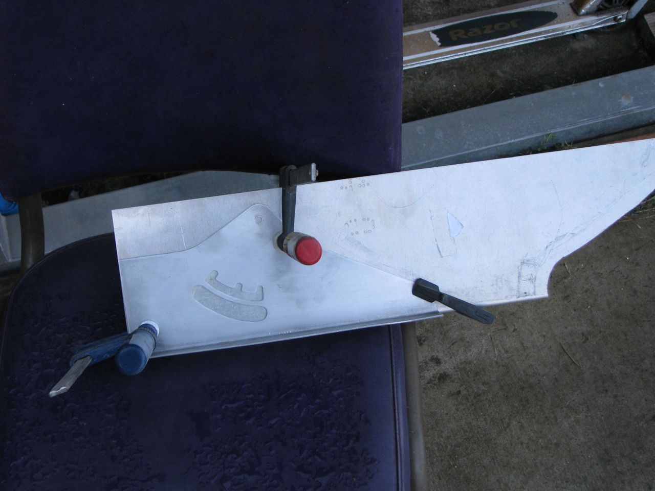

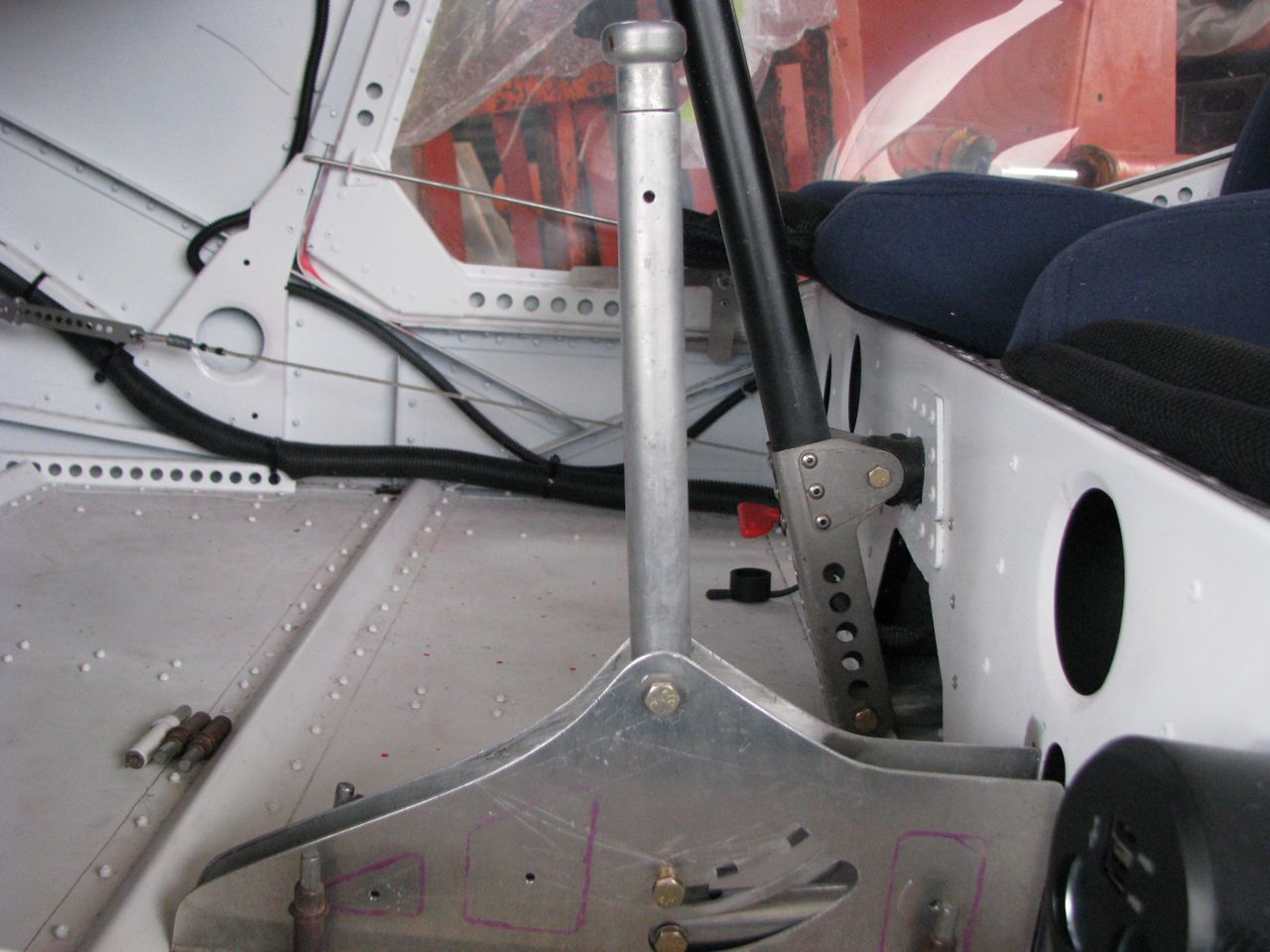

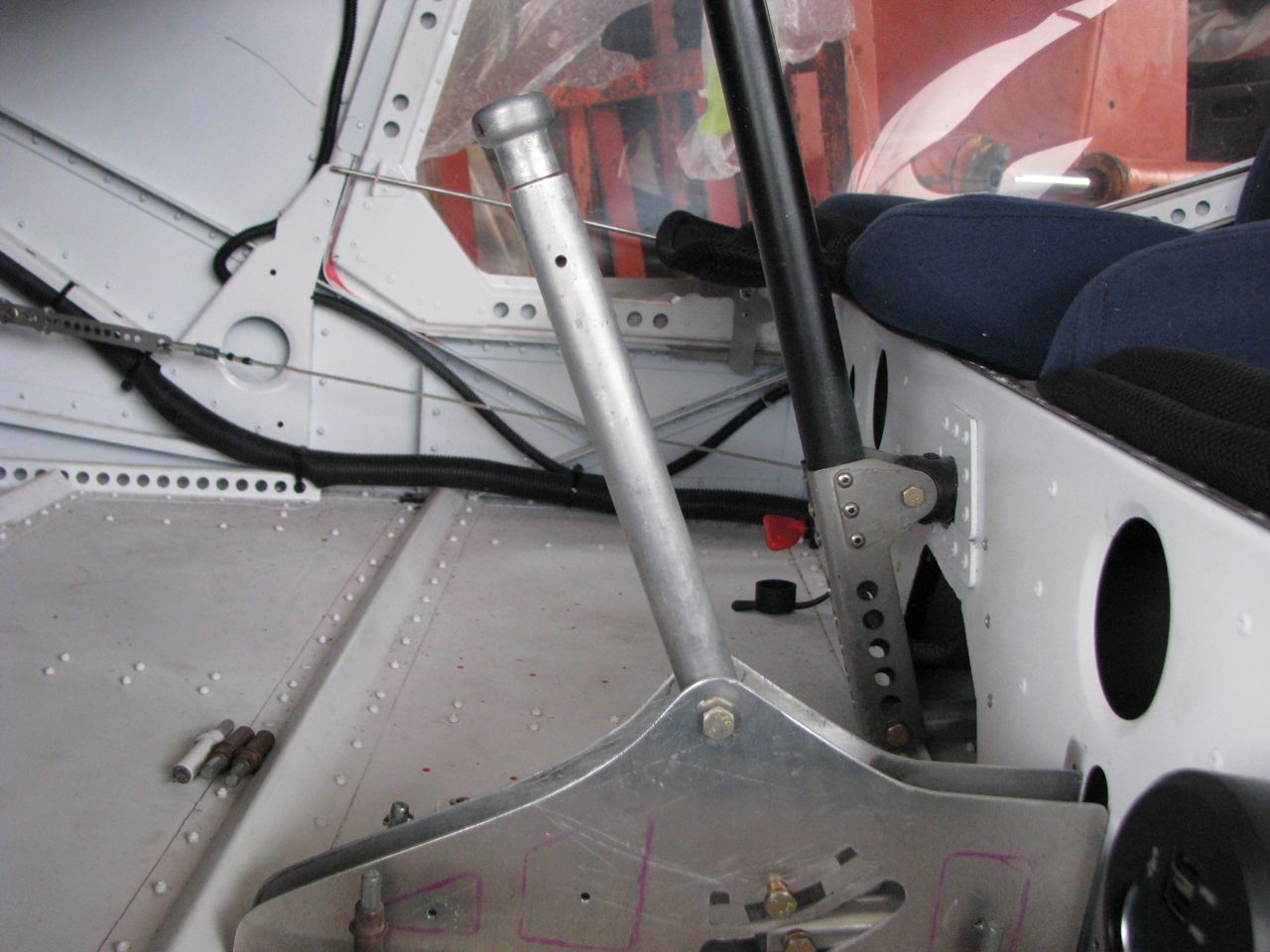

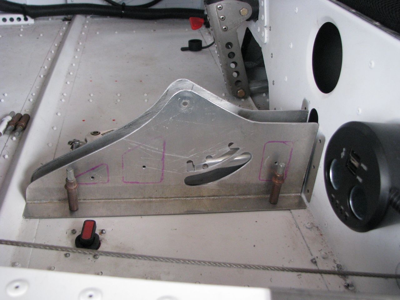

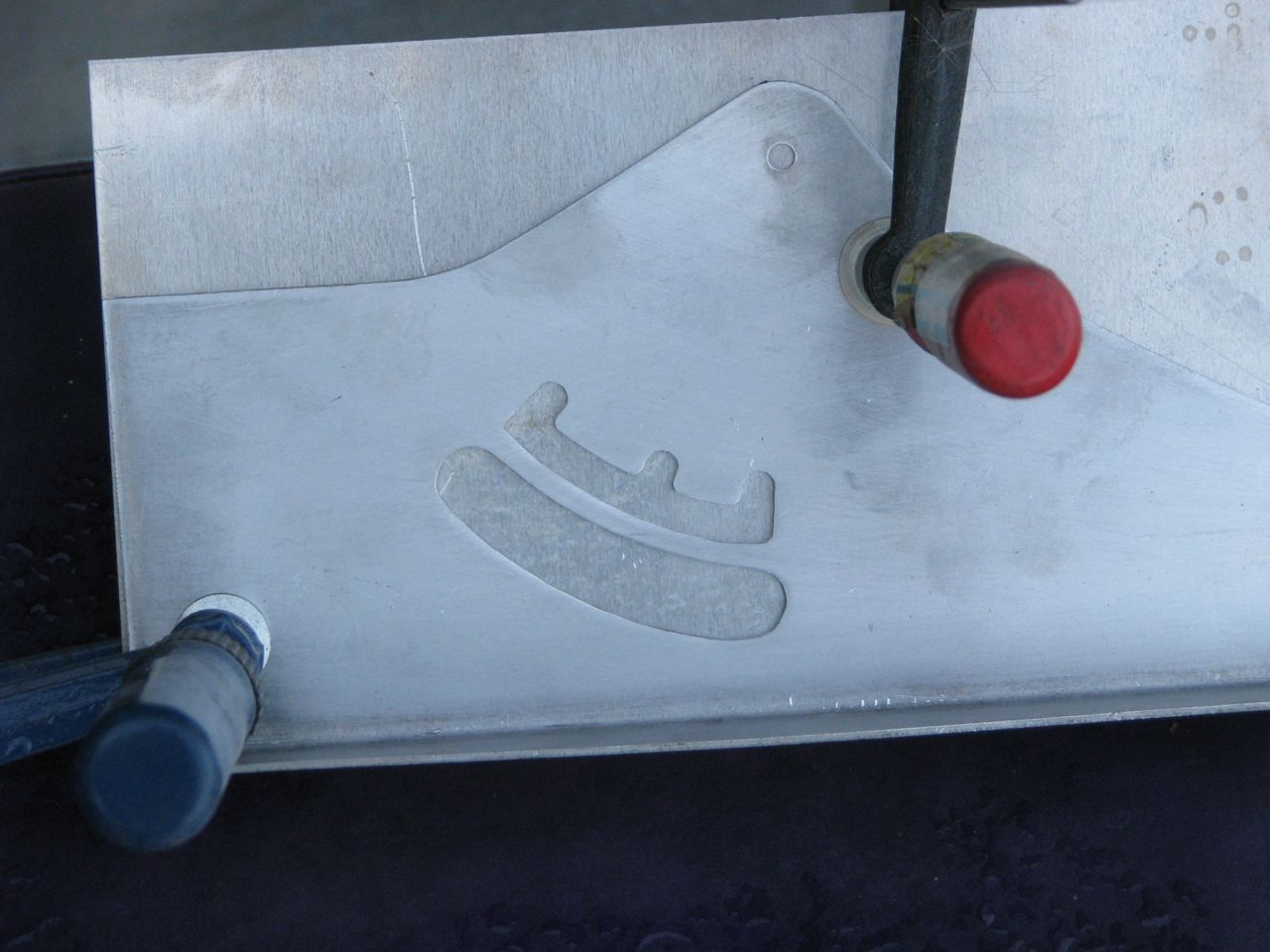

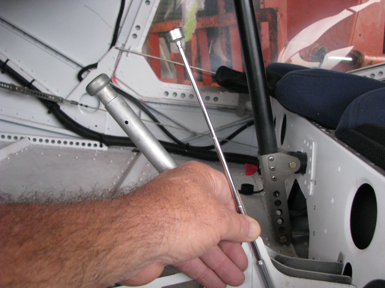

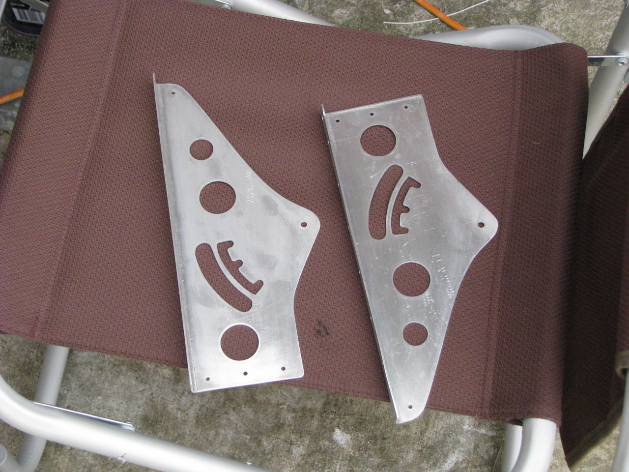

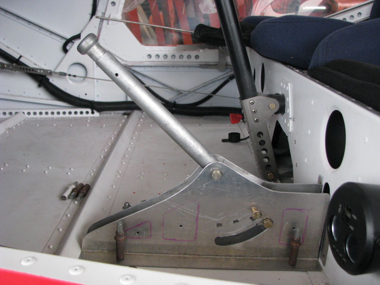

Kyle Communications Posted March 4, 2012 Author Share Posted March 4, 2012 Hi All The new flap actuator has worked out pretty well. I made the 2 side plates and did a mirror copy of each and added some lightening holes it was easier to do round ones than the cnc cutout ones. Spent quite a lot of time getting them very accurate. I am happy with the result I have sat in the plane with the new positions and its perfect I reckon. When the flaps are away I don't have to lean forward to get the handle its a nice full arm stretch and in the full flap position its pretty good as well and of course it will be at max mechanical advantage not like now where it is over centre and hard to use for myself. The pictures show the progression and also the trial fit up you will see the series of pics from no flap to first stage then last stage also you will see with the telescoping magnet the original position with it compared to the new position of no flap and full flap Just have to sand them a bit more and then etch the brackets and paint them and refit the whole assembly. One thing I did find the very thin rear brackets that hold the side frames to the cross member one had a small split in the corner so might be an idea to check yours in a aircraft that has a few hours on it. I have replaced these 2 brackets with right angle aluminium its far stronger than the original and will be far better Mark Link to comment Share on other sites More sharing options...
ave8rr Posted March 4, 2012 Share Posted March 4, 2012 G'day Mark. Looks like you have achieved what you want in repositioning the flap lever. The factory may even take you up on the modification drawings! Glad to hear that the flying is going well. You mention "Bill" as the isntructor, is he from a Caboolture Flying School? You also mentioned doing the test out west so I gather Bill does not have Examiner approvals. Good luck with the training / test. and looking forward to hearing of the first flight of your aircraft. I hope you have got some hangarage sorted. Cheers Link to comment Share on other sites More sharing options...
Kyle Communications Posted March 4, 2012 Author Share Posted March 4, 2012 Hi Mike Just finished painting the brackets so should install it all back in this week I won't really know the difference until mine flys but I am positive it will be a lot better than the standard one. I am learning with Bill Grieve from Aeroskil he has the exact same version Sav that I am building but of course its a factory built he can run his school from his place but until he becomes a senior instructor the test is done by his CFI Kevin Walters. Kevin is a very highly respected instructor and a great pilot being an old ag pilot. If he says I am ok to go then all will be ok ....Its over at his airfield near Atkinsons Dam which I have never flown to or at so will go over there in the next week or so and shoot some circuits to become familiar with the place and also to meet him and have a chat may even take him up and get some advice from him on what I need to practice on. Will take some pics once all the brackets are back in and the flap handle is painted. Just waiting for the wings to harden up and when I can get a hand will put it in the rack with the other one then I can finish painting all the other parts and its time to put her all together for the first time. Got a few irons in the fire regarding the hangar so just have to wait for news on that. I still have plenty of work to do yet anyway before she goes over to the hangar Mark Link to comment Share on other sites More sharing options...
bobcharl Posted March 4, 2012 Share Posted March 4, 2012 Mark, The flap lever mod looks just great. Looks as though it will have some ergonomic advantage as well with more pull in line with the arm than the more backward movement in the original, as well as giving you more space. Good to hear you are getting a big buzz out of you conversion training. Congrats on being solo; nothing quite like it is there? Bob Link to comment Share on other sites More sharing options...
