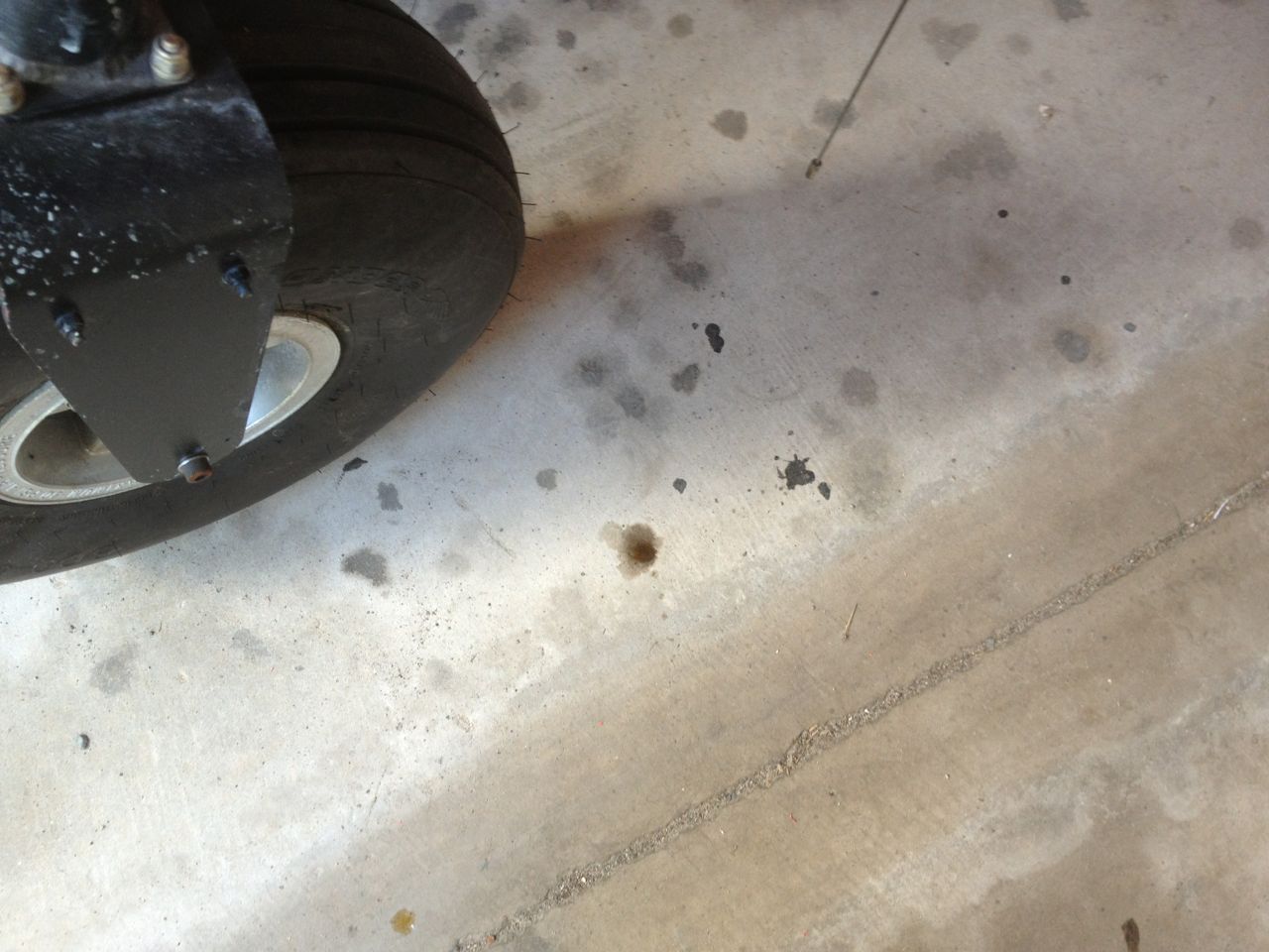

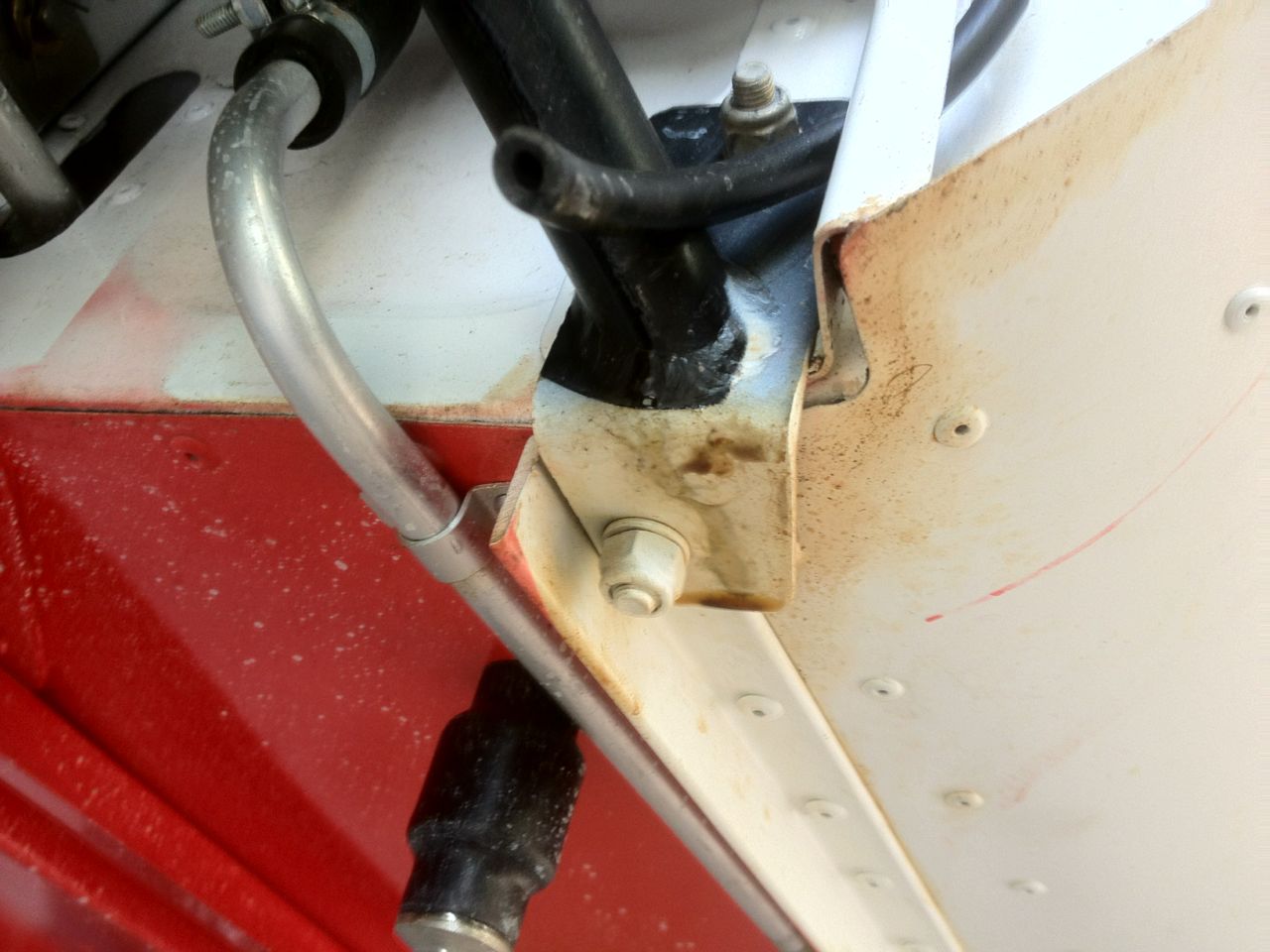

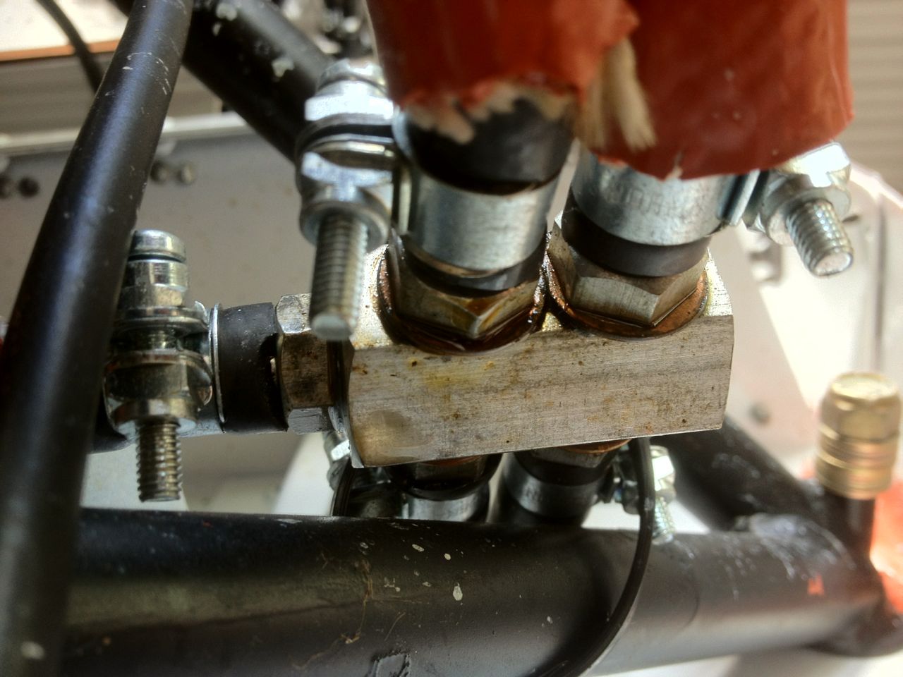

Kyle Communications Posted May 30, 2012 Author Share Posted May 30, 2012 I am baaaaack Well first issue reared its head today. I parked the Sav late sunday afternoon and have not been there since then. Got to the hangar at around 1.30pm today to do the further repositioning of the joystick for pitch and to redo the trim ready for the next flight as the weather has been windy here and a few showers and looks a lot like further crap until early next week when I can hit the sky again. I opened up the doors and nearly got knocked over by fuel smell. I have sealed the wing holes so it wouldn't be coming from there so looked at all my fuel pipes and my fuel switch and all looked fine, I looked at the floor for some reason and saw a brown stain coming down the floor at the corner edge followed it and its right at the firewall so had to be coming from the engine bay. I took the top cowl off and was looking for where it would come from initially I though the filter must be leaking but then I saw a small drop on the concrete directly under the cowl so got underneath and could see a dribble line coming from the underside of the black engine mount so I dropped off the bottom cowl and followed it the leak was coming from the 4way fuel splitter block so thought a hose must have been loose but it wasn't it was actually leaking out of where one carby line comes off right at the joint between the alu fitting and the alu block. It hadn't been sealed properly at the factory. This is when I noticed the larger pool on the floor where it had been running down the underside of the fuselage. Have cleaned the inside of the cabin and outside as well but will need to do some paint tough up as the fuel have softened some paint. Lucky I didn't have carpet on the floor otherwise it would have been very had to find this issue . This has come about because I have kept all the fuel off while it had been in the aircraft while finishing it. I have left my wing selector with both inner tanks on as most normally do and the pressure from the tanks in the wings keep the fuel up at the carbys so for the last 3 days there has been a pressure there and this has exposed the leak This could have caused a fire in flight too so very lucky to have found it so quickly. I have fixed it tonight by bringing the block home and taking out the stub fitting and cleaning it all reversing the copper washer then putting thread sealer into the thread and doing it up properly. It must have not been home fully originally. I checked the other 4 fittings and found another one a little loose as well...not loose but half a turn with a spanner loose. Some pics attached showing the block with the small gap and also a after shot when I had finished I am confident it won't leak now but will put it back in tomorrow and check again on the weekend with the tanks on again. Mark Link to comment Share on other sites More sharing options...
av8vfr Posted May 30, 2012 Share Posted May 30, 2012 Hi Mark, not sure about the Sav fuel block, but if it is Aluminium with copper washers the electrolysis factor is way high...remember copper clamps on Alu overheads... Just looks that way.. Matt Link to comment Share on other sites More sharing options...
rankamateur Posted May 30, 2012 Share Posted May 30, 2012 http://www.recreationalflying.com/attachments/img_1649_1-jpg.17679/ The outlet above your thumb looks crooked, are you sure it isn't cross threaded, that might make it leak. Link to comment Share on other sites More sharing options...
gareth lacey Posted May 30, 2012 Share Posted May 30, 2012 good one mark. great to see you fly your own plane a great achievement plane looks very professional built top marks!! will drop by to pick up the clecos next week. cheers gareth Link to comment Share on other sites More sharing options...
Kyle Communications Posted May 30, 2012 Author Share Posted May 30, 2012 Yes when I removed the block today the one that was leaking did look a little crooked.....its now straight and tight. I am not sure how I missed it when I installed it but it is fixed now and yes I did think about the copper and alu issue but all Savs are the same and don't seem to have any issue with the electrolysis. I should be around gareth just ring first. Got my Zulu headset today so setup the bluetooth so I can go flying and still answer the phone...I used the Zulu's in Bills plane while training they are very impressive then again for a thousand bucks they would want to be Mark Link to comment Share on other sites More sharing options...
