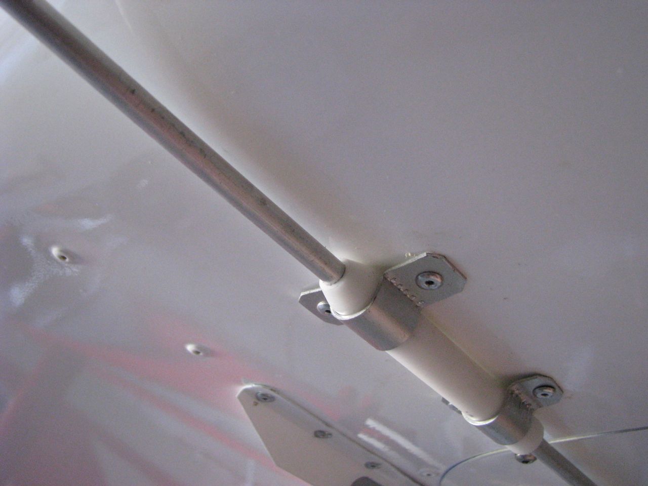

Ok back out to the Sav I am fitting the jury struts at the moment...for small pieces there is a lot of sweat and swearing going on

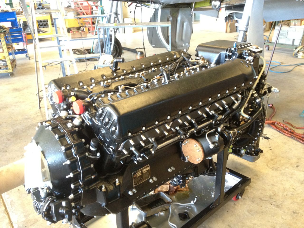

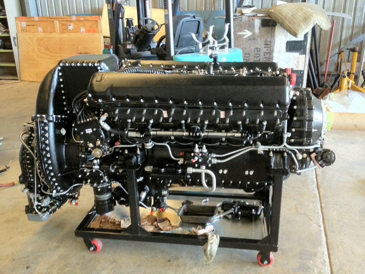

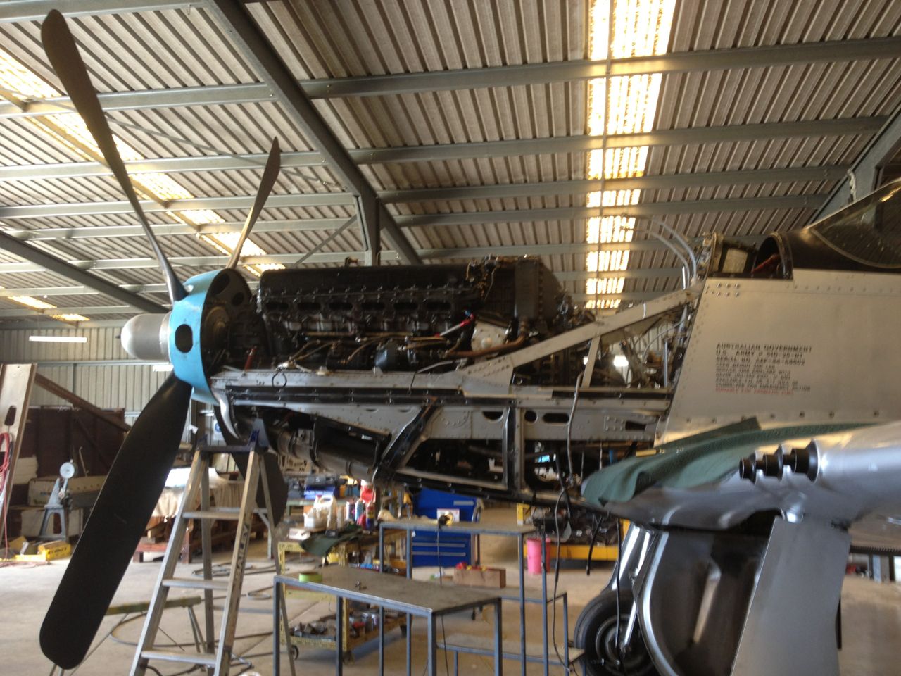

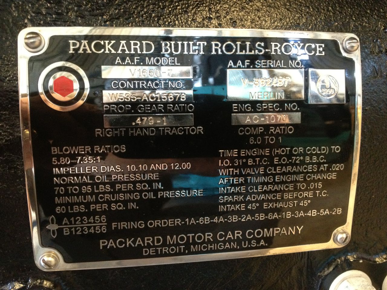

Found the new engine for my Savannah 008_roflmao.gif.692a1fa1bc264885482c2a384583e343.gif
I was a YCAB today picking up a job to do and of course while there having a chat to people I know and on the way back got to Sandora where "speedy" was working painting a beautifully restored Gypsy and of course its where the local Mustang hangs out. I went around the front looking at the Gypsy and lo and behold here was this beautiful new Merlin sitting beside the Stang. Apparently the stang engine has only an hour or two left on it and this is the replacement
Its off topic but thought I would share a beautiful sight
Mark

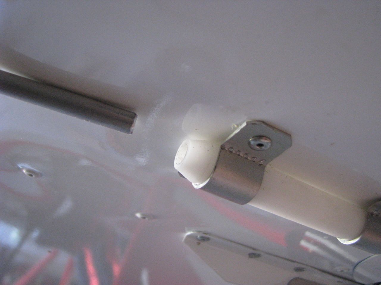

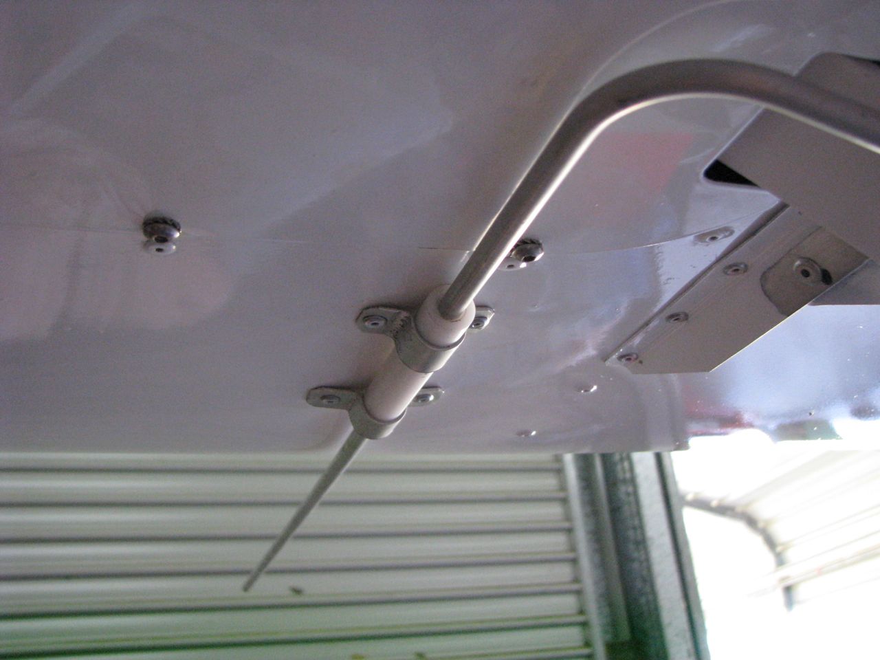

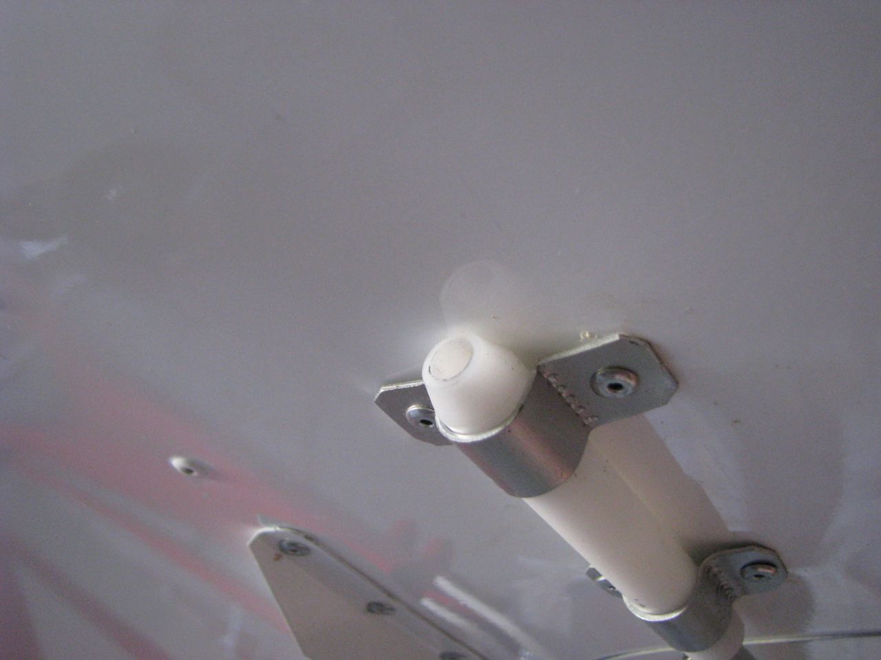

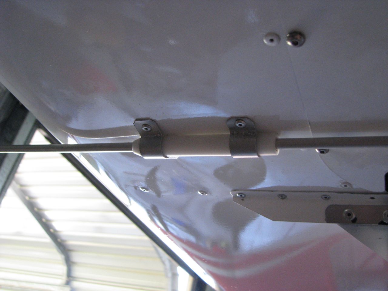

Been quiet on here but been working away doing all the small finishing jobs. Although been away up at the farm for all of easter came back early today to beat the traffic. The only thing I have to show you that is new is the pitot tube mod I have done. The pitot is a real eye poker it sticks out and it just the right height to take out an eye. Some guys have made them removable with a silicone tube arrangement but the pitot is quite flimsy and doesn't feel right. I turned down some teflon rod I had here and drilled it through at 6mm. The alu pitot tube supplied is 1/4 inch which is 6.25mm. I measured it off to where I wanted to fit the connector unit and cut the alu tube. The right angle end of the tube that connects to the plastic tube going to the instruments is pushed into the 6mm hole end about 25mm this is nice and firm enough so it can be removed if necessary the other 70mm of the teflon tube has been drilled to 6.25 mm to a depth of 60mm which allows the tube to slip in just nicely with a slightly loose fit then it pushes firmly into the last 10mm that seals it off so it will be a complete airtight joiner. In the unlikely event the pitot gets lost or broken off I am sure the airspeed indicator may still work reasonably well as where it is is back a distance from the leading edge and I have tapered the front of it. So one day I may try it with it out and see how it performs but I am really happy with the fit of it all and how sturdy the removable pitot tube is.
I have a few more things to do on the plane then later this week I will take the wings off and start to move the Sav up to the hangar. Will get some more pics posted when we do that

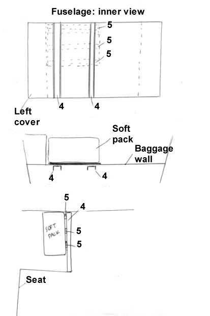

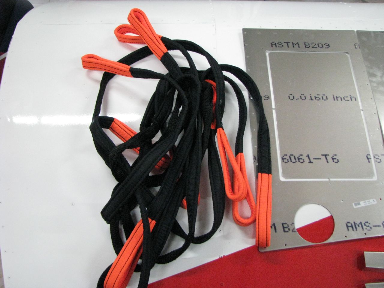

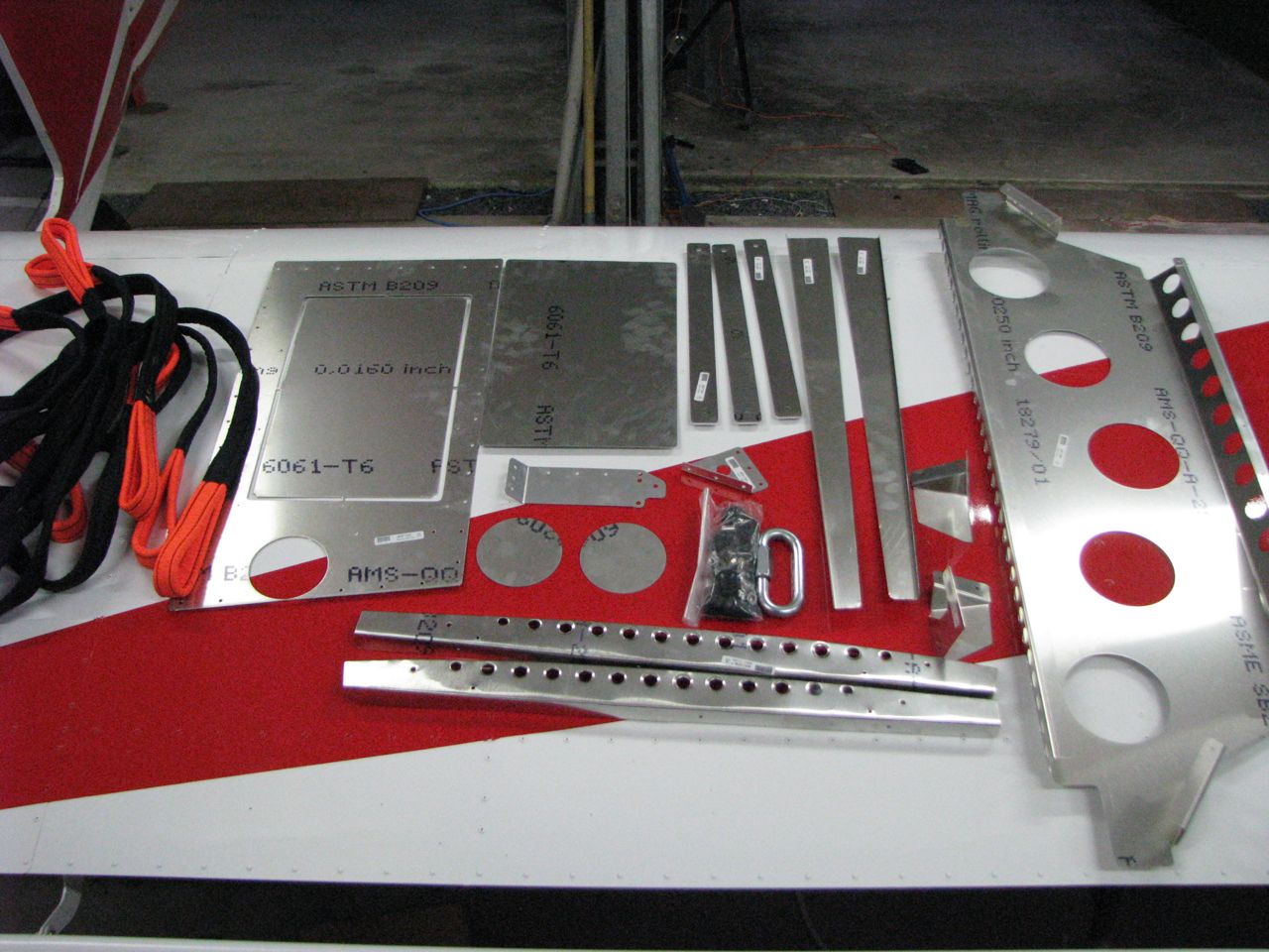

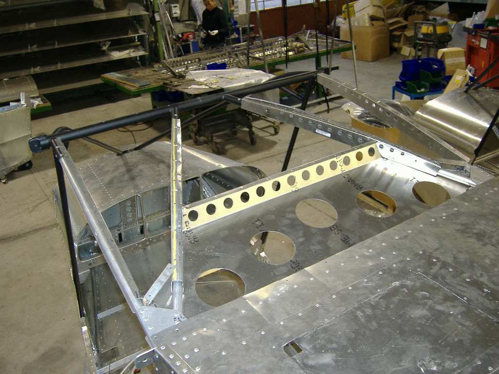

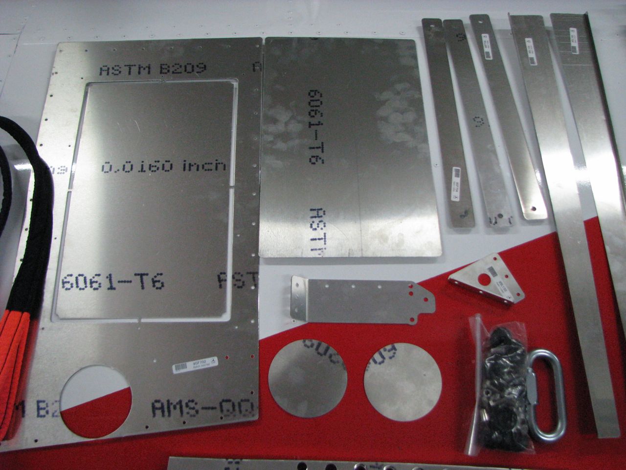

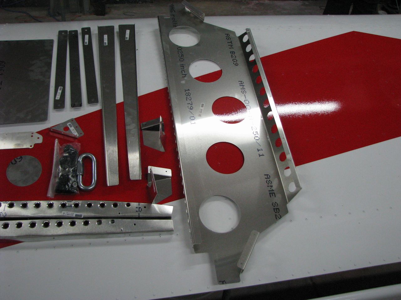

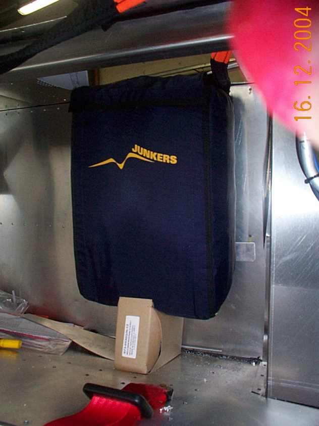

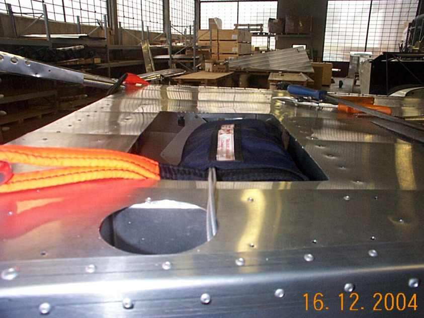

Well I was hoping to get the Sav to the hangar last weekend but it didn't happen. Just before easter I got finally a kit of parts for the ballistic chute install on its way from italy it has been a saga almost as big as star wars. Anyway I got them to freight the parts on my TNT account and low and behold it arrived here the tuesday after easter not bad considering they left Italy on the previous Thursday. Opened up the box and saw these nice straps and some alu parts but something was missing.....bugger the actual parts I really needed were missing so got onto ICP and they immediately sent the missing parts they arrived here yesterday which again was outstanding considering they sent them by UPS. The pics show all the parts required. I really only wanted the tray section the straps and carabina and the 2 aerosfoil shaped pieces that go on the outside of the side roof struts. This way I can get all the roof parts in and the straps into the tray and the roof lexan riveted down and I will not have to open the roof section up when I get the actual parachute from magnum. I have included a couple of pics from the install manual that sort of show where the parts go.
The rectangle parts go on top of the fuselage I will install all those later when the chute comes.
ICP did inform me they do not recommend that you fit the chute when you have the extended baggage area but the only reason for this is the actual weight of the chute and the mounting rails that you install. I am pretty sure that really isn't a issue for me and I can install the rails in a manner that will be plenty strong enough to hold the 11kg for the chute onto the rails. I will take some more photos this week of the strap and roof install. I etched the parts this morning and painted them this afternoon and have temp fitted the tray tonight I will rivet the tray and the 2 side aerofoils tomorrow fit the straps then the roof can be riveted down with the hope that I will shift the Sav to the hangar this weekend.

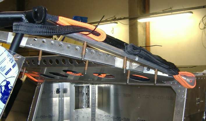

But... with the extended luggage installation, will the installation be strong enough for the chute to carry the aeroplane, the pilot, the passenger, the fuel weight and the baggage weight?In other words, does the extended luggage option require a stronger chute mounting system??
The extended baggage area rear wall is further back by about 400mm this of course is too far back for CG requirements. You can still mount the rails that hold the chute in the position it would normally be in the baggage area they only difference is the rails will only be mounted at the top and bottom there would be no alu sheet the rails are mounted on as well. The only function really is that the rails can hold the weight of the chute NOT the weight of the aircraft. The chute attaches to the 4 points at the top of the cabin frame. When the rocket goes out it pulls a pull out sheet on top of the fuselage then the chute comes out of the pack that is mounted on the wall and the leader for the chute then pulls off the top lexan sheet above the cabin....there is no structural requirement for the actual baggage compartment rear wall...its only got to e strong enough to carry the weight of the parachute pack
1499694598_S0215installazioneparacaduteJ500suSavannahXLcabinattachment.jpg.9ecff4c8af1ac6d7ea432acb6de93dc5.jpg
1545927917_S0215installazioneparacaduteJ500suSavannahXLtop.jpg.8e79fea4271d755ad22f2b4b0bac4072.jpg
1101792041_S0215installazioneparacaduteJ500suSavannahXLrearwall.thumb.jpg.e3fa7cc4a5b04b7e41e32ed8d919e602.jpg
1458279253_S0215installazioneparacaduteJ500suSavannahXLrev.01-2.jpg.29ca262530078f83d1a480da44300d96.jpg

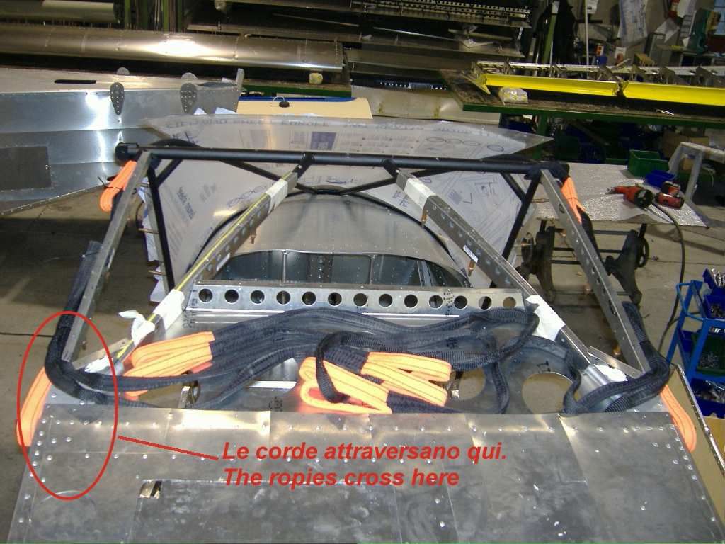

The the first picture where the loop on the left is not tight already is a failure waiting to happen! A dynamic load on a rope or tape... through a bight like that is bad BAD voodoo 068_angry.gif.cc43c1d4bb0cee77bfbafb87fd434239.gif the one one the right is not better..
There is not a instant full load on a ballistic chute like what you are talking about. Every chute has a graduated release so when the rocket goes off and out the chute is pulled from its pack before the chute expands it has a runner that goes up the strings to allow the chute and of course the load (the aircraft) to not have a instant quick load applied...well this is the theory and of all the research I have done and the videos I have watched this is how they operate. If the situation ever arrises that I need to deploy the chute I think I would rather the my chances with the chute and the way it attaches than not having one. The chute is not to save the plane its to save whats inside....there are 4 separate straps if one breaks then the plane comes down at a weird angle...doesnt matter the chute is on a single feeder so it doesn't matter so long as 1 of those straps is still attached to the frame then you are alive
When the chute snaps open, it is a dynamic load. The runner is there to help the chute open, not reduce load.
Having said that you are no doubt correct and having four points of attachment is good, and looking at the tape used across 4 points it would be sufficient...
It is sub-optimal. You will not get each strap taking the load at exactly the same time. Please excuse my incredulousness... but no one should EVER design a system where you have tape running over tape or rope running over rope or loose knots pulling tight when the scheisse hits the prop.
I don't have a chute in my aircraft so temper my current 'expertise' accordingly baby.gif.168ad10e40c5845c810810951ae4106c.gif You are far better of than I regardless of my observations 069_boring.gif.9cee54db3616ee9ac1231638d365dc2c.gif
The chute is being fitted at the request of my mrs...and its not for structural failure at all ....the aircraft is very strong it is for when flying into crowded aerodromes just incase someone hits you or takes a wing off etc....its like Pitt St in Sydney traffic sometimes at Caboolture on the weekends or when just general flying someone not flying at the wrong height etc.....I think for 5000 bucks its good insurance...the mrs wanted it so it has to be done if you know what I mean. Even just in my flying training I have had at least 1 close call with a dark grey sportstar coming from redcliffe through the entry to downwind at YCAB...no radio call and at the wrong height...even after taking evasive action he didn't seem to have seen us.....Redcliffe has changed to a different frequency to the area here now even though they use the same training areas...so guess what...they forget to change to our freq and no one hears them or their intentions so you need to really keep your eyes peeled now
